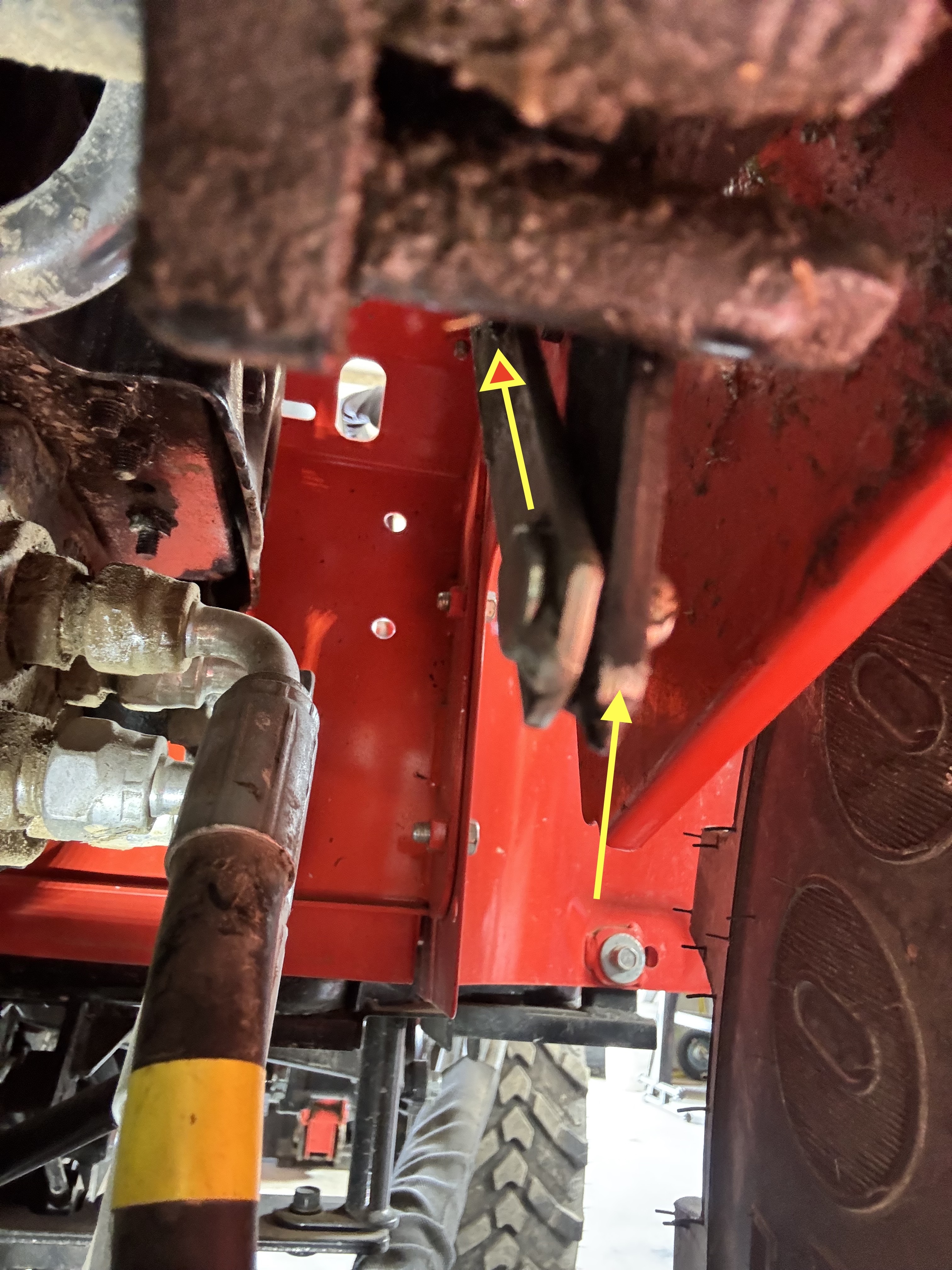

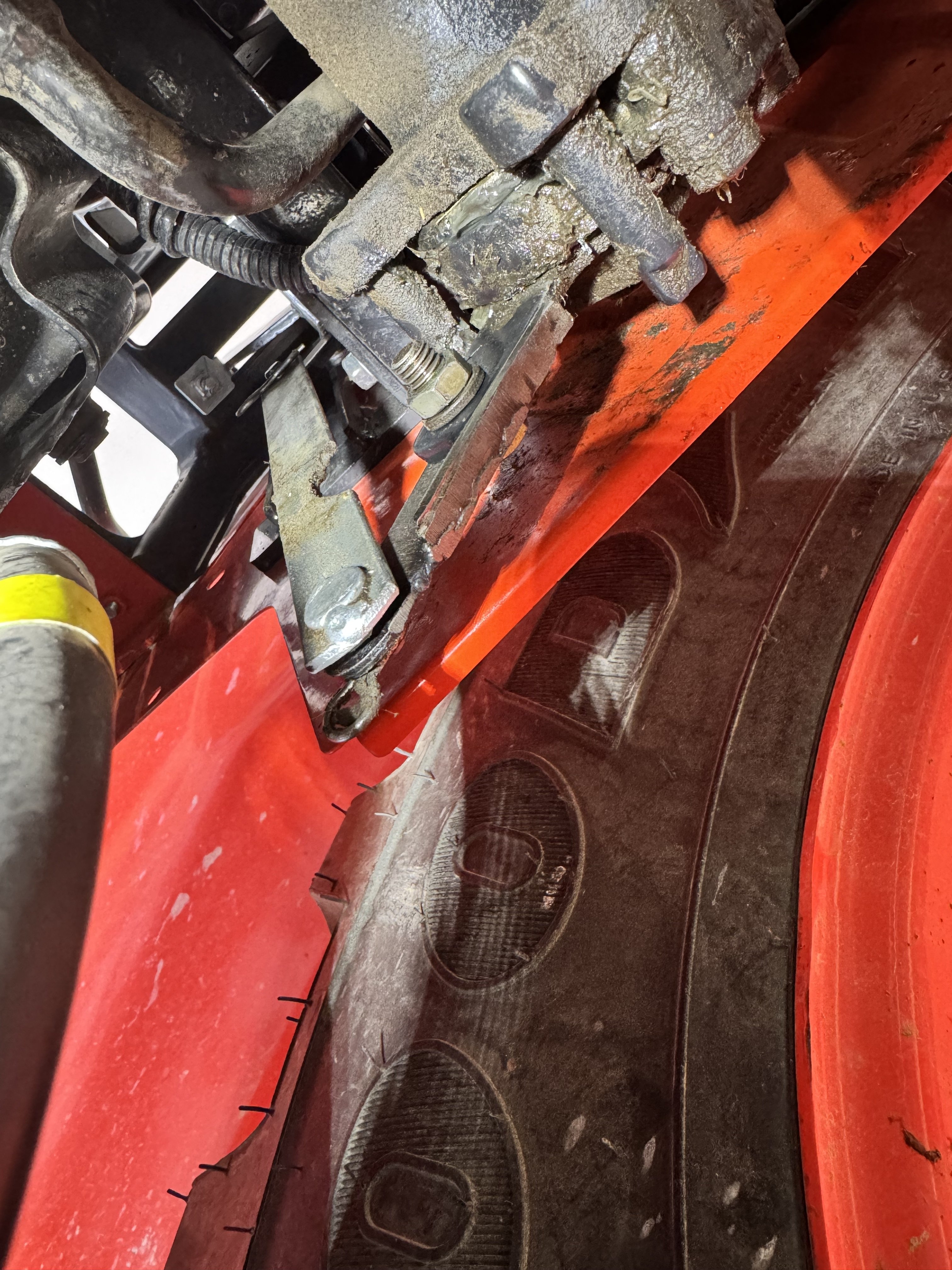

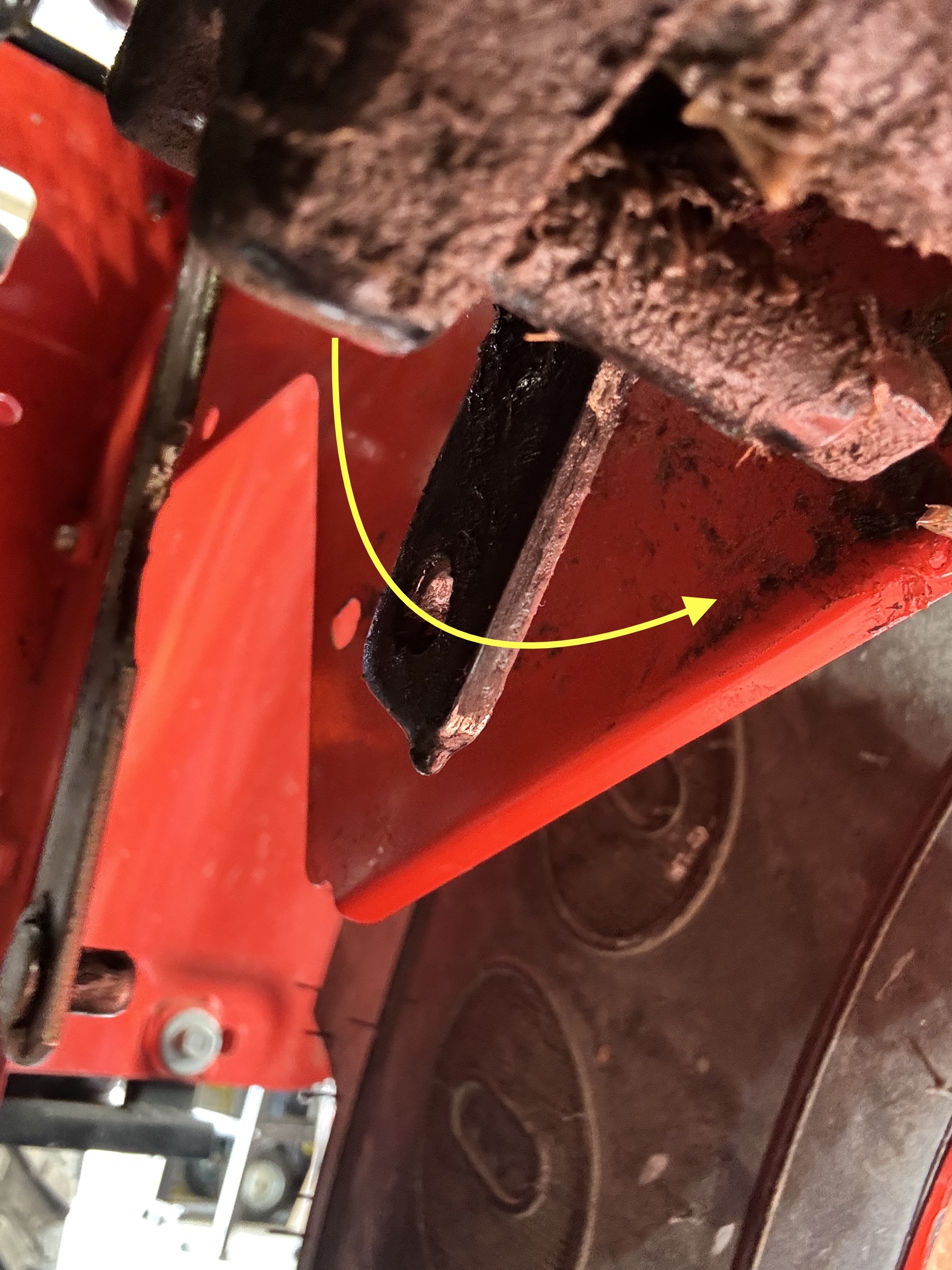

I found time to look at the 3 point linkage today and decided on a course of action...
The red-tipped arrow is the linkage between the position control and the hydraulic actuator... the yellow arrow is part of the actuator...
This is the actuator with the linkage disconnected... I put the position control just below the point where the lift arms began to move... about half-way through the rotational travel of the actuator... then disconnected the linkage...

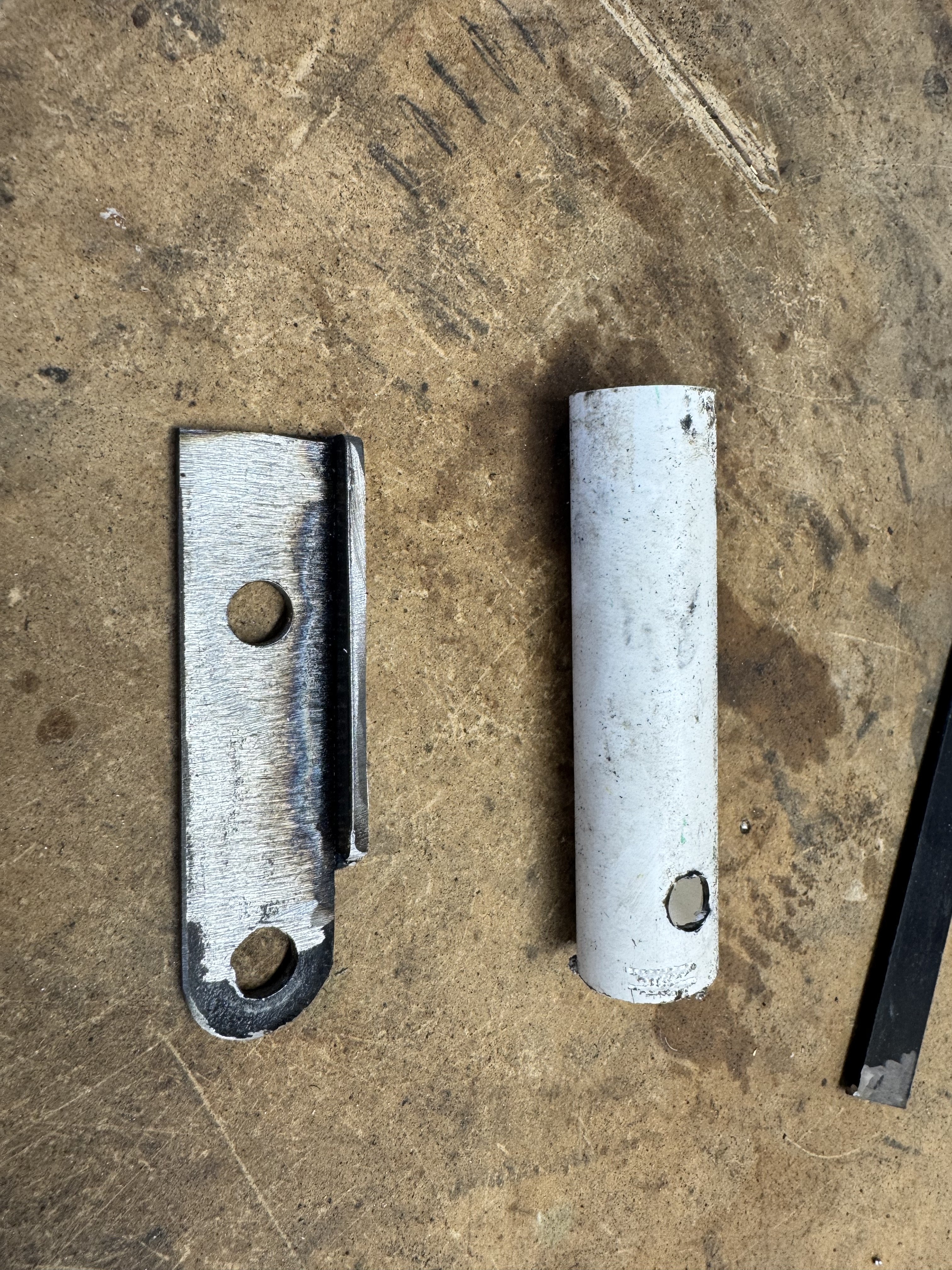

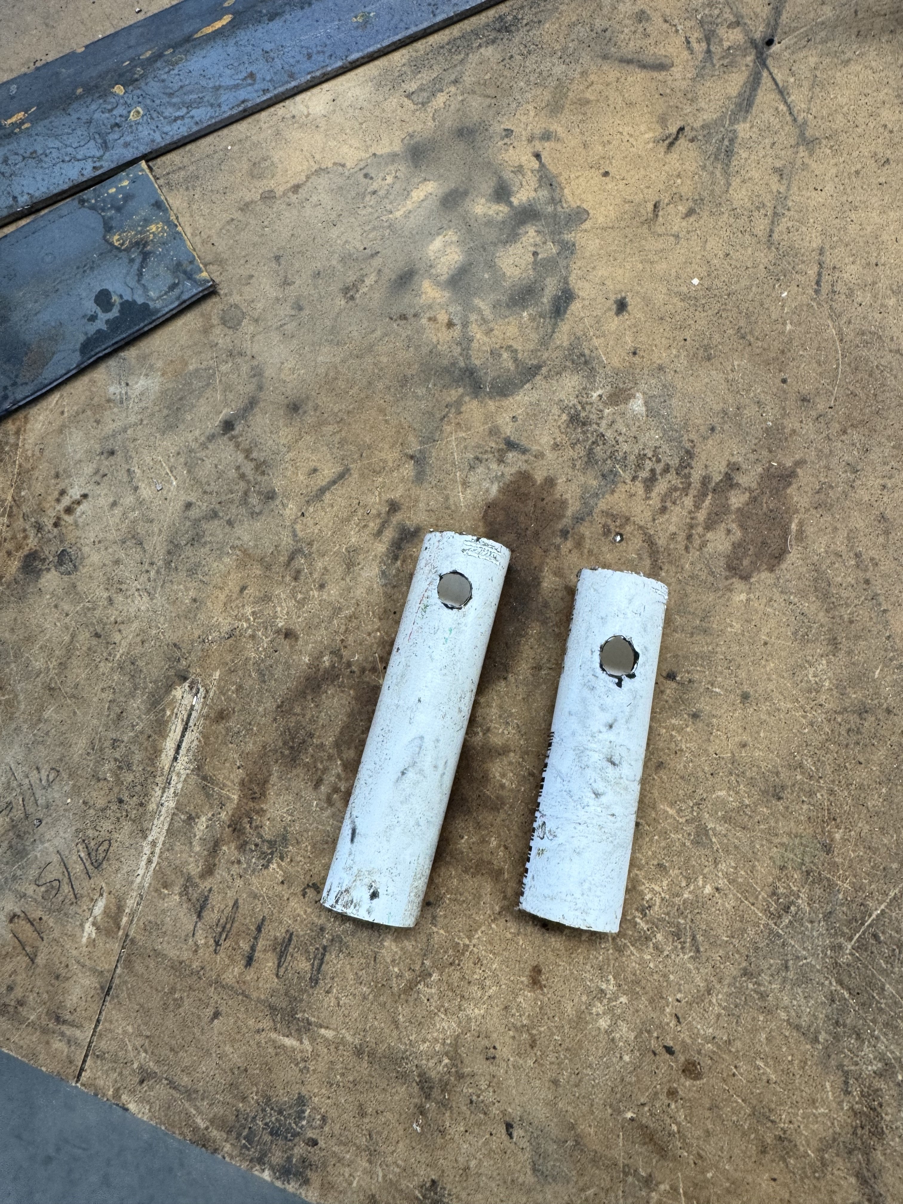

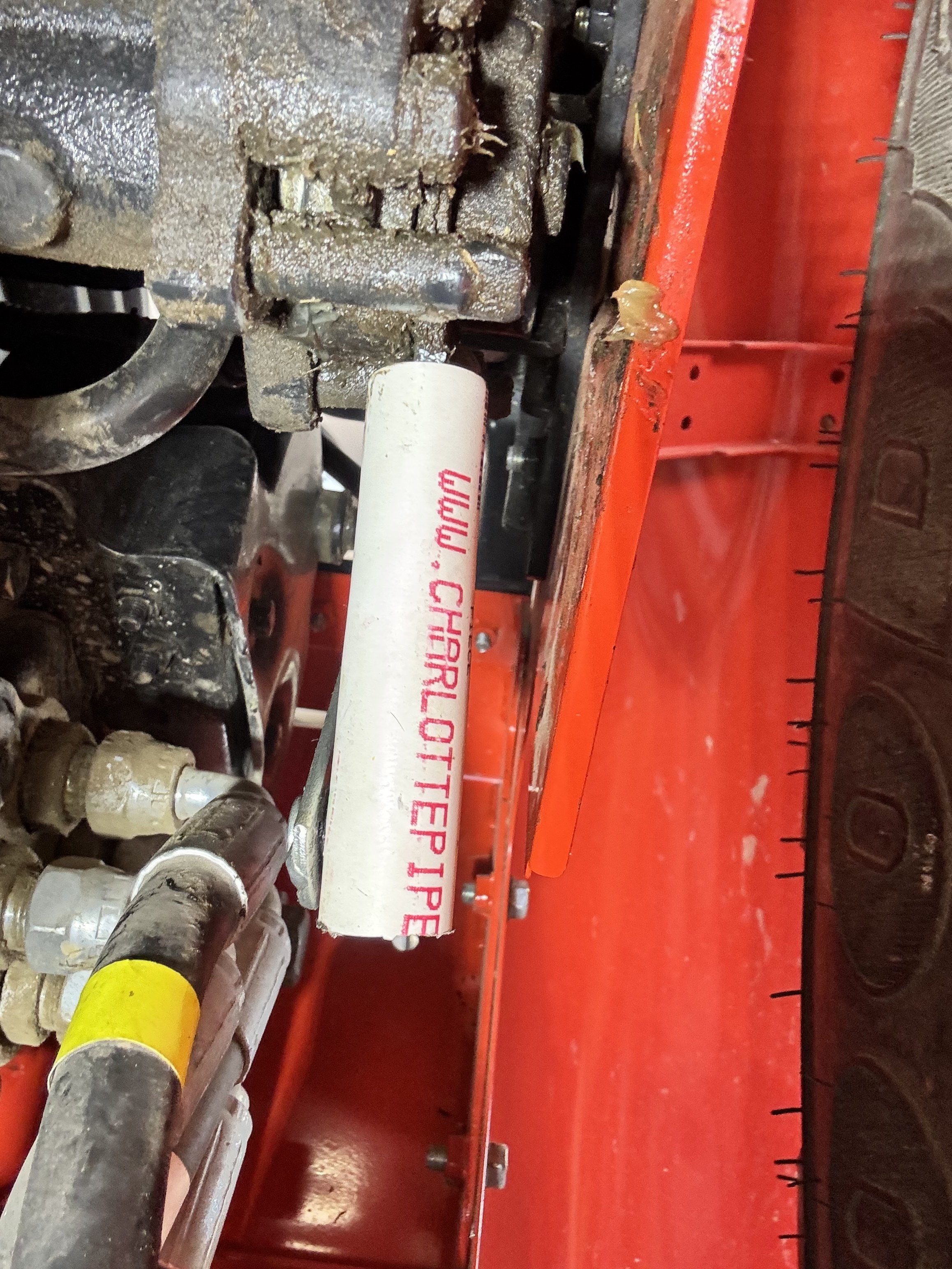

I figured working with plastic was easier than working with metal... I had some thin-walled PVC that fit over the actuator arm rather snugly... I drilled a hole in the free end of the plastic to accept the linkage pin...
The first PVC extension was "too short" as the position control began working earlier than previous but still not the full travel of 1 - 10 ... easy to make another working with plastic...

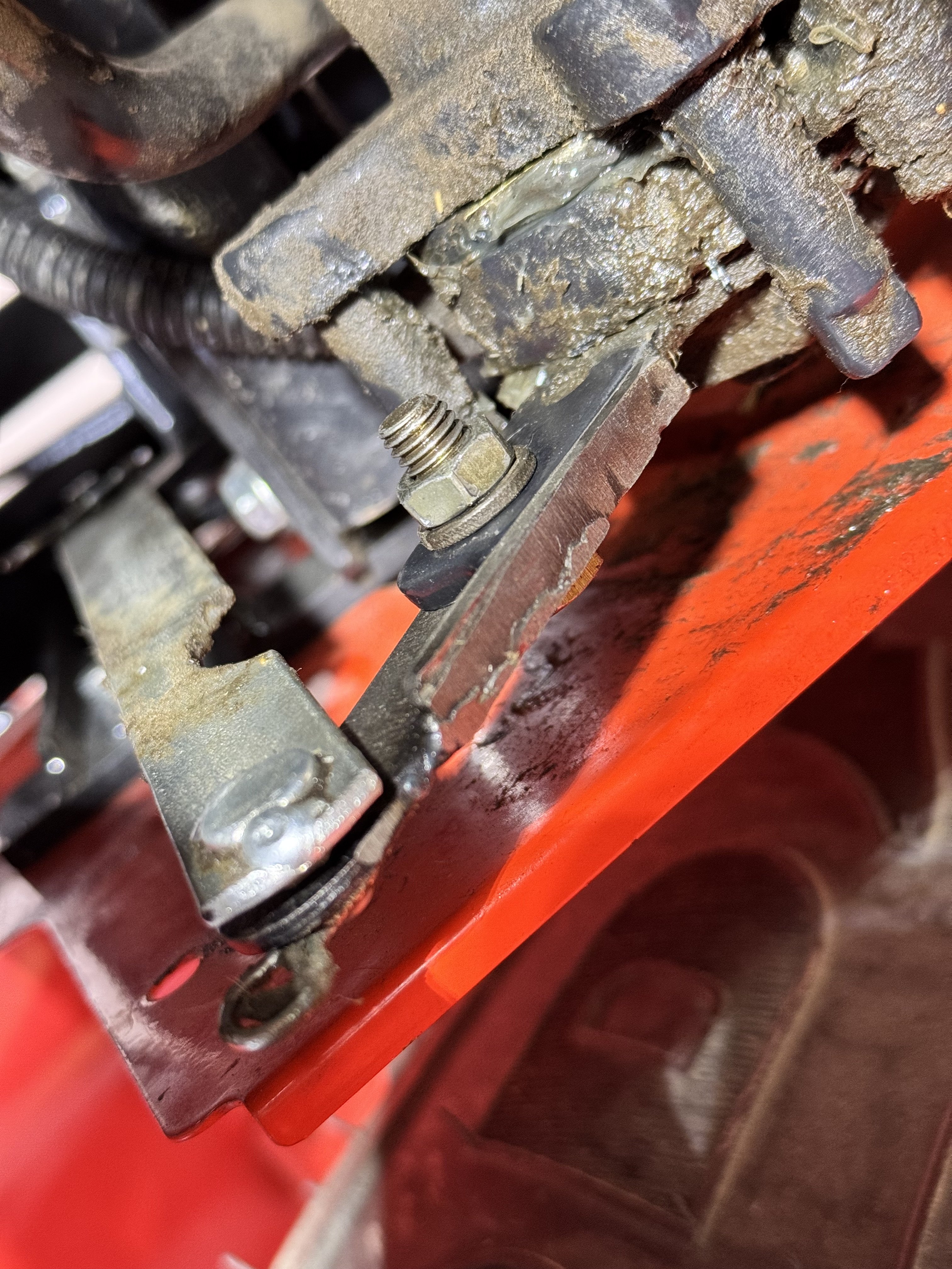

I made the permanent extension out of a piece of scrap metal... welded a piece on the side to rest against the actuator and give it a little more rigidity, then drilled a 5/16 hole in the end for the linkage connection and another 5/16 hole to bolt through the actuator where the linkage originally attached... basically, I extended the actuator arm by about 1 1/2 inches... a lock washer and a little blue Loctite should keep it in place...
Here's the whole shebang assembled and ready for testing...
IT WORKED!!!
The extended actuator arm allows the actuator to rotate more slowly and the way I set the actuator (to be fully lowered even though the actuator no longer contacts it's lower "stop") allows me to begin raising the lift arms with the position control between 1 and 2...

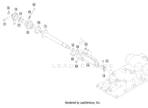

Curious, does your 3pt lever connect to what is pictured in the parts diagram? I'm thinking that #8, 13 and 14 are the adjustment that would have solved the problem. On the other hand, it sounded like it was a geometric problem rather than a sector adjustment problem

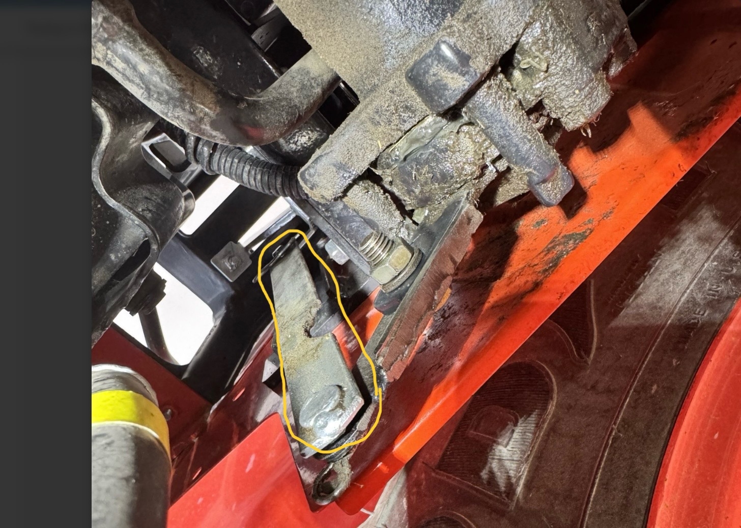

It looked to me 8 is a friction ring… 13 is a spring, 14 is a shoulder bolt… together they work on 5 to keep the position control where the operator desires… the “tab” show coming out the bottom of 5 is the piece I extended… all of this is rather hidden behind the fender so it’s difficult to get a proper picture… the linkage is circled in yellow… there’s a small R pin at the top (pic is taken from below)
The linkage is a stamped piece of strap steel with a pin welded at one end to engage the actuator (bottom) and a hole at the top to connect to the lever…
I spoke to the mechanic at the dealer… he basically said my model was built to a price point and there are few, if any, adjustable bits on these tractors…
