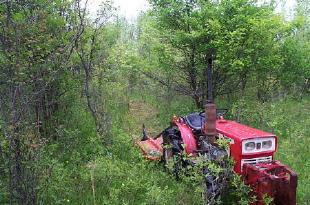

I have a 4' KK XB Cutter on my Yanmar YM1300D. It works great! I am tough on my equipment but that little tractor tows it and mows field grass easily. It also takes out brush and saplings relatively easily. Brush, no problem at all and depending on the size of the sapling. I have been using it to prepare for food plots as well as cutting trails through overgrown brush and fields. The TSC's around here have plenty of them(Canandaigua, and Batavia NY) Price was more for the XB but it has two gauge wheels and the lift pins are mounted lower for sub-compact tractors like mine.
