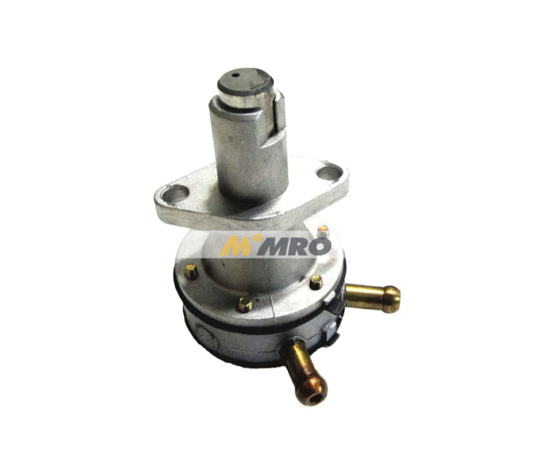

Hmmmm,,,,, wonder what this little widget does? Assuming it goes in the bottom of the tank? No electricals? Maybe detects vacuum and stops fuel flow when the engine isn't running? So it's failure caused the injector pump to flood and pour fuel into the the engine block? Trying to brainstorm this....
It's cam driven, and as far as I can tell, just moves fuel to the injection pump. There's a little diaphragm seal that failed and allowed fuel to enter the case.

It's just a simple mechanical lift pump. Goes on the side of the engine. One of the lobes on the camshaft pushes the plunger in/out and a combination of check valves allows the flow to the right direction.
That explains how it flooded the engine block.
