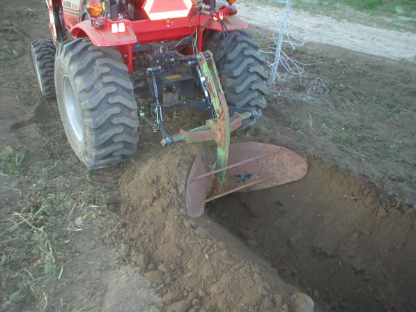

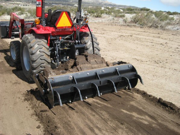

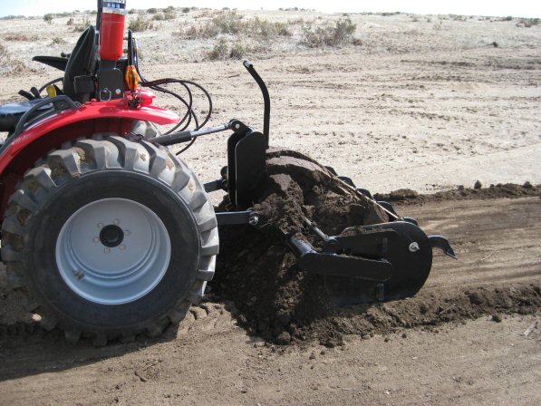

I have a 3215 HST, water in all 4 tires, weighs in right around 5,000lbs. I use a 66" roll-over Gannon. While many people will tell you to go with a 6 footer and you could make use of a 6 footer, I suggest that you find a 66" heavy duty box. You will be able to make full use of it pretty much all the time in about all conditions. Get a 6 footer, a heavy one anyway and you then have to be concerned about the load.

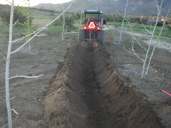

I pull a ditcher with my 3215, it goes down 18"-20", pulls it without any problems, but that may just be the type of ground that we have. Sorry that I can't help you out with the disk question, I have a 6' offset pull disk for it, but have never used it. Use my bigger tractors with bigger disks or use the rototiller on the 3215. And don't forget to get the rear remote, you will need it in the future. Here are a couple of pics. ;)

you answered my potatoe plow question. where did u get that animal of a blade?

My brother picked it up for me at the Tulare Antique Tractor Show in California several years ago. :cool:
