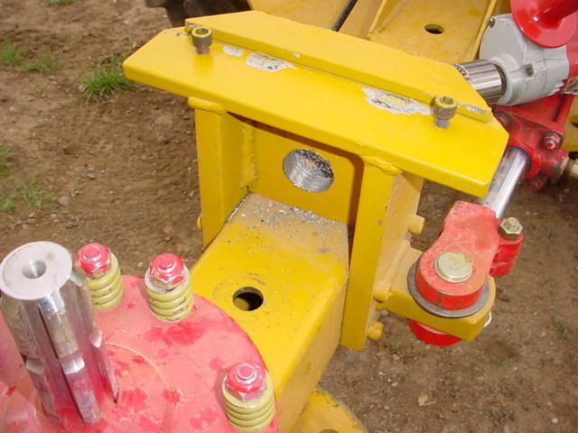

Here is a side view of the wedge showing a little more detail.
This is the theory of how it operates-
Lets say I want to rotate the blade - push a switch to activate the linear actuator, wedge lifts pin, rotate blade, push another switch, retract the wedge, if the pin in not exactly lined up, rotate blade a little then the pin will instantly index then lock into the hole by a spring.

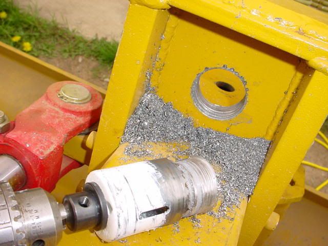

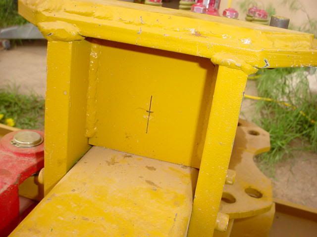

After receiving the linear actuator, it was time to install it. A 1.5" hole saw was used to cut through 3/4" thick steel for the actuator shaft. I found the center location:
Then drilleded a pilot hole, then followed that with the hole saw:
Of course the hole saw teeth grabbed and I did not have a good grip on the drill so it twisted off center and I bent the pilot drill and broke three teeth off the brand new hole saw :mad: , after replacing the pilot bit, I continued punching out the hole. I made it through though :)
Larry

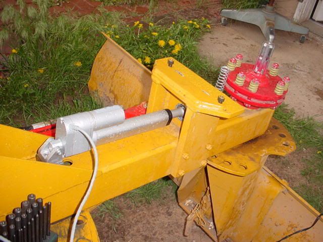

After getting that 1-1/2" hole through the 3/4" thick plate, it was time to make the mount for the linear actuator. I drilled & tapped for 1/4-20 Socket head cap screws. The green stuff in the little cup is my cutting fluid. I use it for cutting threads, drilling & for the hole saw:
Then got the linear actuator mounted:
Then mounted the wedge to the end of the linear actuator shaft and dropped in the locking pin: Notice it's starting to rain - :rolleyes:

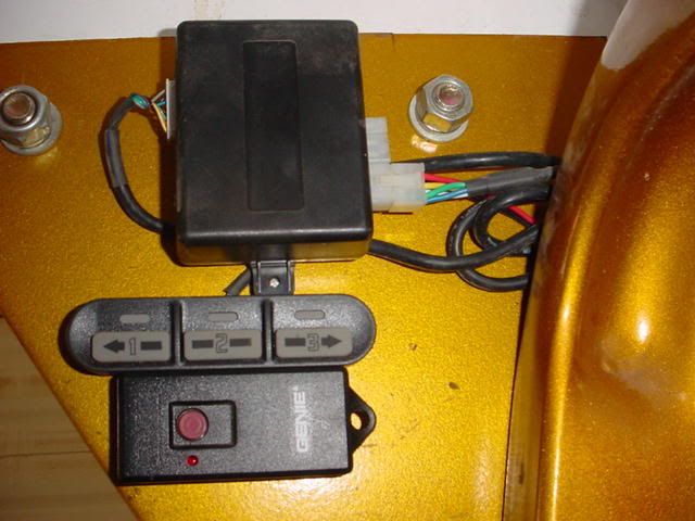

#186
Next was to install the linear actuator switch control and electronics module underneath the ROPS canopy. This was done to protect it from the elements:
Those buttons labeled <- 1 -2- 3-> are what control the actuator, 1 lowers the pin, 2 stops, 3 raises the pin. They are programmable so that you can set the length of stroke. So all you have to do is push the button momentarily, and the actuator will travel the distance set by the program. It remembers it's program, even when power is removed. That little red button is the remote control for my gate.

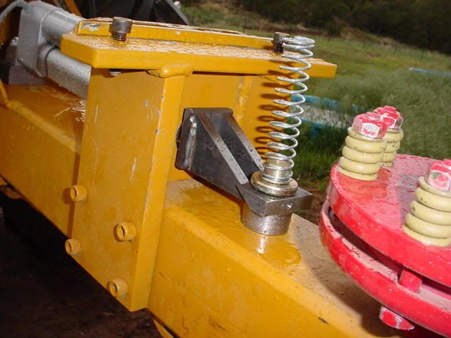

After getting everything painted I assembled all the pieces and parts, then re-installed the gear box. (I'm getting good at removing & re-installing that monster). I attached a ceramic magnet to the underside of the gear box with a short piece of bushing inside to keep the return spring centered. That Idea works great, as I did not have to do any machining on the gear box or use any gorilla glue. The magnet holds very tight. Here is a picture showing all the details of that setup:
Larry
