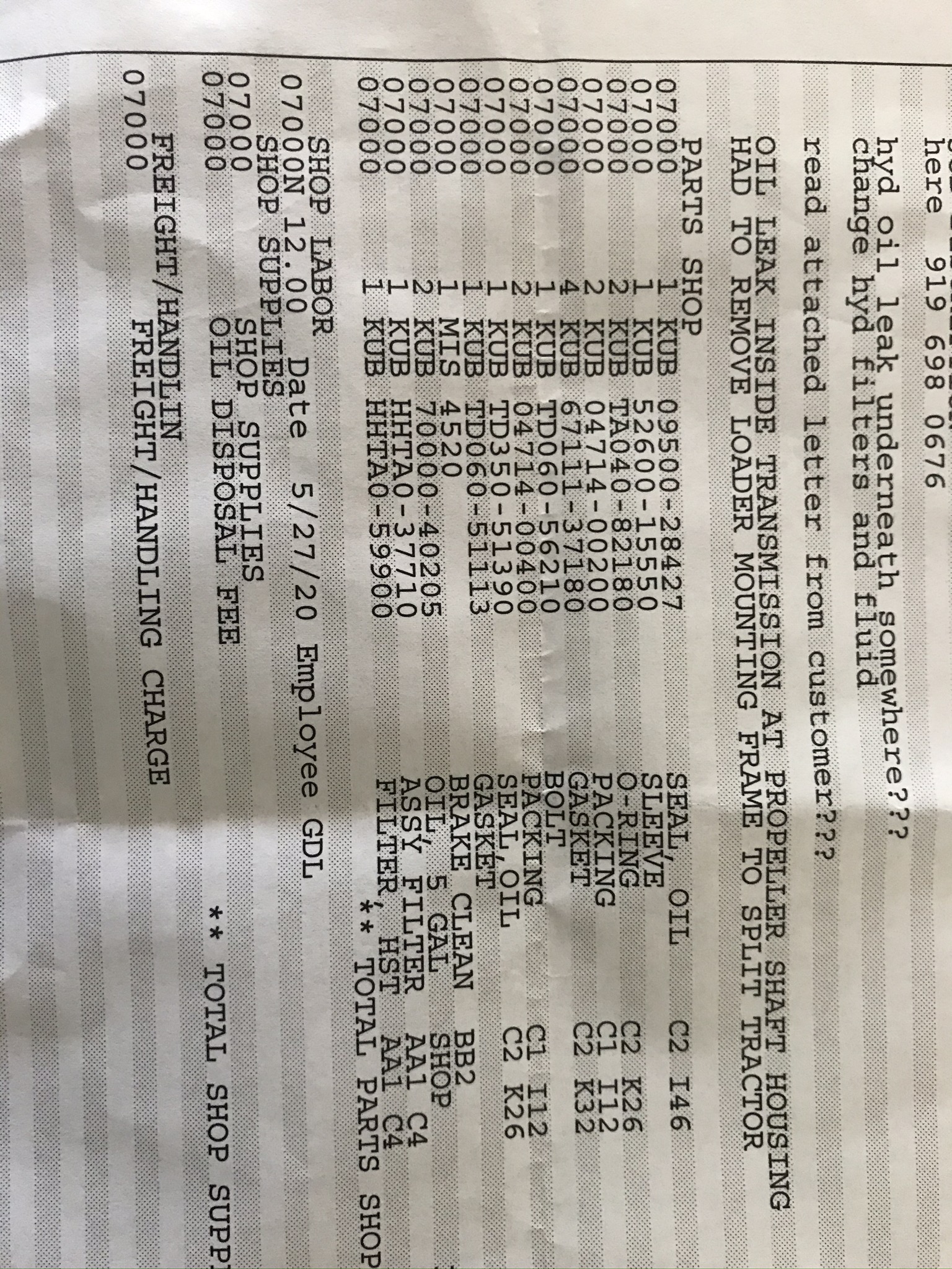

I just took my L3540 in last week for a leak at the split pin. I've been aware of this issue for a couple of years now. Mine just started to leak about a month ago. I only have 375 hrs on mine and was getting ready to change the hydraulic fluid for my HST and noticed the drip from the split pin. Dealer called me today to tell me the leak is from the tranny side and the tractor will need to be split. 10 to 12 hrs of labor at $69/hr. I told them I expected it and to go ahead and replace any other seals in there while they had it open. They mentioned I already had the updated seal on the transmission which I found curious. Apparently the updated Kubota seal doesn't fix the problem?
Background - I bought this tractor used. I believe it's a 2007 year model so that's pretty close to the first year of the 3540. As you can see, I don't put too many hrs on the tractor, but I do like the machine for it's utility when I need it. I also don't run it in 4 wheel drive unnecessarily specifically to avoid any strain on the seals to lessen to possibility of a leak starting up. So much for that cautious approach.:confused: We'll see how this goes...

On my 2012 there was an updated seal for the HST input shaft. The new seal was double lipped and the one I removed was a single lipped design. Also the seal housing has been updated to a heavier design. The price for the parts was relatively cheap.

My tractor is now repaired. I was about to change the HST hydraulic fluid and filters anyway so the timing worked out when they split the tractor and had to remove the fluid. Here's a copy of the invoice showing parts used. I already compared Hunt's seal kit number to my invoice, it's not on there.
I believe my leak was on the transmission side. When the service rep called me stating they had to split the tractor, he stated my tractor already had that updated seal. Hopefully, this will solve the problem for many thousands of hours into the future.

My tractor is now repaired. I was about to change the HST hydraulic fluid and filters anyway so the timing worked out when they split the tractor and had to remove the fluid. Here's a copy of the invoice showing parts used. Hopefully, this will solve the problem for many thousands of hours into the future.

Might I ask what the price tag on all that work was?
