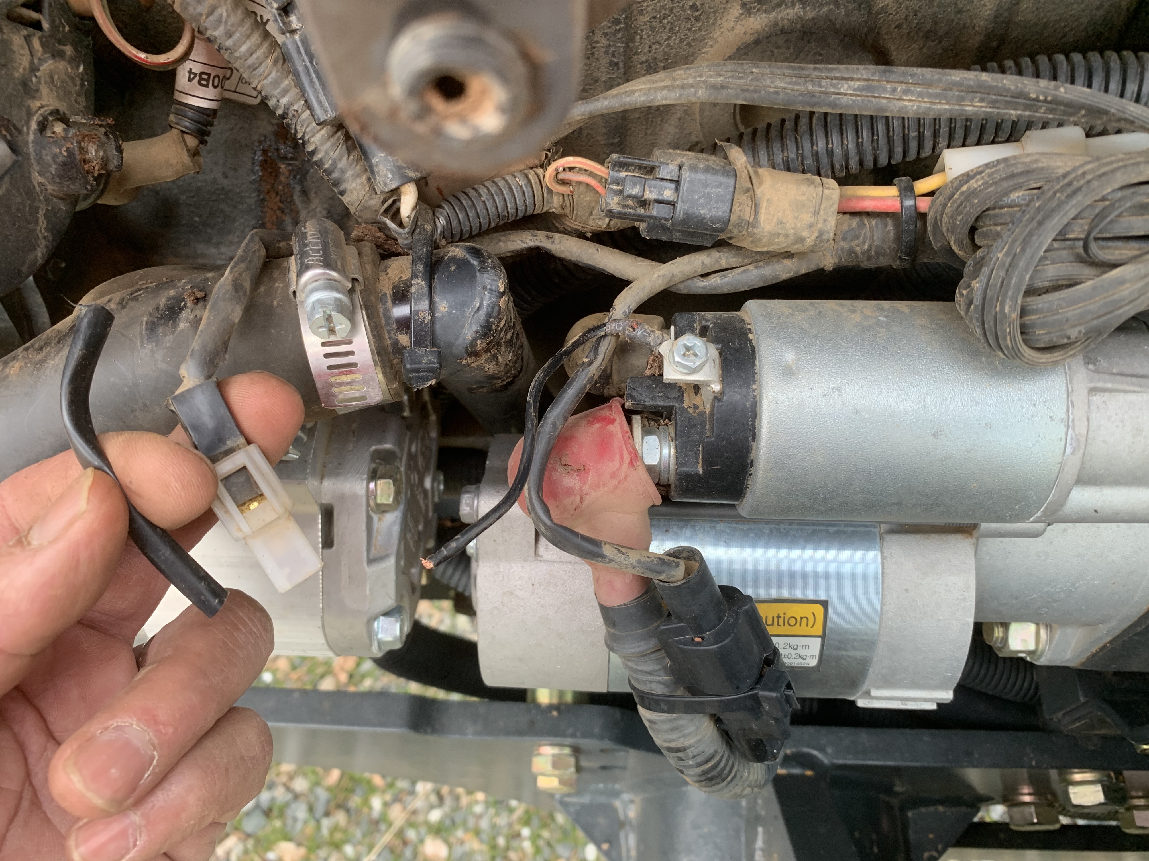

I was using the 3520 as a bulldozer (I know, I know). I was uprooting and pushing scrub growth and brush away from the house and property line. I stopped for lunch and of course the Branson wouldn't start when I got back to it. Turns out a branch or something got into the engine compartment and the starter wire was ripped in two. I did a temporary fix and parked it for the weekend. I'll do a wire repair next weekend.

I have always been surprised tractors don’t have better underside protection. Even brush hogging can expose the underside to taller “stuff” before it gets to the cutter.
Maybe I’m just not understanding the why’s of tractor undersides.

Well you got down to the cause of it pretty fast. That's good. At least it won't be expensive to fix. Also good.

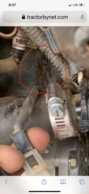

Glad it is an easy fix!
I noticed what appears to be coolant leaking from your block. Any idea what is going on there?

Wow K5! I'll have to check that out. Thanks for the marked up photo! I check coolant about every month and it hasn't been going down. Also in spite of the extreme summer temps here she's never run hot, even when the radiator needs a good cleaning. I'll check it out and let you know what I find.
Thanks Slim. From reading around these forums it seems the checklist items in this situation are the PTO switch (because of the interlock), the battery cables, the fuses, and any damaged wires. Also if the forward/reverse pedals aren't right where they should that can also prevent a hydro from starting (there's a neutral position interlock). I'm an electrician but my wife actually suspected a damaged wire after watching me terrorize the buckbrush. :) Definitely glad it was easy and cheap.
K5, I've been storing the tractor outside for the last few weeks because there's a new log splitter and some other stuff in the garage. That was actually an oak catkin that had gotten wet from the rain and landed there. Crisis averted!

:laughing: I have been wondering about that leak. So glad it was nothing! :thumbsup:
