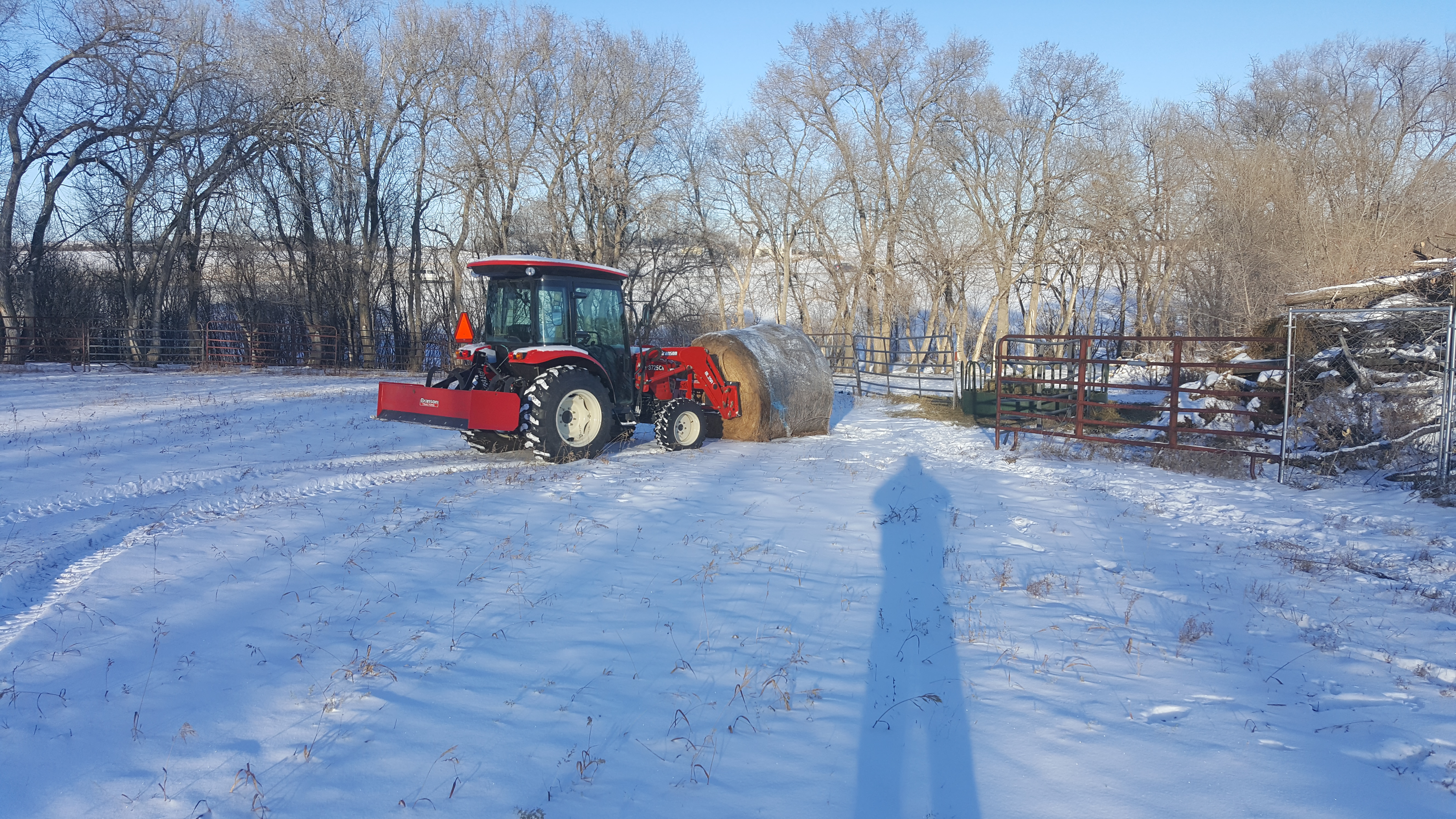

Do you know how much the 5x4 round bales will weigh? The 2 biggest demands on your new tractor will be moving/feeding these round bales, and your "good amount of erosion control". Both of these *may* require a heavier tractor than your other tasks.
Do you already have a plan for what erosion work needs to be done? How much dirt needs moving, and what implements will you have to work with? A good heavy, big, angled back blade will do a lot of dirt work, but requires a heavier tractor to not get shoved around by the blade. A box blade or land plane will be less demanding, if sized correctly to your tractor, but each will be more limited in the amount of dirt you can relocate.
Round bales. 5x4 bales are obviously lighter and easier to move than the 6' large bales. Are you going to be lifting these and dropping them into a round bale feeder, or just setting them on the ground (to feed) and letting the cows climb around in the bale?
My cabbed 25 series weighs 4100 lbs bare tractor weight (no FEL, ballast or attachments), and with FEL, filled rear tires, and box blade (or 6' brush hog), it weighs 7100 lbs. That is weighed on a certified CAT scale, and not a guess.
This is me moving and feeding a rather heavy 6' round bale. I'm guessing 1600-1800 lbs range (it was also a little soft). And it was all that tractor wanted to lift and move. I had no issue dead lifting the bale into the air, but carrying it across open ground and turning into the corral, you could really feel the weight big time. I also had no problem lifting it up and over the side of the feeder, but again, you could really feel it, and I was on very flat ground. This is using an SSQA bale spear on the FEL. Even with the filled rear tires and box blade on the back, I was lighter in the rear than I wanted to be. Next time I used the brush hog as ballast and it was a little better (about the same weight, but puts it further back for more leverage). I think 5x4 bales would be a snap for me, but I don't have any bales that size to try.
I think you'd be in the same boat with a 15 series tractor and the smaller 5x4 bales. You'd probably be "able" to move them, but it would be all, or maybe more than you'd want. Where as the 20 series would give you the extra tractor mass to deal with them safer.
If you're willing to carry bales on your 3pt, I guess it depends on how far you have to haul them, how flat and smooth is the ground you're going over, and do you need to stack them or not. And the question about using a bale feeder, or feeding on open ground. I would personally not feed on the ground without at least a round bale feeder. So if you have to lift bales over a fence, or into a feeder, an SSQA bale spear for your loader becomes necessary. Again, personal opinion, I wouldn't want to have an SSQA bale spear AND a 3 pt bale spear. Not if I was only working with 1 or 2 bales a month. Now if I was bringing bales in from a field, then sure. One bale on the 3 pt, and a bale on the FEL, and bring them in.
