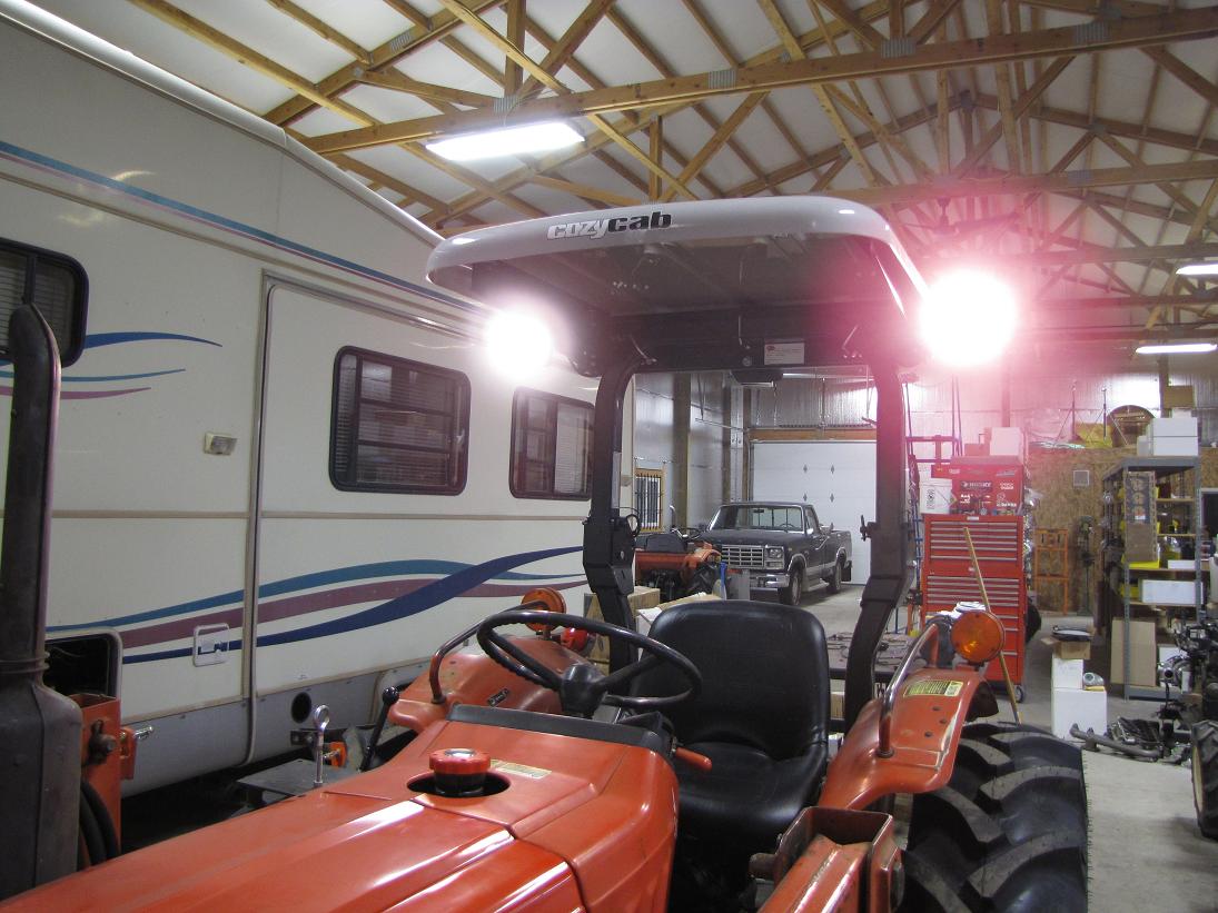

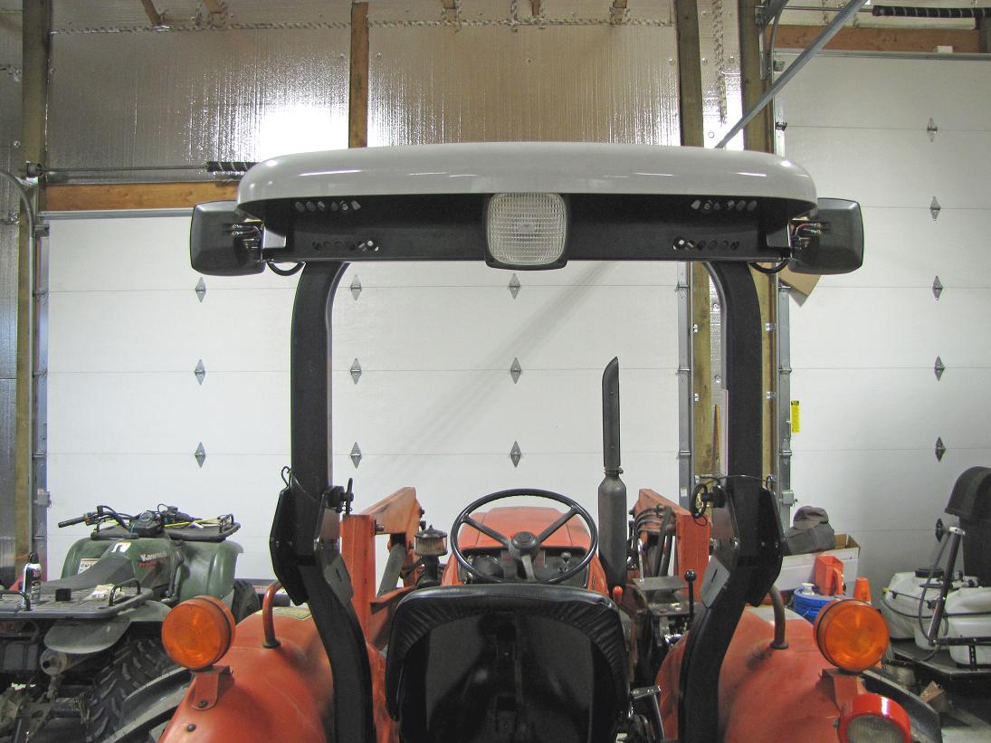

After adding the ROPS to my 336D I decided to add lights for plowing. Two forward facing 55w and one rear facing 55w. As you all know the stock 15 amp alternator won't keep up with the draw from these lights.

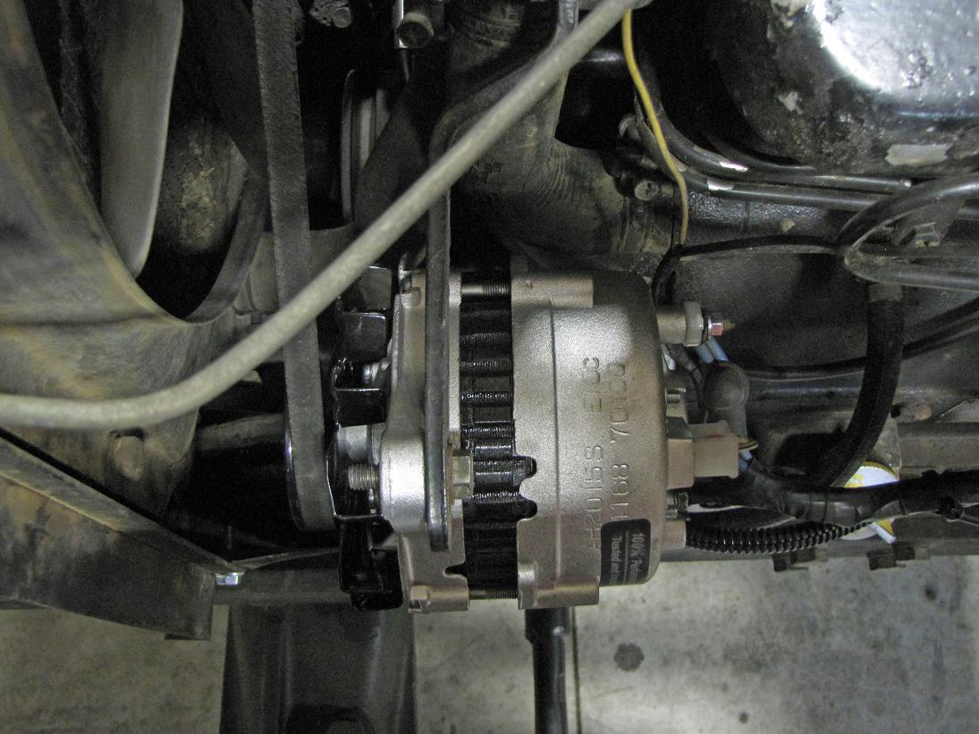

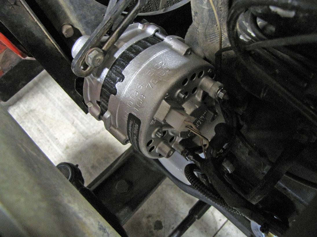

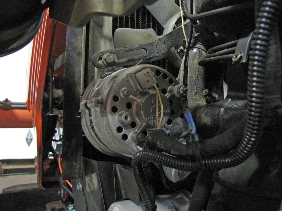

After a few hours of searching and crossing numbers I was able to find a 35 amp bolt in alternator upgrade that was available from O'Reilly's Auto Parts for a whopping $32.99 plus a $4.50 core charge.
O'Reilly's P/N 14105 - Ultima Import packaged, Mitsubishi Alternator
This P/N can come with one of three possible wiring connections on the back. Mine came with a 4 wire rectangular plug but also included a short adapter harness for the "T" style electrical connection on the factory wiring.
To eliminate this short adapter harness all I had to do was release the spade connectors from the adapters plug and the factory plug. The factory spade connectors were then inserted into the new rectangular plug that came from the jumper harness. This gives a factory appearance and makes for a very clean, plug-n-play installation.
Now the system shows a charge even at idle with all three 55w lights on. A simple upgrade that was well worth the time.

Installed pictures below...

Very useful ...I printed it out. I also like the cozy cab top you put on...looks well made.

Gypsy, I know this is a stale thread but I was wondering (besides the dandy alternator information) about your cool Cozy Cab top. Did you add that? Which one is it? Is it very functional and did you pay $500 for it?!
Thanks for a great post (2 years later!).
/ 336D Alternator Upgrade & Lights
#15
I don't recall the cost but yes, I added the folding ROPS and Cozy Cab. Both from Hoye I believe.
