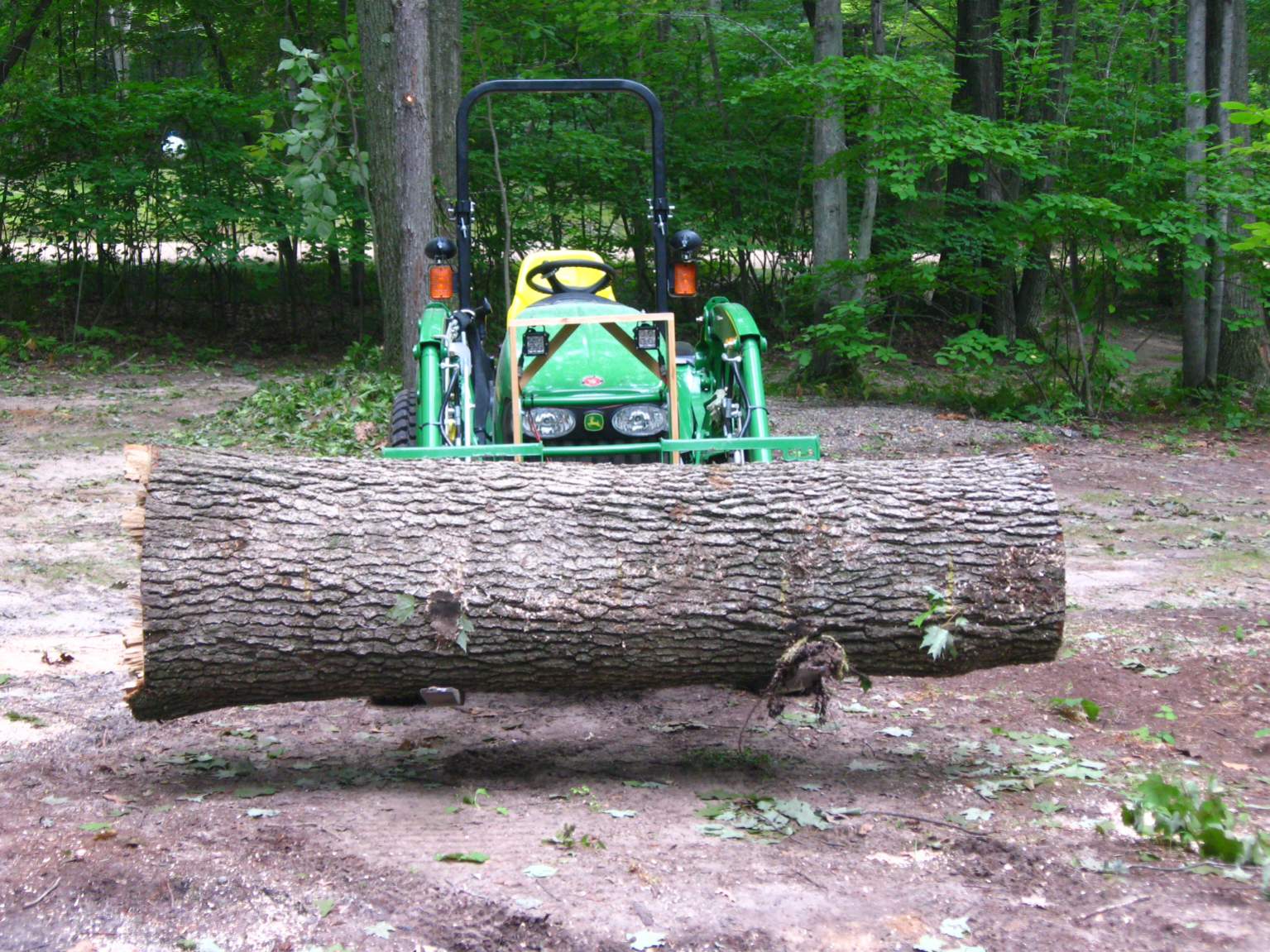

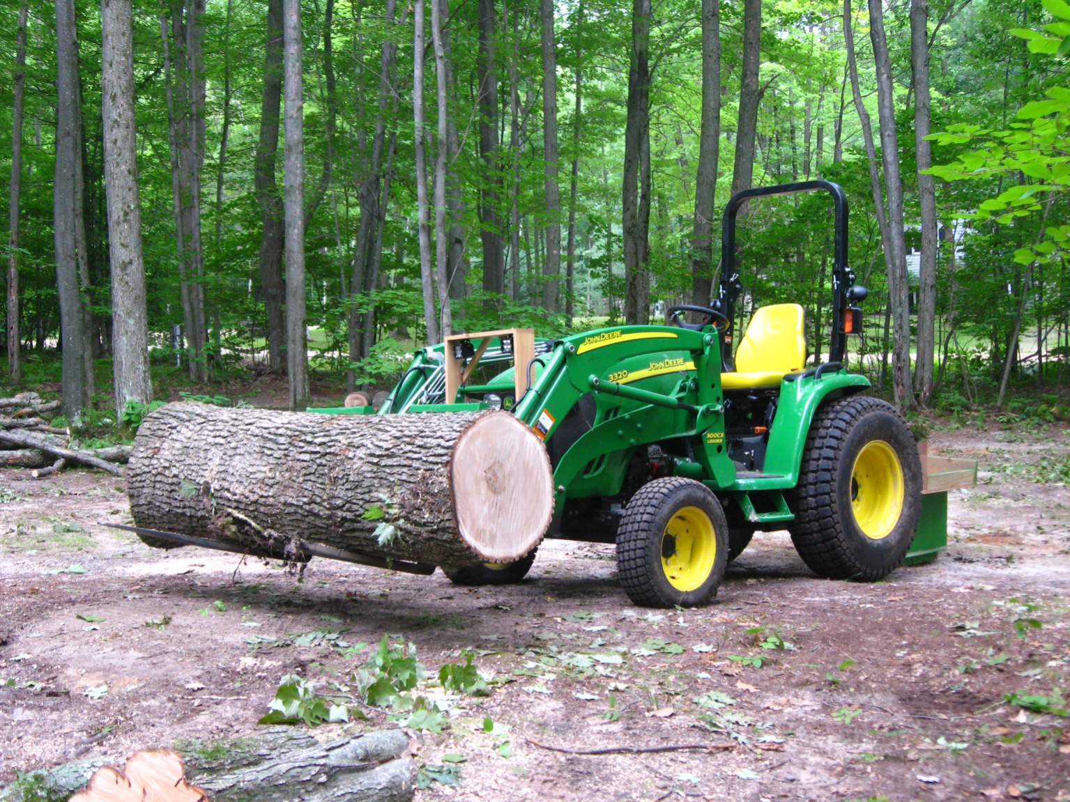

Needed to take down a large White Oak to make room for our camper and open up the woods a little. Tree measured 34-37" in diameter and will end up making a lot of firewood and few pieces of woodworking projects. This was as far as it would lift the log, and needed 4-wheel drive as the back tires would spin without it. Probably could have used a few hundred more pounds of ballast to balance better, but I only needed to move it 25 feet for now.
Horst forks came in handy again.

Steve,
I checked a timber weight calculator and it says - Oak, white - 36" in diameter - 431 pounds per running foot. You may be beyond what your unit is designed to lift. I'd be careful - you don't want to break something over a chunk of wood.

The diameter of that log was probably closer to 30" than base of the tree at 36" average, and as I only moved it 25' or so on mostly flat terrain, the move went smoothly.
Question though - if the loader can pick up a max load, tires are fully inflated, ballast is sufficient, and the transfer from point A to B is safe, should I not use the tractor/loader at its capacity?
/ 3320 vs. White Oak #7
If the rear tires are spinning, ballast is not sufficient. If most of the weight is off your rear tires, it's almost all on the front axle. I would say you should check the manual for recommended ballast, but for heavy lifting, somewhere around 80-90% of your 3pt lift capacity might be good.
Half the stuff I pick up is way to heavy. You generally don't know how much you can pick up until you try it, then if it is to heavy or not maneuverable just lighten the load. If it is to heavy, it shouldn't hurt anything; that's what relief valves are for. My only concern generally is; is it safe or will I tip over. :2cents:
/ 3320 vs. White Oak #11
I have large Ponderosa pine and the weight of a big one ( 34-38 inches) runs about 3200 lbs for a 10' chunk. A 30" x 10' chunk of white oak will weigh just about the same. IMHO, its safer to know your capacity before you try to lift something than to find out by trial & error.
Do a web search for "timber weight calculator" and it will tell you approximately what any type of log will weigh.
A tractor can jackknife faster than you will be able to react if you balance it on the front axle.
I've made a very simple chart which shows the weights of various lengths & diameters of P. pine.
Man, would I like to have a chunk of that white oak - for woodworking. Be safe..........
