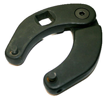

Yup. Sounds like you need a seal kit. There's a specialty tool (gland spanner/wrench) to "uncap" the cylinder. But unless you work on hydraulic cylinders regularly, having the cylinder repaired seems more sensible than buying the tool.

I would assume the tie-rod ends are tapered like a car? Thinking maybe I can just break loose the shaft end and leave the housing end on the tractor?
I see that tool is only about $30 on ebay, probably less than the labor at the JD dealer to have it fixed.
/ 3320 Steering Ram Leak
I just cleaned off the end of the cylinder and there are no holes in the cap for the gland wrench. The surface, as well as all around the circumference is smooth. Any hints on the method of dis-assembly that doesn't tear up the cap? Maybe a strap-wrench? how tight is the cap on? I have not removed it from the tractor yet, in case I need the tractor.
Thanks
Doesn't appear to be welded shut, just no indication on how to turn it....

Corp is 100% right, the cylinder is welded. You need to take it to a hydraulics shop and have them put it in the lathe and remove the weld. Then replace seal and reweld. A replacement cylinder from Deere is $$$.
