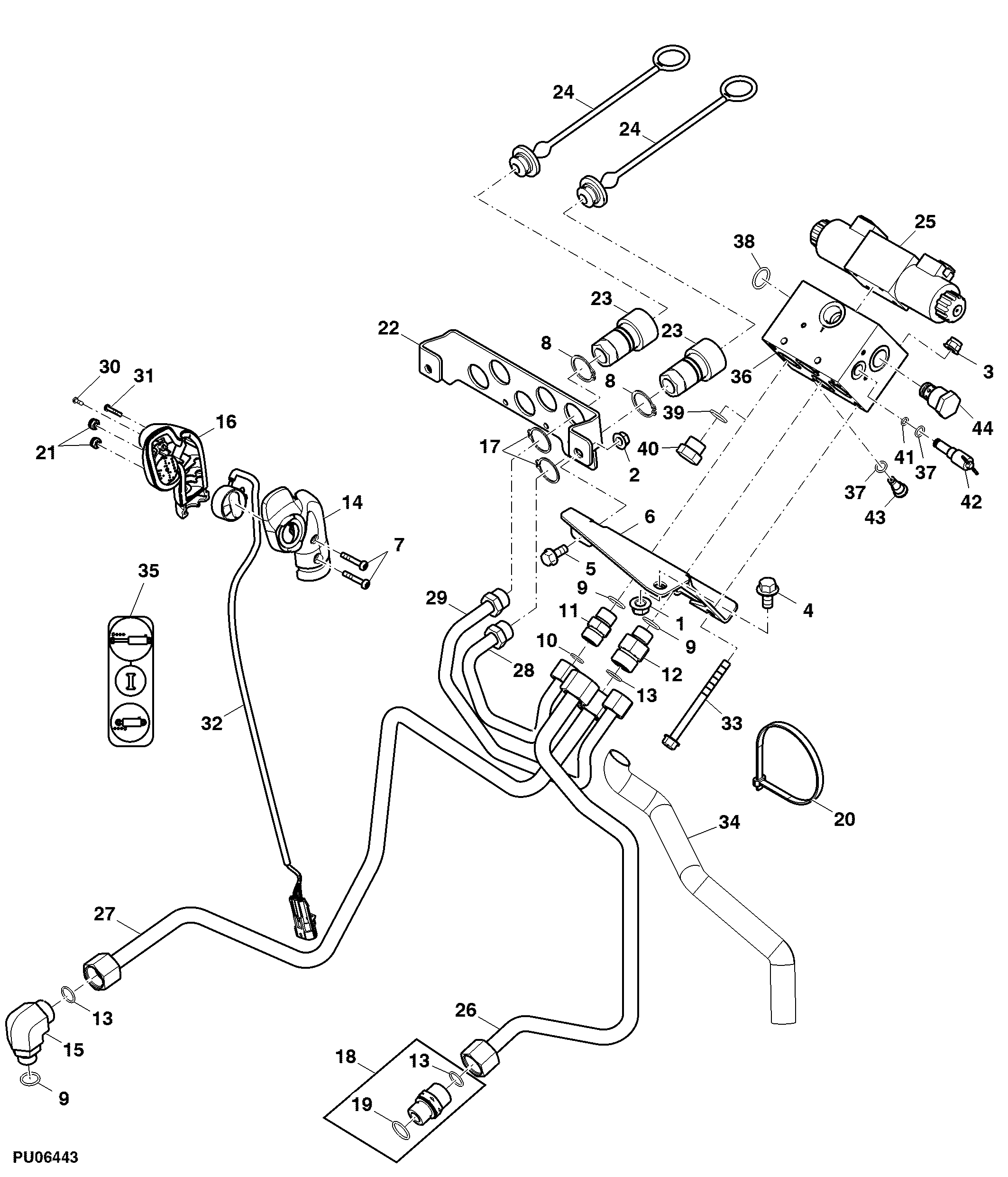

I have a JD 3320 cab tractor with mid hydraulic outlets. I need a set in the rear. Is there a kit, Or an easy way to do it?
/ 3320 hydraulic outlets. #2
John Deere has a few options for a 3rd, 4th, and 5th rear SCV, but I need to know the serial number to help more as they made a major change at # 740001
For example, here is the 3rd SCV kit for the earlier ones:
kennyd, The number on my 2015 3320 is 940298 Thanks.
/ 3320 hydraulic outlets. #4
OK so your machine uses the new (more expensive) EHV's or Electric/Hydraulic Valves, please verify info with a dealer before ordering:
Electrohydraulic third SCV kit (cab only)
John Deere Electrohydraulic 3rd SCV Kit LVB2631
Third Spool Control (Cab) (740001 - )
Cart key PART NO. PART NAME QTY SERIAL NO. REMARKS
1 14M7296 Flange Nut 1 M10
2 14M7298 Flange Nut 2 M8
3 14M7396 Lock Nut 2 M8
4 19M7784 Screw 1 M10 X 20
5 19M7866 Screw 2 M8 X 20
6 LVU23101 Bracket 1 Third EH Mounting
7 21H1486 Screw 2 0.190" X 1-1/8"
8 M42702 Snap Ring 4
9 R26375 O-Ring 5
10 T77857 O-Ring 2
11 38H1161 Adapter Fitting 2
12 38H1317 Fitting 2
13 T77932 O-Ring 4
14 LVU16650 Grip 1 Inner
15 38H1405 Elbow Fitting 1
16 LVU16701 Grip 1 Outer
17 M42702 Snap Ring 2
18 AM123226 Fitting 1
19 51M7045 O-Ring 1 19.300 X 2.200 mm
20 R105388 Tie Band 12
21 LVA12162 Nut 2
22 LVU23102 Bracket 1 Coupler Mounting
23 LVA13231 Hyd. Quick-Connect Coupler 2
24 ...... Plug 1 Dust (Green) (ORDER AW28043)
25 LVA17152 Control Valve 1 INCLUDES LVA18665; Single Spool, EH
LVA18665 Valve Kit 1 Not Illustrated
26 LVA16832 Oil Line 1
27 LVA16833 Oil Line 1
28 LVA17137 Oil Line 1
29 LVA17138 Oil Line 1
30 37M7355 Screw 2
31 37M7356 Screw 1
32 LVA17501 Wiring Harness 1
33 19M7970 Screw 2 M8 X 100
34 LVU23855 Hose Guard 2
35 R139665 Label 1
36 LVA17154 Manifold 1
37 R28782 O-Ring 2
38 R26906 O-Ring 1
39 R26375 O-Ring 1
40 M122390 Fitting 1
41 R30903 O-Ring 1
42 LVA17954 Valve 1
43 AT307262 Check Valve 1
44 AN261744 Check Valve 1
