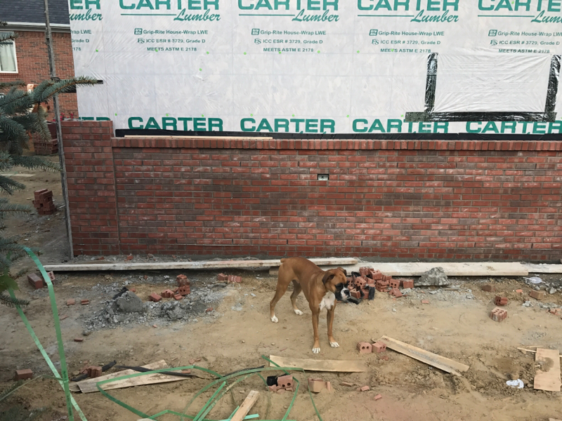

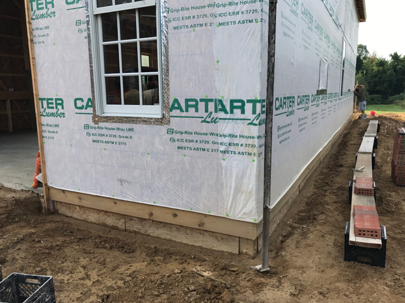

Please excuse my ignorance..... What is the bottom row of bricks sitting on?? Thanks!!!!! Is gonna be awesome!!!!
I've been wondering that too. Usually it's a concrete footer that goes down below the frost line and is part of the slab. I'm real curious how they did this so the bricks wont move during winter and crack.
   / 32x56x12 The Barn #167
Yeah, that was why I asked. I didn't see a poured brick footing that's normally visible.
Maybe they drilled into the floor slab and pinned a brick footing?
No bashing here at all. Just very curious. :)
   / 32x56x12 The Barn
#169
Sorry for not responding, iOS 10 does not let me text responses so I'm using talk to text. As for the brick, it is sitting on a 42 inch plus putting by 16 inches wide
   / 32x56x12 The Barn
#170
Is that foil tape used to seal around the windows? Never seen it used for that before. What is the OSB for that's resting on the ground at the base of your walls?
The silver tape is from P EL LA.
