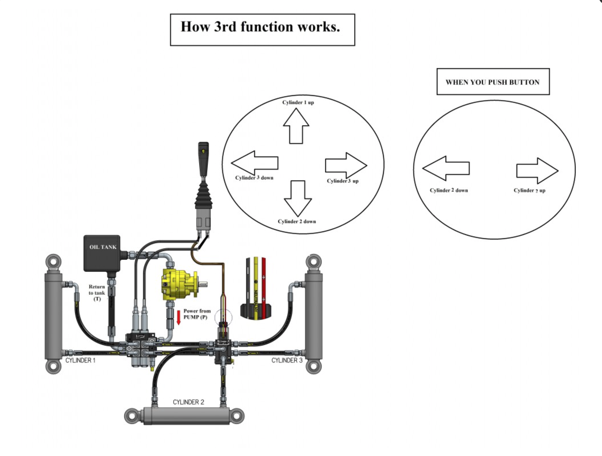

Hey all - I finally got a loader for my JD3255 and rather than use the old crusty and half broken two handle controls I went ahead and got a new valve and joystick setup.This one.
I have the loader mounted. The valves all plumbed. The loader raises and lowers.
What I can't figure out is how I need to wire the joystick to power and the solenoid for the 3rd function diverter valve. This is all new and Greek to me. Anyhow have any suggestions or a wiring diagram? This is what they shared but I am missing something somewhere to connect to power.
/ 3255 3rd Function Solenoid Wiring #2
Your joystick should have a battery input, + and -pair of leads which you hook into your 12v power. Make sure it has a fuse inline on the + side.
The kit should have a harness from the joystick to the diverter valve that just plugs into both components.
If not, can you show us pictures of what you got including the electrical parts on the valve and the joystick?
