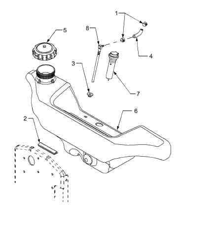

My daughter mowed while I was out of town and told me the low fuel light stayed on. I filled it to the top today and the light still stayed on. Does anyone know how this operates? Maybe a bad switch or could a loose wire cause it? Is there anywhere that a wiring diagram can be downloaded? Thanks,

Hey Bob,
Looks like a simple switch in the tank.
OK, nothings ever simple!
Here's a tank picture and schematic.
The component labeled with a 7 is the sending unit.
Good Luck,
Curt

Thanks, that's the info I needed. BTW, where did you find the schematic PDF file?
