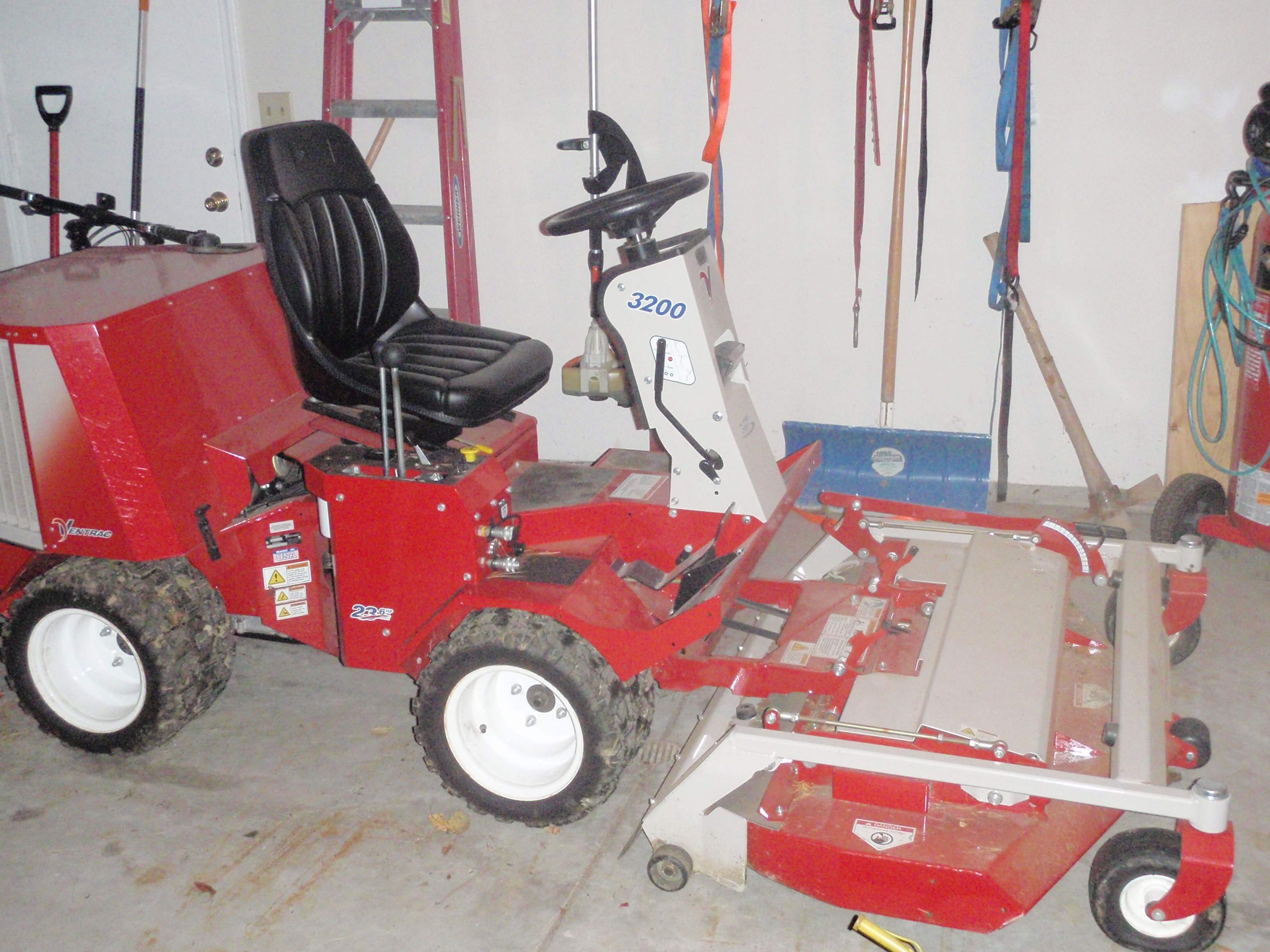

I had some time this morning and wanted to post the equipment I have and some of the mods I have made. Someone asked about some forks I made a long time ago and I never got back to him. The forks are gone but they worked well around the yard and are easy to fabricate. I used some 1 inch square bar and welded brackets to the top which slid over the front arms on the ventrac lift. They worked well for picking up logs but I wanted something flatter I could use as a make shift forklift. What I have now is the 2 in 1 and I welded a plate of steel across the bottom. I probably could have made it cheaper but the 2 in 1 is sure put together well. please see attached photo.

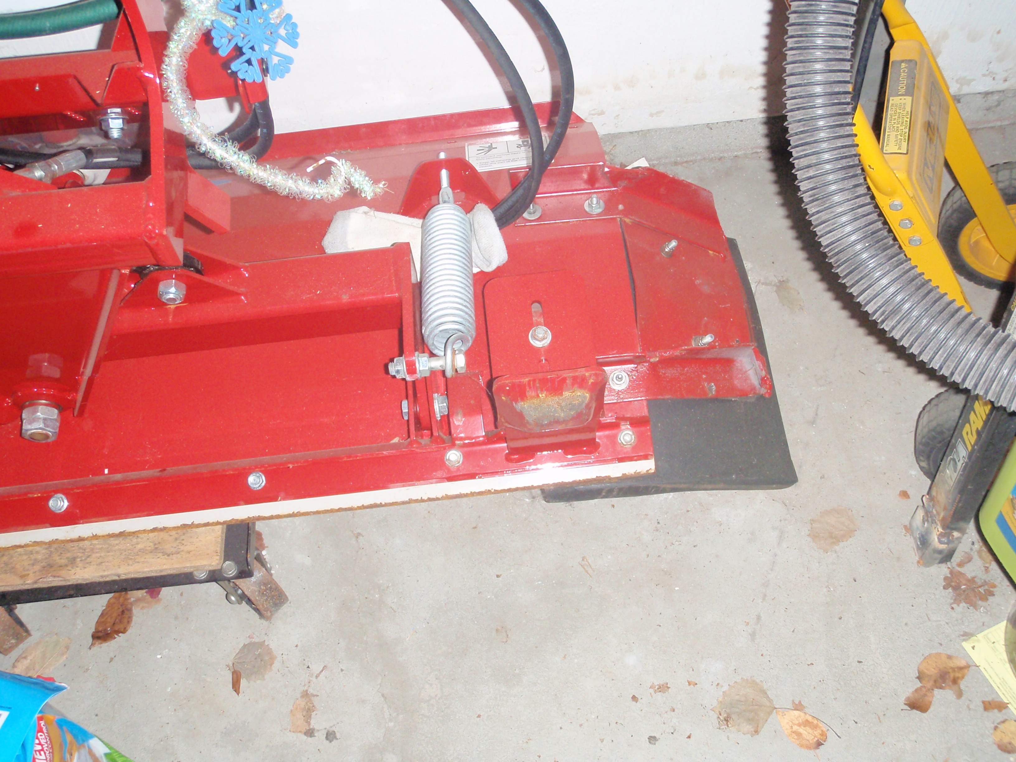

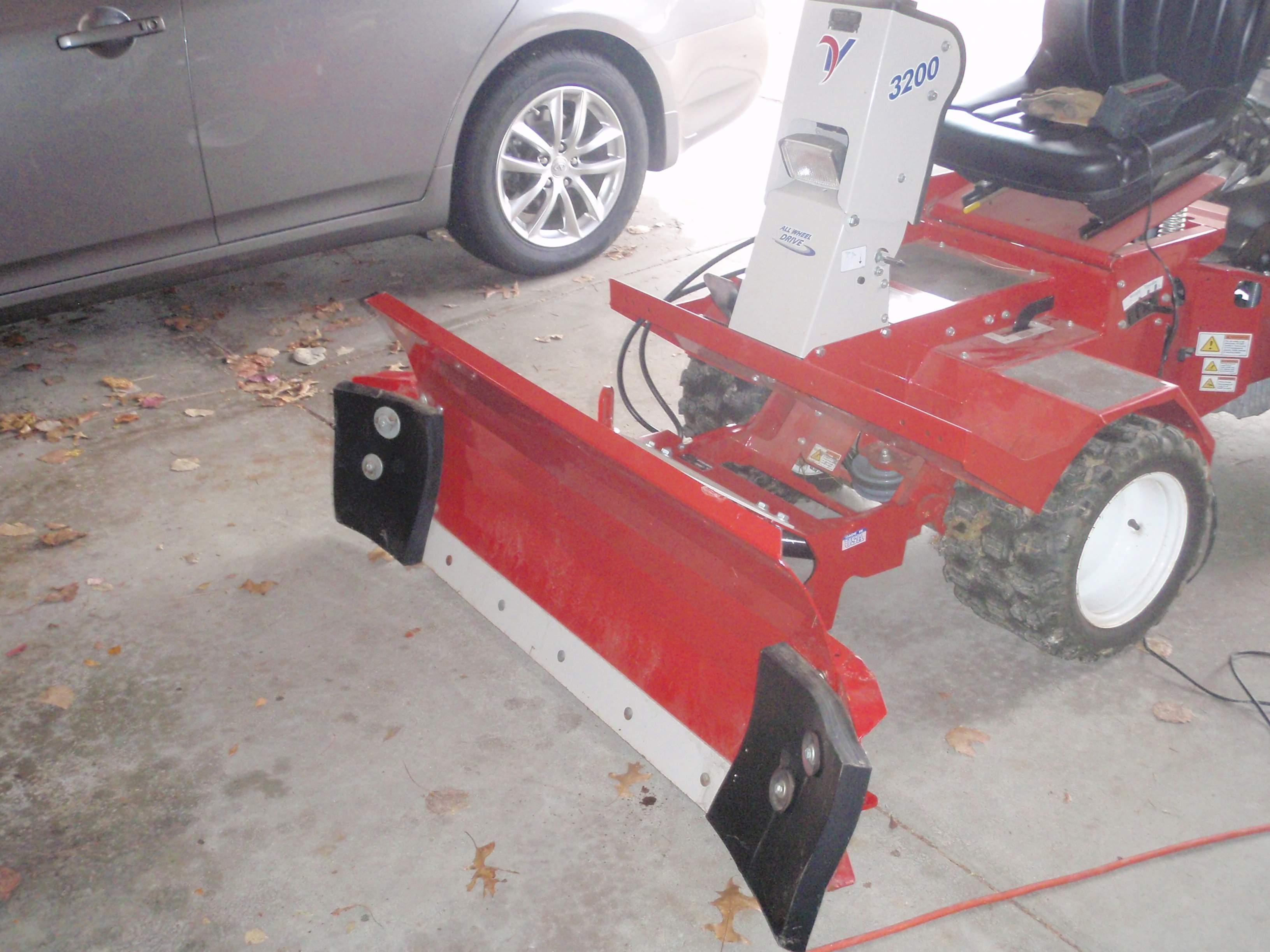

With one of the other pictures I am trying to show some wings I made for my plow. The plow already had holes but I could not find plow wings anywhere. I bent up some angle iron and formed some plate steel. The black piece you see if a 1 inch think piece of rubber bolted to the wing. It helps to scrape the snow and funnel it to the center of the plow. I will post better pictures before the snow flys.

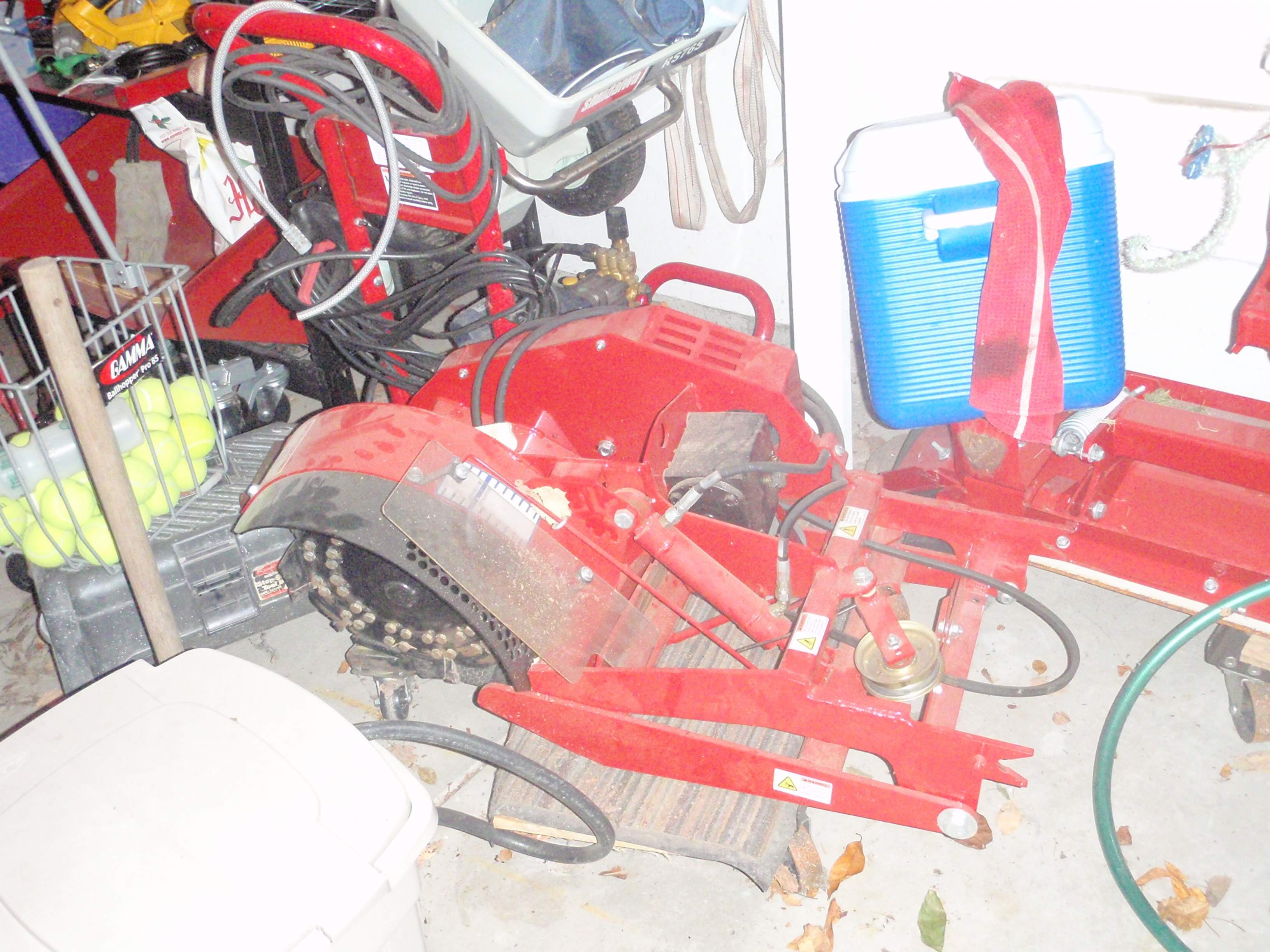

I also posted a picture of the stump grinder.

Nice pictures and cool mods! :licking: I wish I was a little bit more handy/motivated :laughing: My friend loves his 3200 as well. It is a bummer about the 3000 series attachments not fitting on the 4000 series. The blade and the 2-N-1 are universal, but the stump grinder and deck aren't. I am sure if you upgrade to the 4000 series you can get a good trade in value or sell for a pretty good price. I see a lot of people looking for used 3000's and they are hard to come by. Anyways great little tractor and glad you enjoy it! I love my 4100, Ventrac makes some great product :thumbsup:

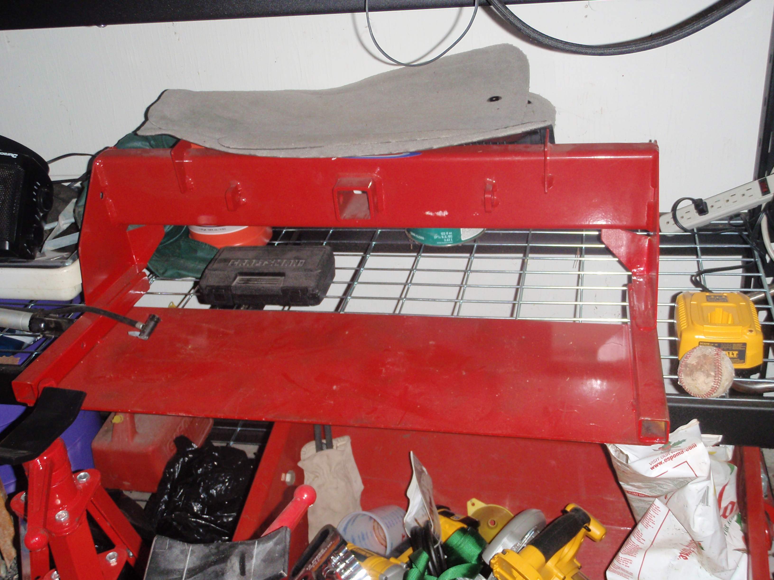

Thought I would post a picture of My Ventrac with the plow on it.
My driveway is pretty steep and with any ice traction can be an issue. I think I will add some weight this year to the rear of the tractor. I would like to add some wheel weights but not having any luck finding them.
Anyone else adding weight to their 3000 series for traction?

With the knobby tires I think the traction is pretty good. Only if it is really icey have I had problems.

Nice pic toro5xi, but I am not ready for the white stuff to fall :laughing:
I have no issues with traction on my 4131 where my friend with the 3223D might have slight traction problems when really icy, but he rarely has traction issues.
@marnett...Your dealer is most likely correct on the diesel unit as the engine is much heavier than the gas engine (guessing 200-250 extra lbs?). The option is there to add the rear weights, but aren't necessary for the 3223D imo.
What my friend did, rather than adding more weight to the back, was add weight at the front. Don't know if he simply bought some extra suitcase weights from Ventrac and hung them right at the top where your toes would be or if he actually welded a bar to hang them on at that point. That way the weight is still right over the front axle and you have solid contact on all 4 tires. I haven't used it on icy ground since he did that little mod, but he says it has helped enough that any spots where he may have had a small traction issue, it is now gone. Just an option if you are experiencing traction issues, but I think it is unnecessary 99% of the time as the 4WD and traction of the Ventracs is superb and they can push a lot of snow!
Also to note, I am sure your traction on the front end is variable to the weight of the operator lol My buddy is smaller and only weighs 130lbs. Get a larger operator on there and you might not need any extra weights :laughing:

Have you done anything for weights yet on your 3200? I have a early model, 3000 and I made a "weight box" to hang weights on the back. I'll try to post pics soon.

A friend of mine had some 50 pound weights they would use to test large scales. They are almost a perfect square shape. I used 2 of these the other day and they worked pretty well.
