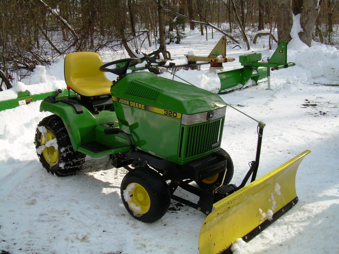

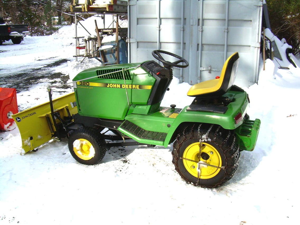

Hey can you check the serial number on your plow? This would be helpful. I am going to drive out to Indiana to get this thing and my fear is that it may end up being a long haul and find out its wrong. The John Deere dealership can't even tell me if it fits. This is very troubling in that they should be able to tell me.
Sorry, I haven't been on in awhile.
I can't find the paper work for my plow but that second pic looks just like it. And yes the hydraulic lift will lift the plow but you angle it manually from the seat, the angle kit was an option and works well/easy.

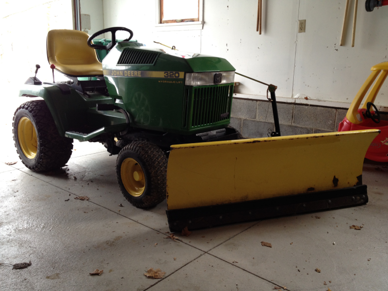

Attached is a picture of my 320
main.php
/ 320 garden tractor #45
Nice looking well maintained machine!

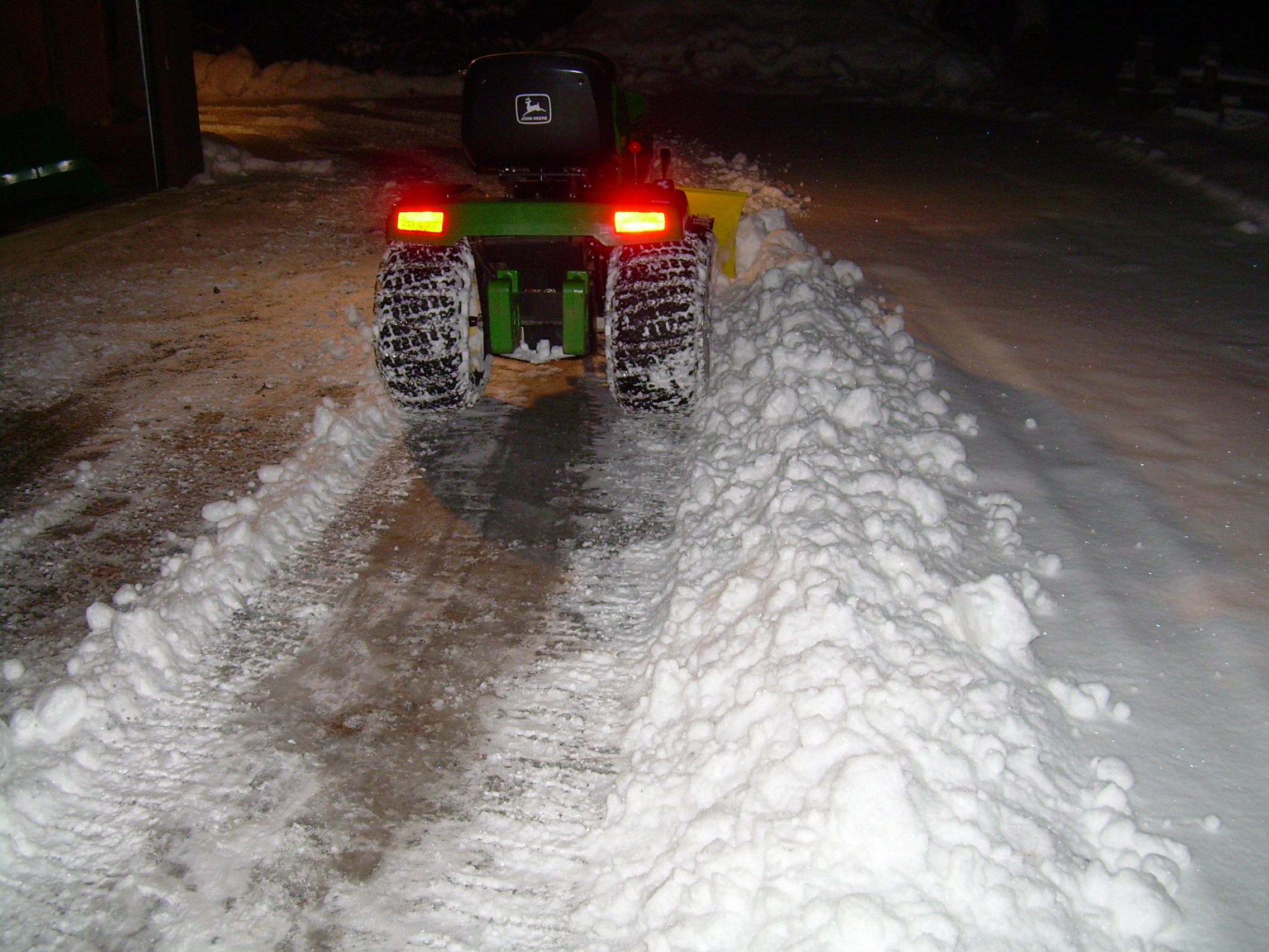

Well I found a snow blade for the 320 on Friday. I was mining ebay and craigslist and to my surprise a front blade listed for 1 day about 3 hours from home was online. In talking with the guy he was selling it for $425. In the end he sold it for $400 which is about $100 off of what I was finding other plows on machinefinder.com. The MachineFinder blades however would have cost $200 to ship.
I tested it out last night and it hooked up with fine. The blade came off a 1999 GT325.
Thanks to everyone for their help. Pictures will come next

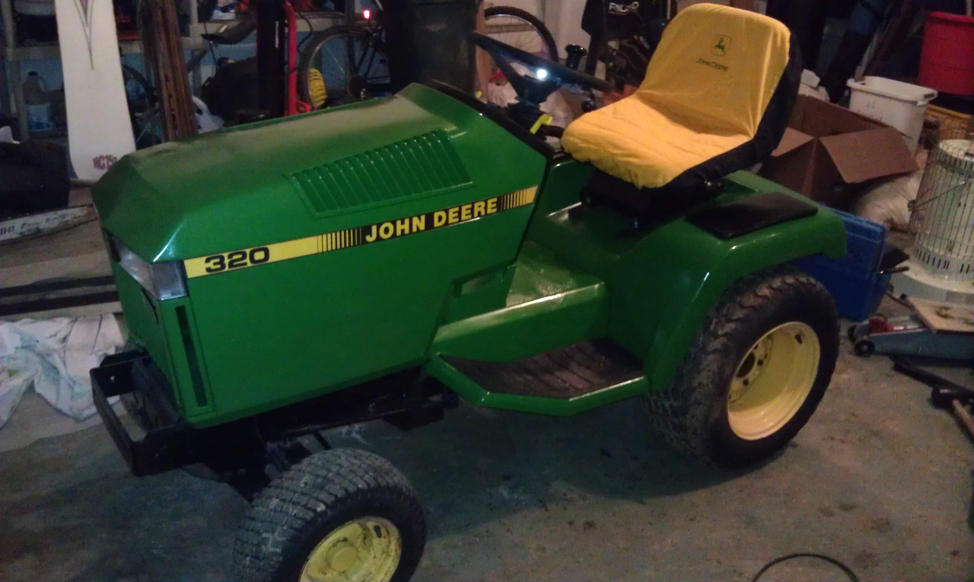

Just completed restoring my JD 320... here's a couple of before and after. It took a bit of time, but was well worth it... it purrrs now.. and so pretty!! Attaching a blade tomorrow and will sit around and wait for the snow! Figures - terribly mild winter here in Maryland.

Wow! looks like you did a nice job. So you have the snow plow? How about chains and weights? They definitely help.
It is very mild around here too, I'll be working on a roof tomorrow.
