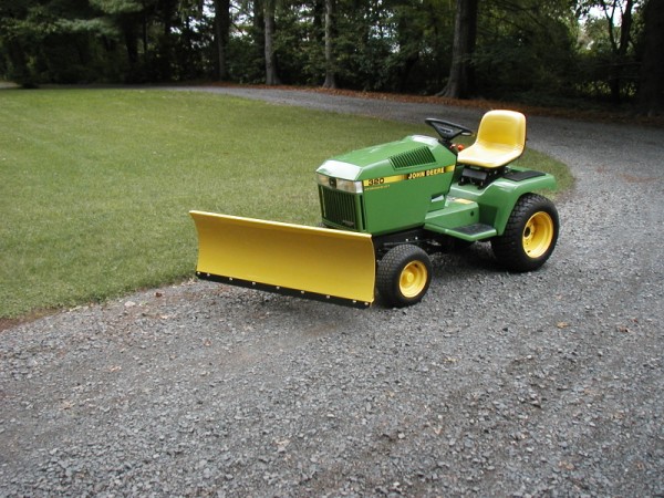

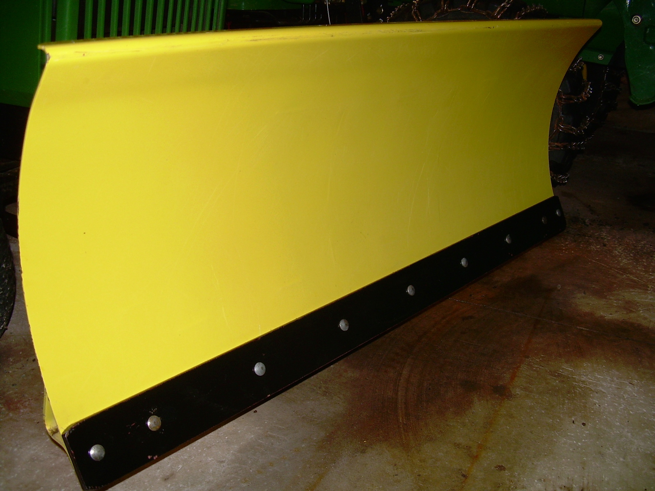

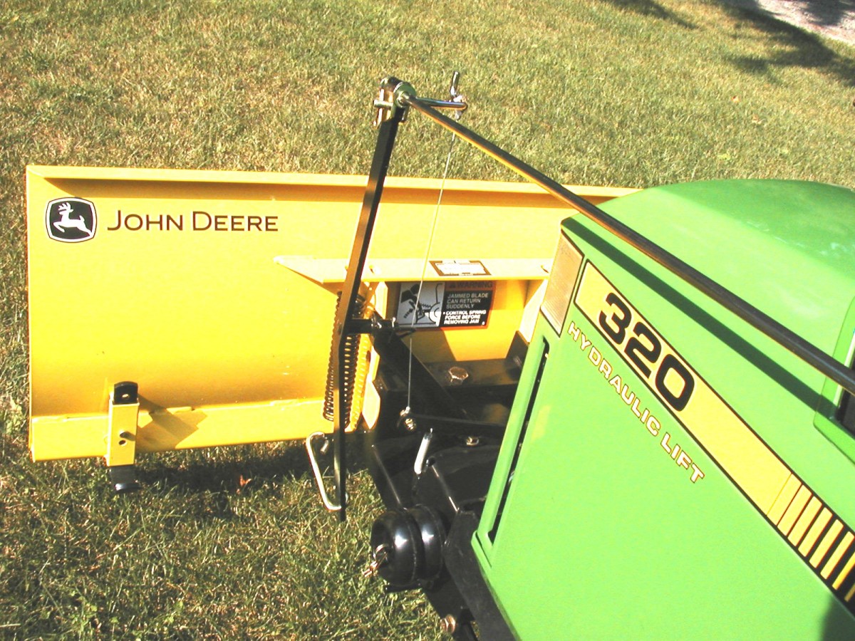

A follow up long over due, this tractor makes mowing almost fun and after getting a chance to try it in the snow I'm very happy. those were the two things I needed it for, I was a little worried about the plowing since it doesn't have posi traction, but with the weights and chains it does an excellent job. note the suit case weights on the rear, as well as wheel weights.
Beautiful set up you have there. I've always wondered why Deere decided to not offer the hydraulic plow angling feature of the old 300 series on it's newer models. That would be the one thing I would dearly want to have.

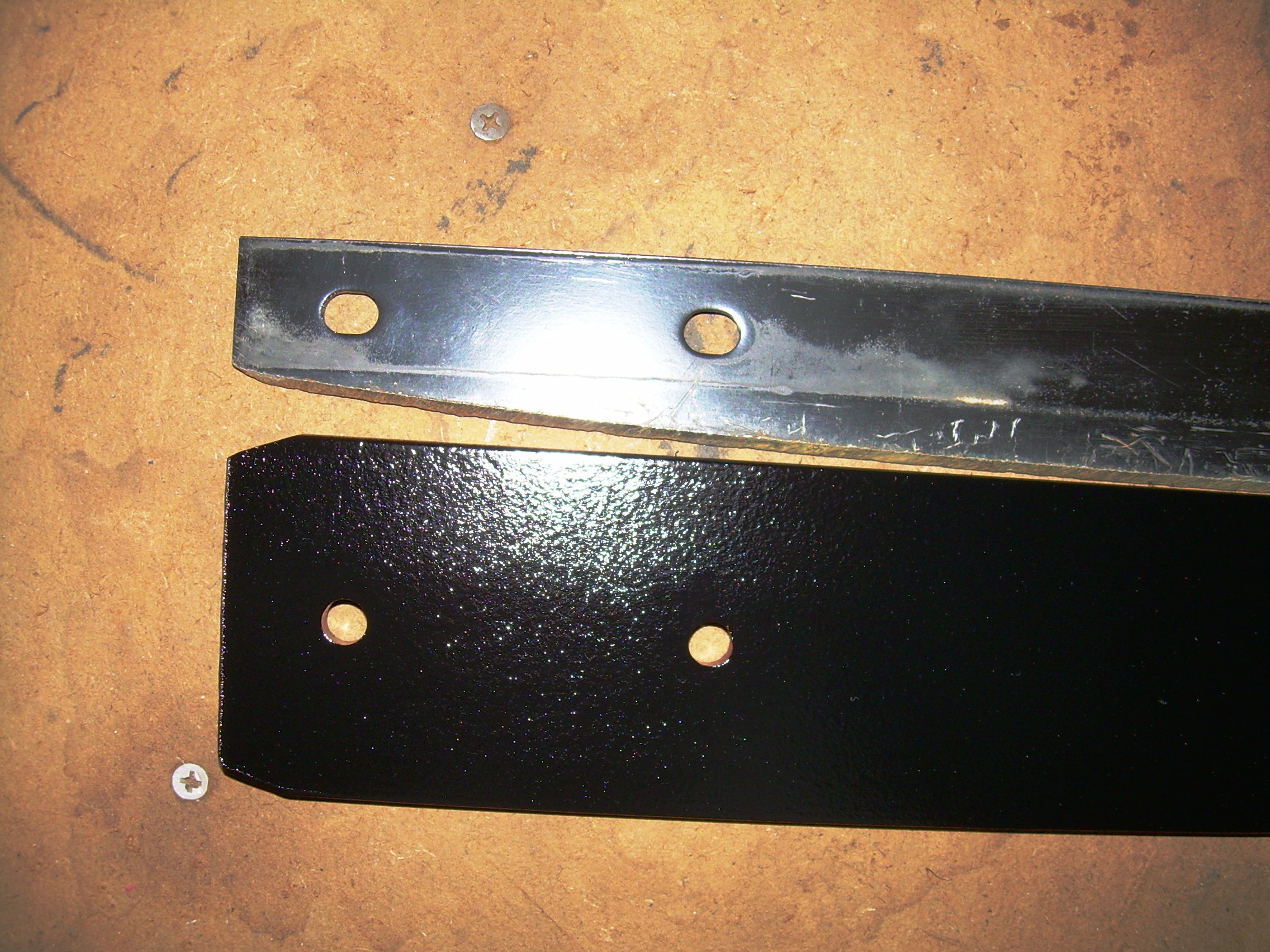

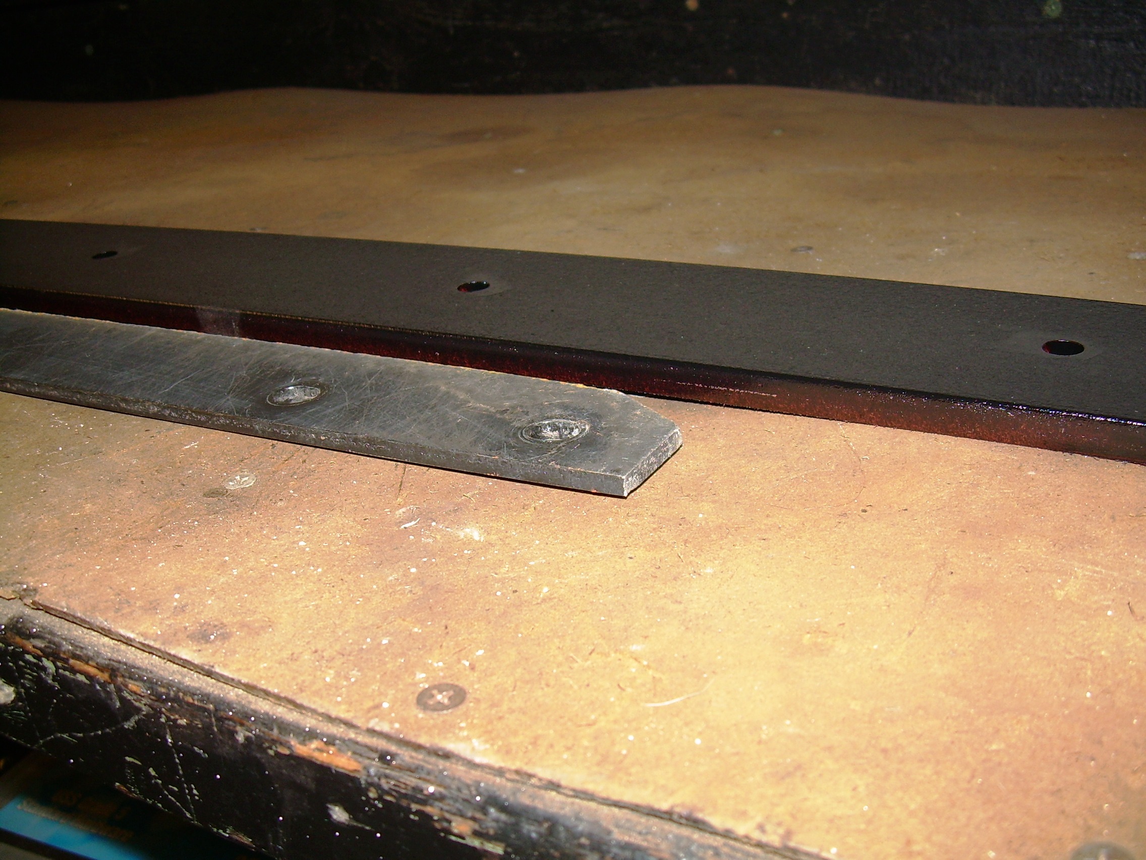

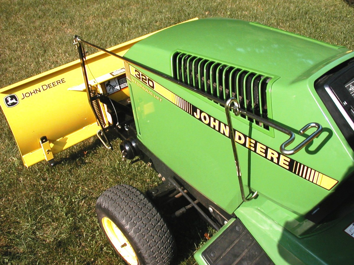

Another update,
Overall I'm happy with this 4 foot plow but am disappointed in the wimpy cutting blade edge that came with it, after just a winter and a half I noticed significant wear, I thought I could make it thru this winter but upon closer inspection I noticed it was already scraping on the plow body.
I do plow 600 ft of concrete side walk plus a few paved driveways between mine and the neighbors, but still I think it should of held up better than that. The stock blade was 3/16" x 2" and could not be flipped.
Went to a welding shop and got a pc of flat stock 48" long and 3/8" x 3" for $20. drilled and painted it, and was back in the snow an hour after installing it. It's twice as thick now and can be flipped, so it should last a while..

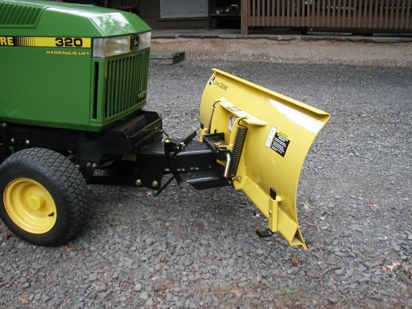

Just picked up a 320. Where should I get a plow?
/ 320 garden tractor
#33
Welcome to TBN,
I got mine from the dealer, not cheap though, paid close to a grand!
JB.
/ 320 garden tractor #34
Ebay, Weekend Freedom machines.com, Craigs list are a few places that come to mind. Also check out the boneyards behind ALL of your local dealers (any brand) for one that might have come in on a trade.

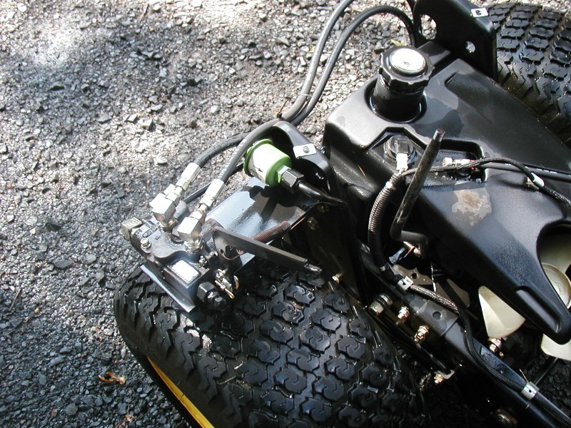

3. Still need a plow...Can you use the hyadraulics that lift the deck and reroute them to use with a hyaudralic plow

#3. If the deck raises with hydraulics, then i'm 95% sure the front blade will lift the same way.

Sorry, I haven't been on in awhile.
I can't find the paper work for my plow but that second pic looks just like it. And yes the hydraulic lift will lift the plow but you angle it manually from the seat, the angle kit was an option and works well/easy.
Mine is also to slow in reverse!! If you find a solution let me know. I'm sure it's for safety. Wonder if anything can be done with the lever linkage?
I also notice the valve under the fender for the lift gets pretty hot when running, don't know why only use the lift a couple of times during mowing.
