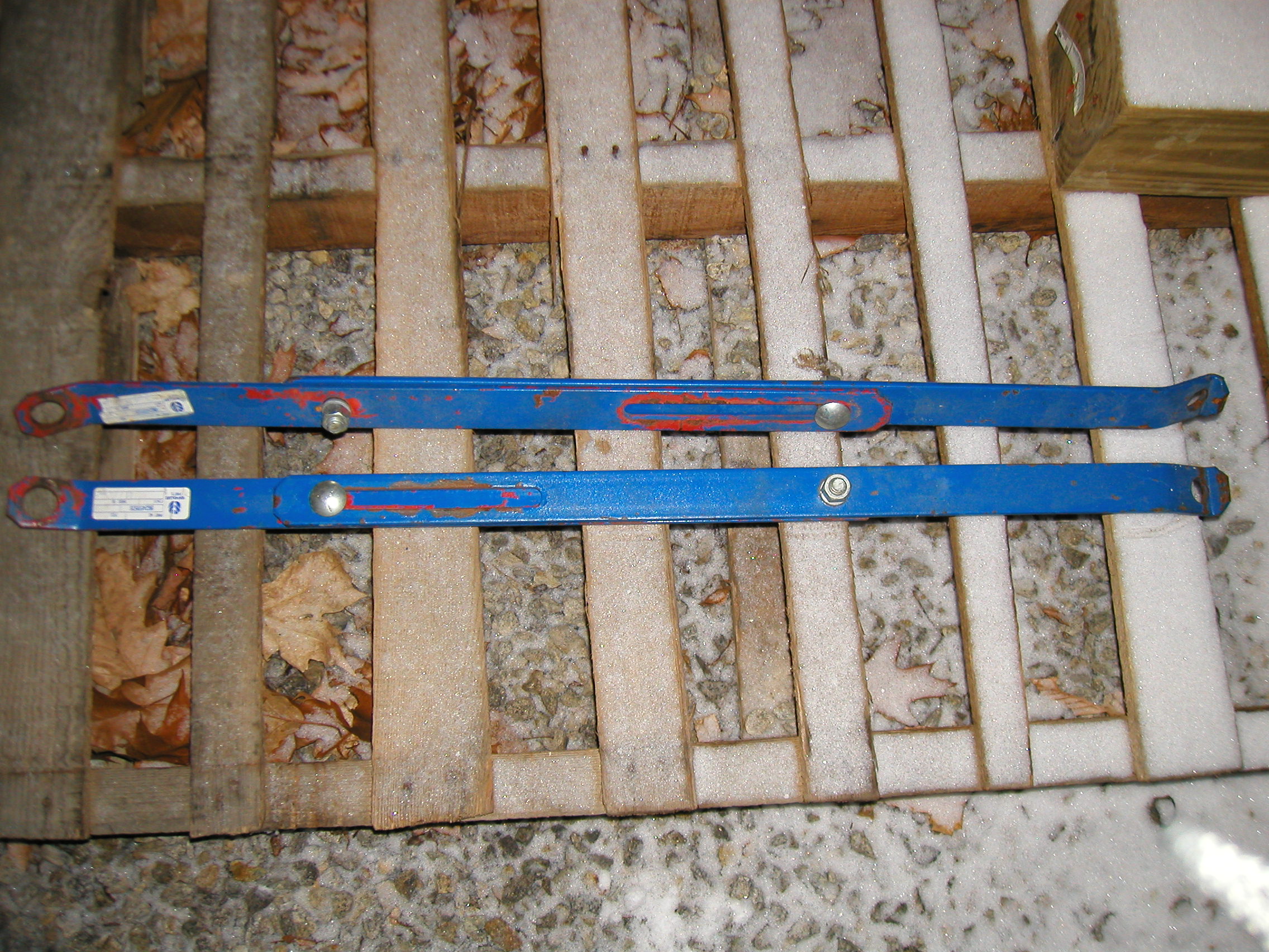

The old Ford 8N's etc used to have two supports going from the drawbar pins to the center link support so the drawbar could not come up.
Remember there is no DOWN force on the 3 ph, so if too much weight gets on the back of the trailer the tongue will come up using this arrangement.
/ 3038E Drawbar - Redneck Engineering #5
Here is what the support bars look like. These are NH, but they fit my JD just fine.
They are a must for preventing an upset. And they are easy to use and adjustable for any height. :)
Chuck
