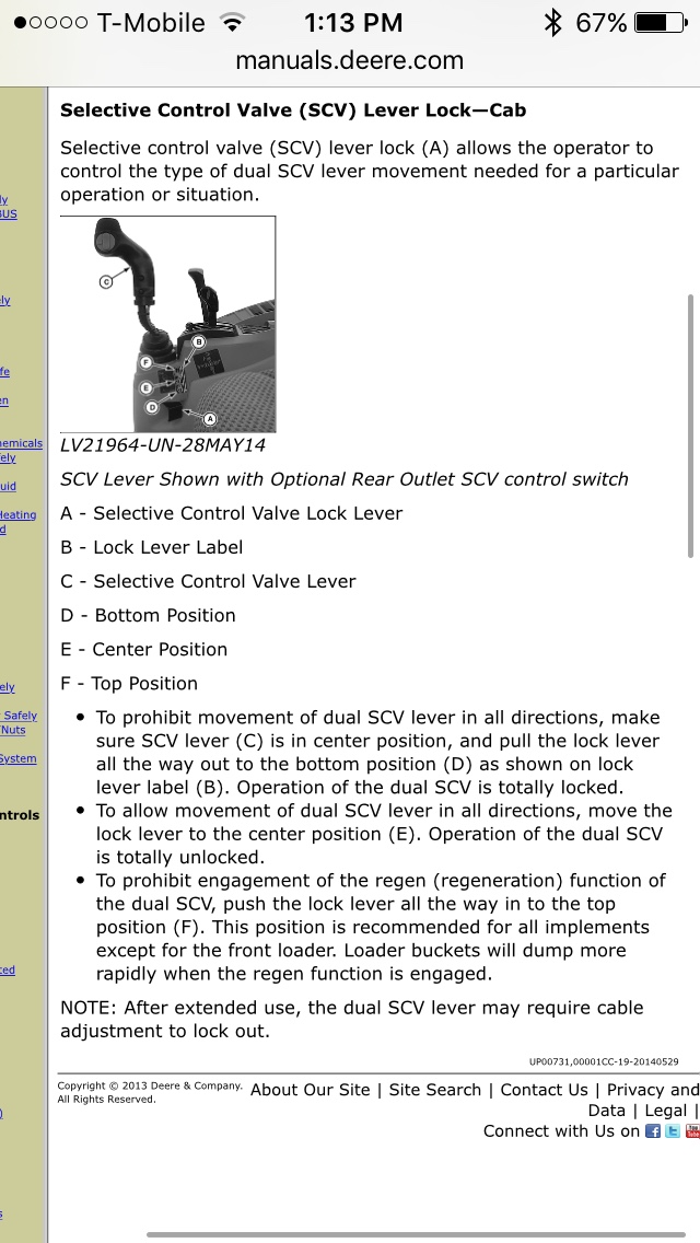

HAVE A 2016 3033 WITH H160 FEL. UP/DOWN TIME AND CURL TIME ARE FINE BUT WHEN I UNCURL THE BUCKET IT TAKES ITS TIME, ABOUT 7 SECONDS TO GO FROM FULL CURL TO FULL UNCURL. IF ANYONE HAS A SIMILAR SETUP COULD YOU TEST AND POST RESULT.

First, disconnect and reconnect the hyd lines to the FEL. Might just be a connector problem.
Are you familiar with the "regen" hydraulic system for the fast curl down ?
/ 3033 UNCURL TIME #3
Two things. Clean and reseat the two hydraulic quick couplers for the curl/dump circuit. If the problem persists, reverse the two hydraulic couplers for the curl/dump and see if the problem switches to the curl function.
/ 3033 UNCURL TIME #4
I don't think mine takes 7 seconds, not sure. I have the same tractor and loader. Read this and see if you locked out regeneration mode. IMG_4160.JPG
