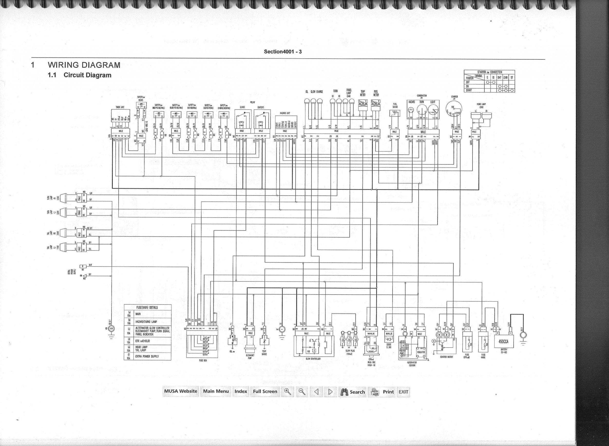

Here’s a wiring diagram for the Max which has an MHI S3L engine. When the key is turned to start, both coils are energized, when the key is released to run, the pull in coil drops out and the holding coil stays energized.
thank you for this
