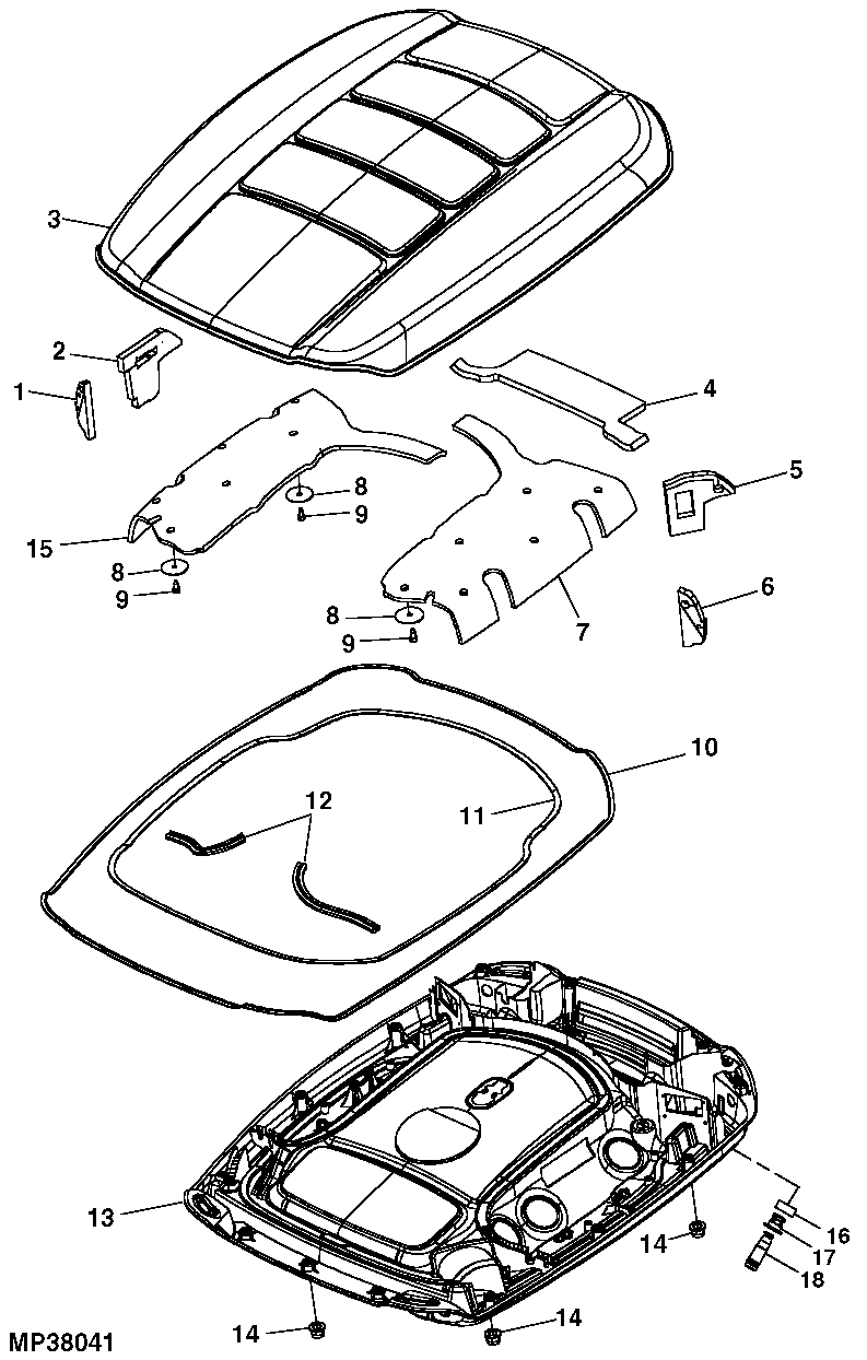

All, just for grins, which of these isolators and seals are you guys seeing that were defective/broken?
1 MIU10263 SEAL 1
2 MIU10444 SEAL
4 MIU10441 SEAL 1
5 MIU10443 SEAL 1
6 MIU10440 SEAL 1
7 MIU10570 SEAL 1
10 MIU10419 ISOLATOR 1
11 MIU10418 ISOLATOR 1
12 MIU10480 ISOLATOR 2
15 MIU10569 SEAL
   / 3000 Series A/C Issues #43
1 MIU10263 SEAL 1
2 MIU10444 SEAL
4 MIU10441 SEAL 1
5 MIU10443 SEAL 1
6 MIU10440 SEAL 1
7 MIU10570 SEAL 1
15 MIU10569 SEAL
Mine was tore on #10, and missing seal #11.

Minor???? Not to me.....Tell that to my dealer and Rep......they have spent about 40 hours on it, replaced freon twice, expansion valve twice and compressor once and it still doesn't cool. They have a new one on the lot that cools a few degrees cooler but nothing substantial.
   / 3000 Series A/C Issues #48
Have they replaced the cab seal?
