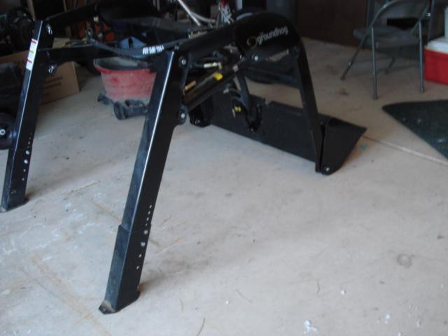

Here is the loader that I am getting.
Note I am buying the atv loader version and just simply putting the Cub Cadet feet and front stabilizers on it. You can get this at Concord equipment. This way I don't have to tie into my Cubs Hydros. It was going to cost me about $600 to get two more hydro circuits on my fender and that is just the part cost. Plus this 12v is stronger then our Cubs Hydros anyways.
This is a heck of a deal because they run about $2,400 new for this model as it is the 60" lift height version.
The best part is I can take this off my cub and put it on my friends four wheeler anytime.
Attached is the loader that I am getting. As you can see it is all self contained and everything stays with the loader when it is off the mower.

Well we got it mounted and man this is a nice addition to have. We had to fabricate the front mounts to the loader out of 1/2" x 1" steel. The O ring seals on the the pump reservoir are leaking a little and I will have to install some new ones. It is just to darn cold to do it now. Other then that this thing works great. I lifted 400 lbs with it no problem. I will post some photo's once it warms up and I can get this thing cleaned off a little. The only thing that I don't like is the loader pump is mounted about 3" away from my hood, so I cannot open my hood all the ways. Luckily the Cub 3000 has removable side panels, so I can get to most everything under the hood. The other option is to remove the loader which is not too bad either.

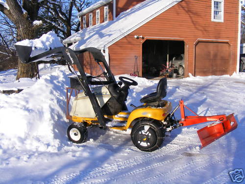

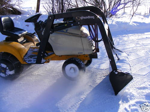

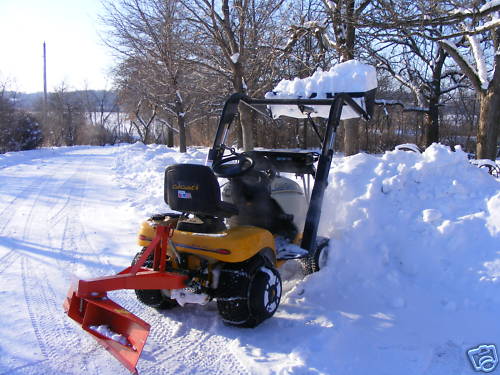

#19
Here are some links with my 3 point and loader. I also have it for sale on ebay right now. I found a good deal on a Sub Compact and need to sell mine to get it. Just after I got my loader on! If it does not sell I am pretty happy with is anyways, so it is no big deal.
It was -13 F when I made these videos, and the loader sill worked great.
CUB CADET 3184 MOWER W/ FRONT END LOADER 3 POINT HITCH - eBay (item 130357869862 end time Jan-16-10 14:16:49 PST)
Youtube video links
3 point
YouTube - Cub Cadet 3184 Fork Lift
YouTube - Cub Cadet 3184 3 point with Iron man Manufacturing blade
Loader
YouTube - Cub Cadet 3184 with groundhog loader part 1
YouTube - Cub Cadet 3184 Groundhog Loader video part 2
