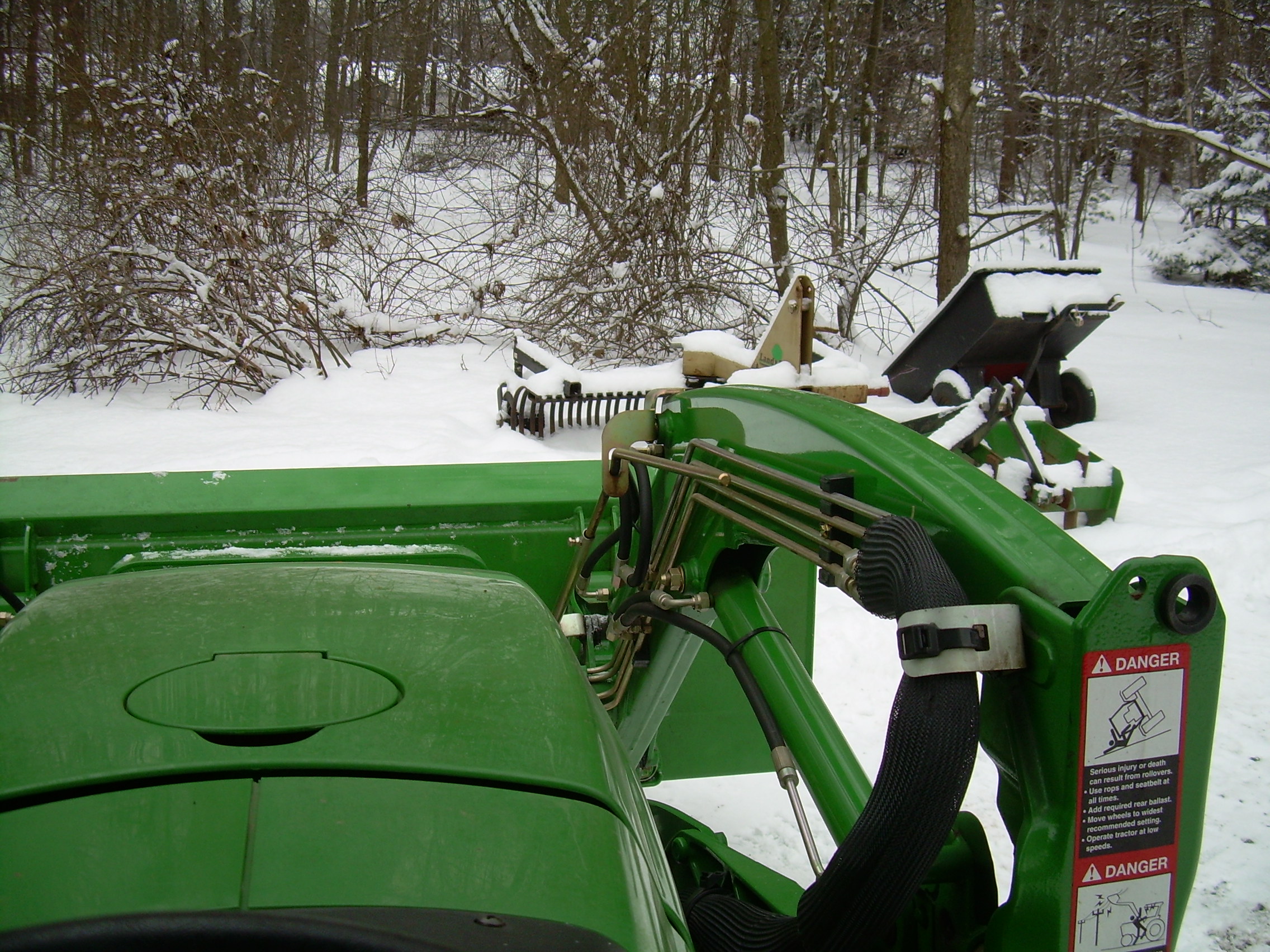

Does mine have everything it should?
This is on a 4310
JB

It looks like you have the bracket/tiewrap mentioned in the second paragraph of the first post.
Can't tell if you have the metal loop or not.
/ 300 CX hose supports #7
Yeah, looks like you have everything. Hard to tell about the loop, but if you have the tie wrap you probably have the loop as well.

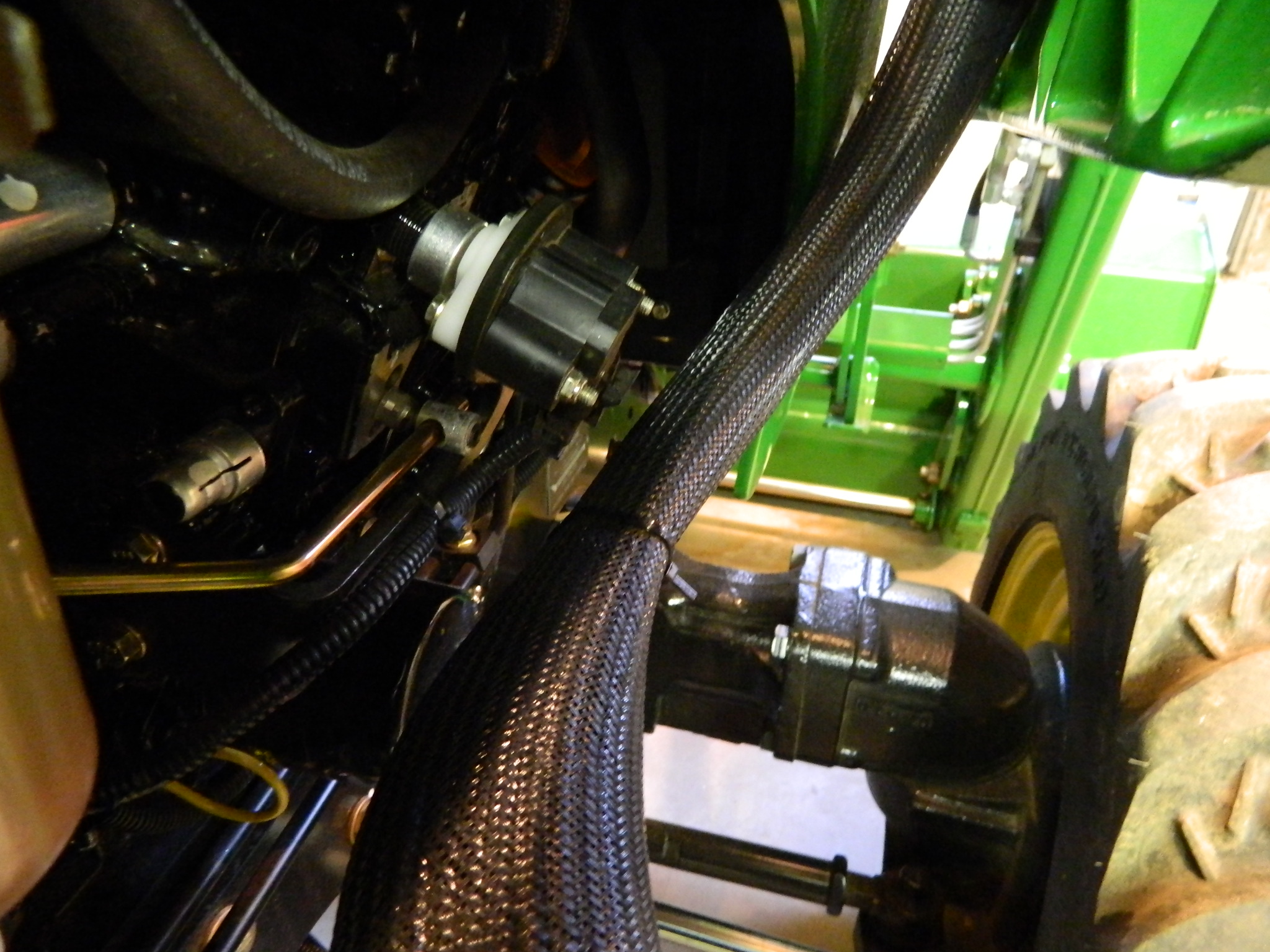

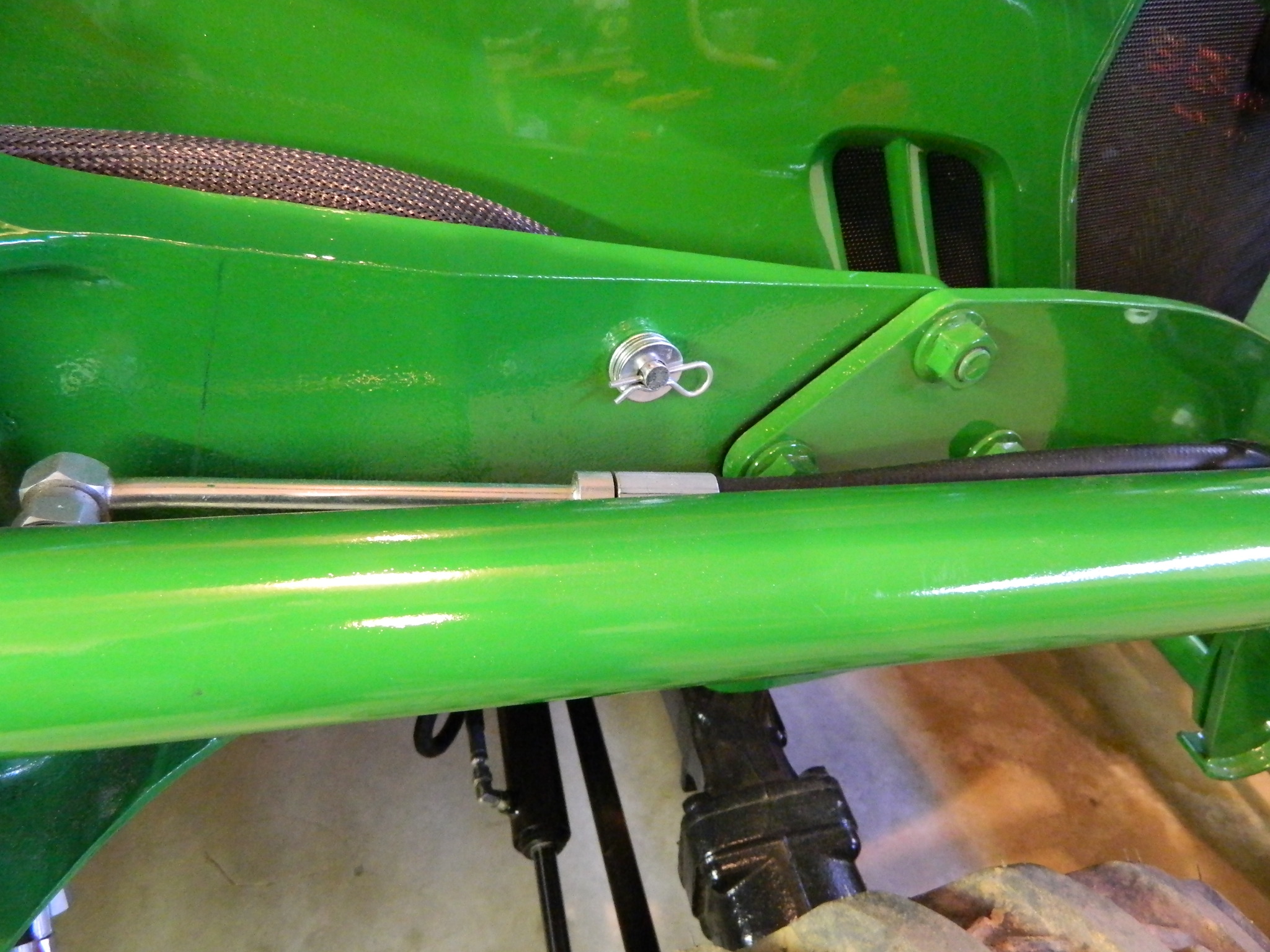

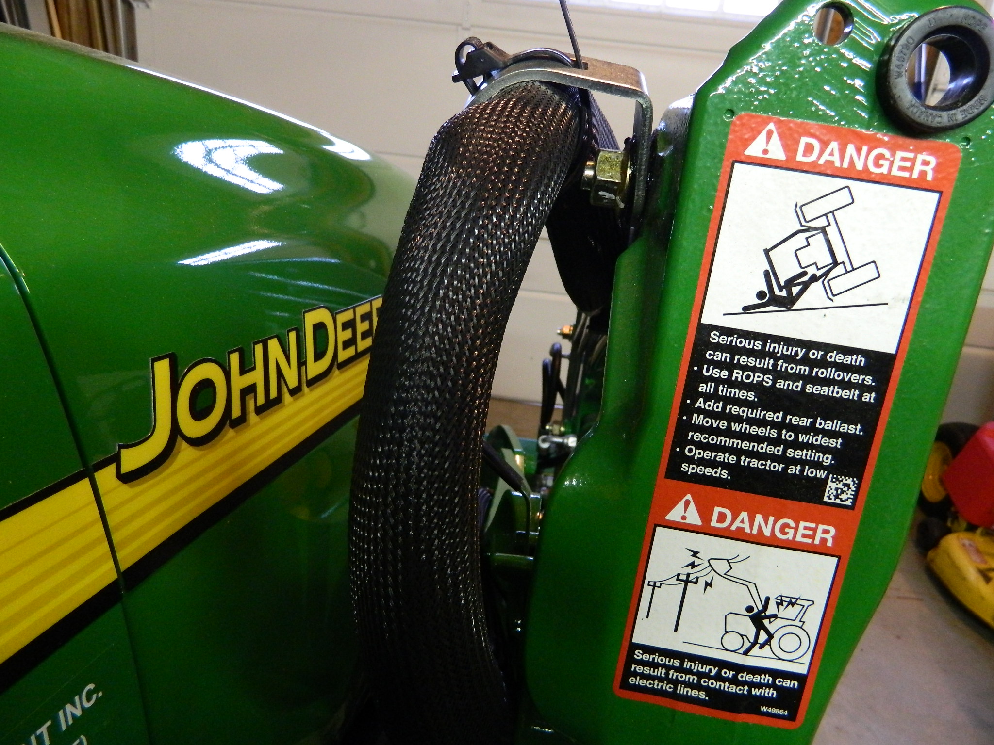

The hose routing on the 3320 has bugged me for 3 years. Why did engineering come up with 59 inch long hoses to travel 30 inches. Add some inches to make a loop at the mast and loader boom 'joint', maybe 10-15 inches and run the lines vertically up the left side of the mast...No interference with body work, solonoid on the injection pump, blocking dipstick and oil filter access, extra heat from the engine, and lines dragging on the right front tire.
Anyway, here's my latest attempt at controlling hose movement. If this doesn't work out my last option will be to make shorter hoses and go vertical.
Here's some points you will see in the pix.
1. Shimmed out the midmount pin by 3/8s thus pulling the hose bundle as tight as possible to the support bracket.
2. Added a tie wrap to the bundle to move it away from the injection pump solenoid.
Other guys have given the part numbers, I just supplied some pix.

My 3520 didn't have the hose support on the loader mast itself. I just made one myself by copying one on the dealers lot. It's just 3/16" x 2" with a 3/4" hole drilled through the short leg of the 90* bend. So it pivots with the loader arms just use a couple of washers that fit the hole, the flanged nut will hold it on and still keep everything tight. It really took the strain off of the hoses in that area. I think the original went into the dealers "extra parts" bin.:D The reason the hoses are so long is so you can hook the hoses up and have a little wiggle room when the loader is parked and you are rehooking.
