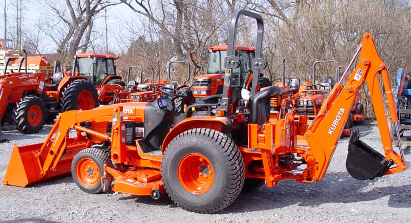

Do you have your ATI quick attach yet? Sure would like to see some pictures of it. What does it weigh? Can it actually use skid steer attachments with a 900 lbs FEL?

/ 30 HP Tractor...Which one???? #40
I don't have the ATI quick attach yet, I'm still waiting on the tractor. At the time I asked, they were in the process of designing the QA for the 403 loader so they weren't sure, but they felt confident it wouldn't weigh more than 80 lbs.
It should look similar to the attached. I'll post a picture of the actual thing once I have it.
