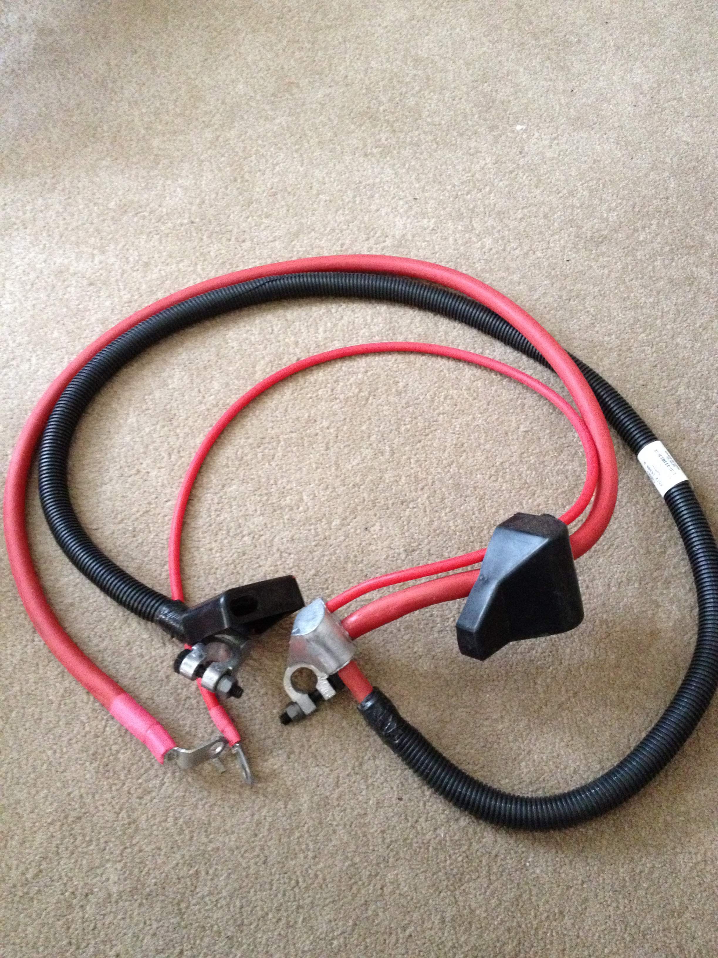

The new cable arrived today. Sure enough, big heavy duty sucker just like the original one on the old '97. But I suppose since a Ford parts place gave me the part number after getting my VIN & vehicle description it probably should be just like the original. :laughing:
The truck really does only get around 3k miles of seasonal use put on it every year. But I elected to listen to Chris & Brian and fix it hopefully once for many years to come.

BTW, here's the new truck cable:
