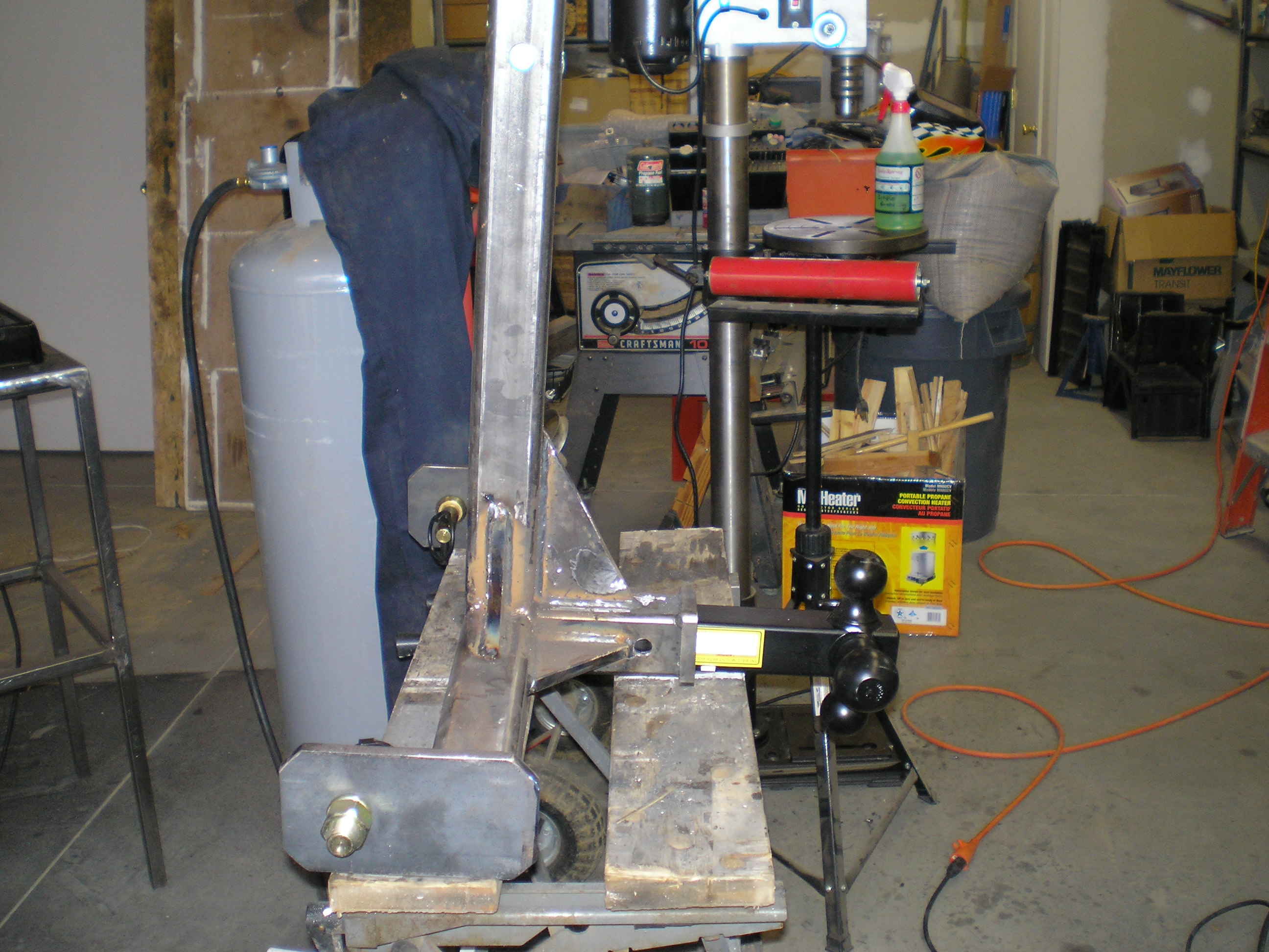

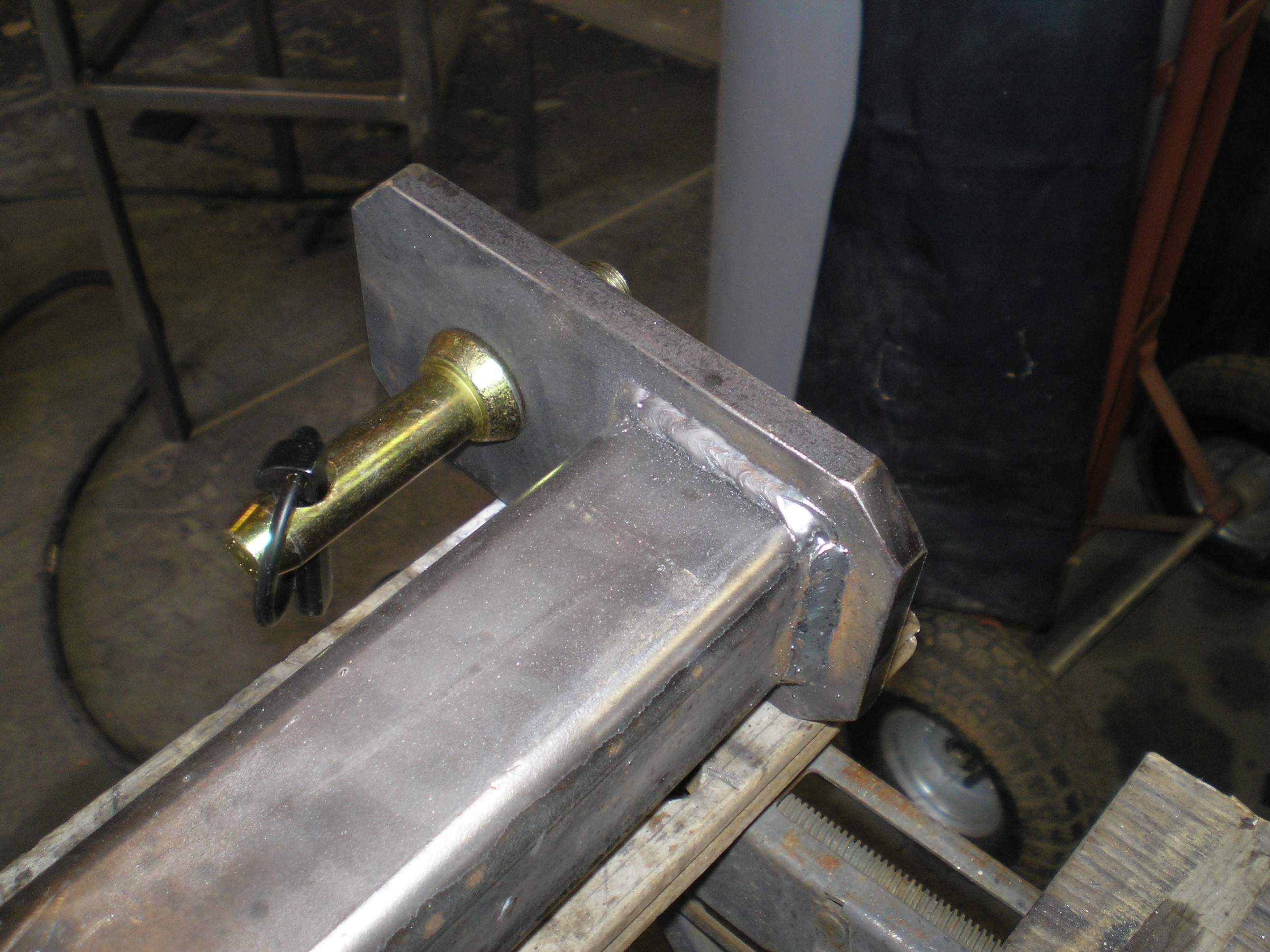

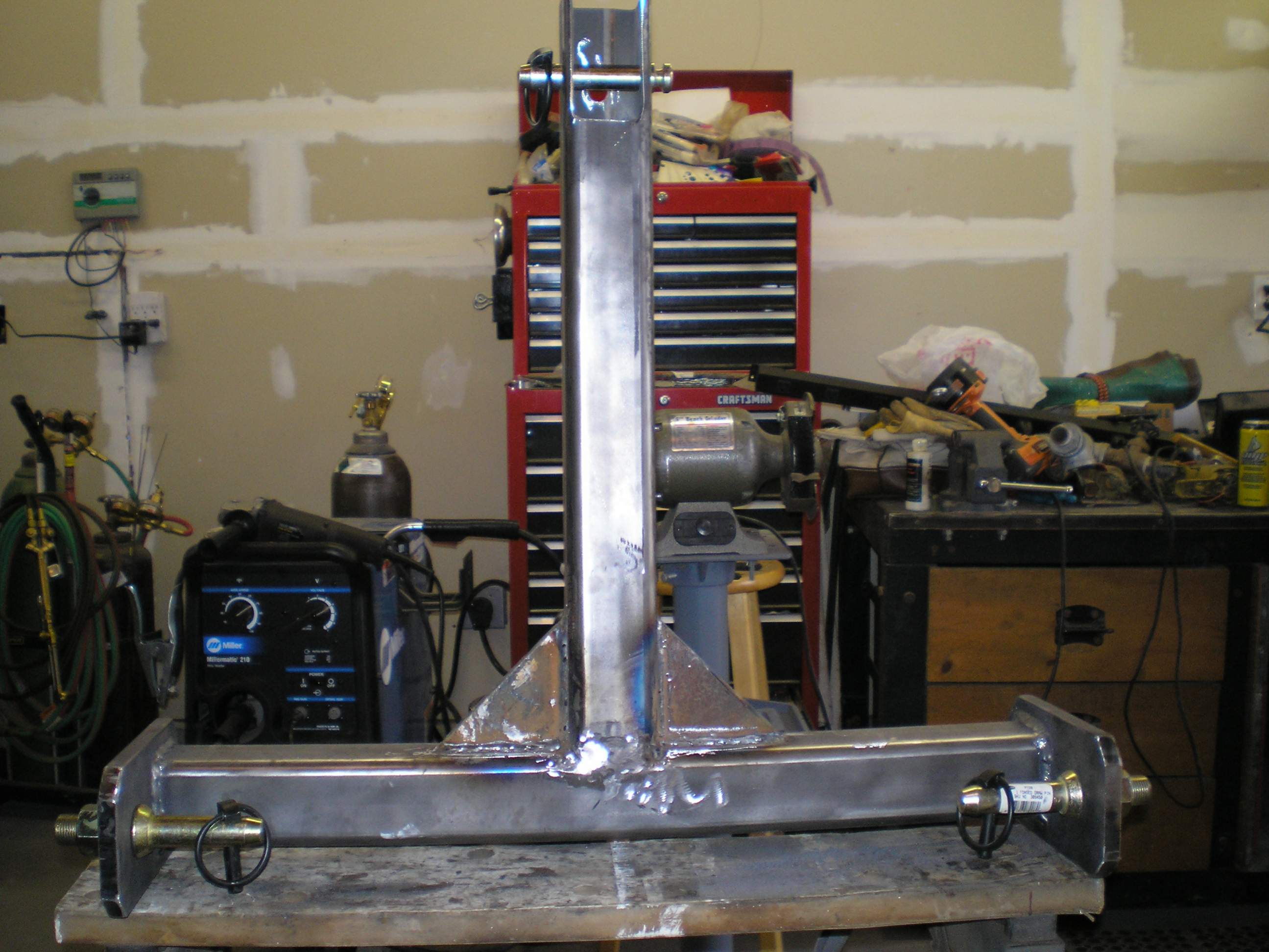

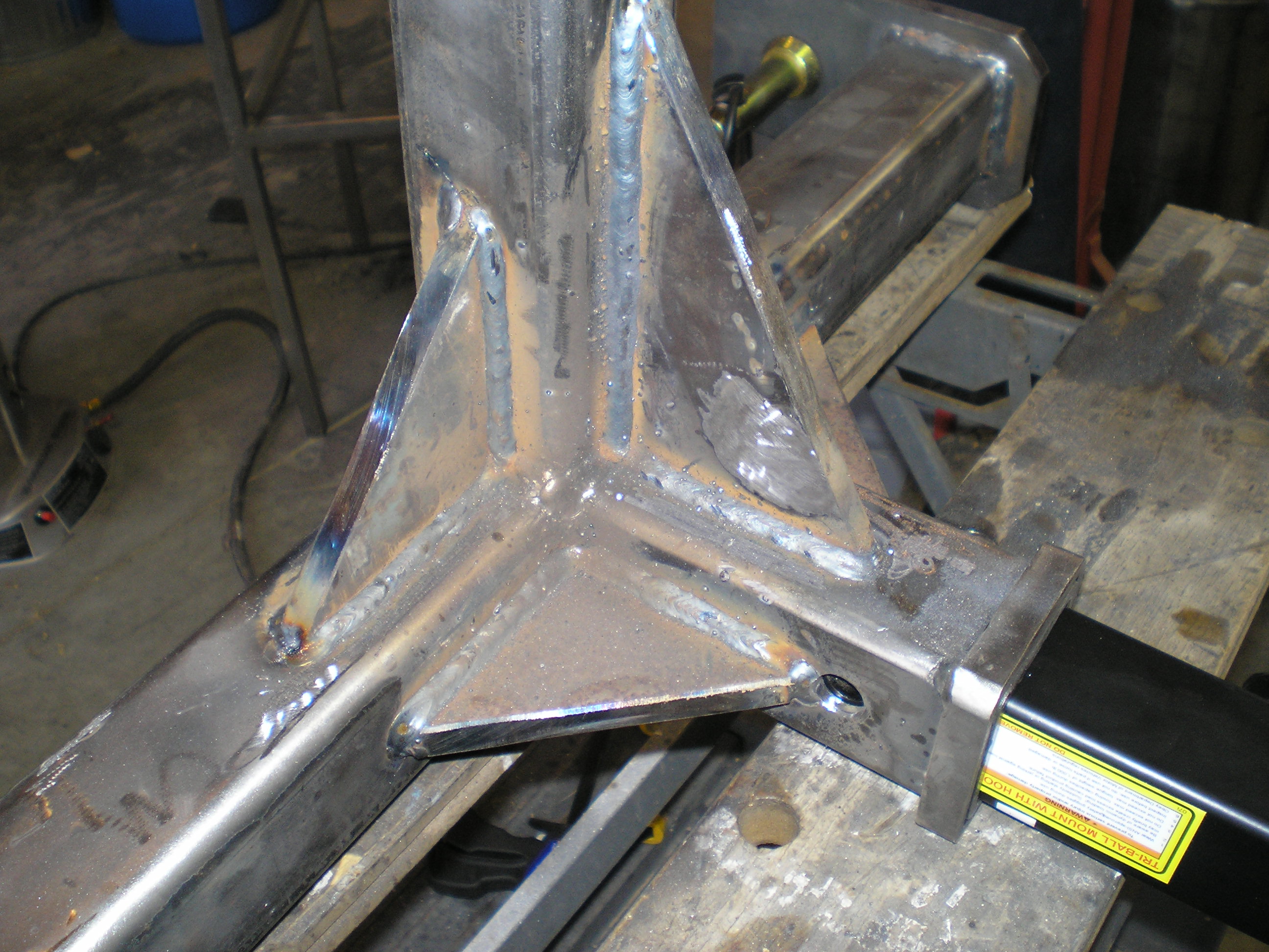

I finally found the round tuit I've been looking for and built this piece. I've been engineering the design in the back recesses of the brain for the past year. Started last Friday night and finished afternoon of the next day. Now to clean and paint.
The tubing is receiver hitch outer tubing purchased from Pacific Recycling here in Boise. The lift pin brackets are 4" X 3/8" plate. The receiver tube was purchased and welded to the horizontal cross member. With gussets all around for the upright and the receiver tube, I think this will be more than sufficient to move my boat and the 16' trailer I use to haul my Kubota BX 24. The stinger was on sale at Harbor Freight, and with the 3 ball sizes and hook for $26.00, the picture is complete.

Looks good, saved yourself some money, I bought one from Flex Point, forget how much but was not cheap.
Couple of suggestions before you paint it.
1) put some break away chain rings on the hitch side, I don't have them and wished I did.
2) You should have an attachment point on the front side towards tractor so you can have a limiter chain tied to the draw bar, preventing unwanted 3pt hitch over rise. I don't have that on mine and really need it. Since 3 pts don't have down pressure you can have trouble if you have negative tongue weight, for instance with my 5 ton dump trailer there is a great deal of upward pressure on the hitch when dumping heavy load before it all slides out.
also if you're going down hill and stop fast it could try and make the 3pt rise up and could possibly cause damage.

Thanks! I especially like the idea of the limiter chain, would have never thought of that. And it's good to hear from someone who's used one of these. I'd considered safety chain loops, but then decided not to include because my immediate use will be just moving two trailers around my 1.23 acre spread. But, I believe I'll take a lesson from your experience and add them now. I appreciate the feedback, that's what makes this forum so great.

You could pull a tank with that.Nice welds what mig and wire size do you use? Framer

Ah yes the drywall... The ceiling isn't up yet either. The fella that built the shop went a little light on electrical outlets and lighting, so I'm in the process of adding additional 20 amp circuits, more lighting and modifying the light switch layout to fit my work style. Also had to upgrade the electrical service from 100 -> 200 amp.
The welder is a Millermatic 210, if I remember correctly, the wire is .30 ER70S. Shielding gas is whatever is standard for steel - 70/30 I think.
This was my first major project with this welder, and I was pleased with it's performance. Great penetration - I know because I forgot to turn on the gas (there's that **** old-timer's disease) with the first weld I did and I had to grind it out. It probably would have done fine, but didn't want to take the chance.

Yes I should have complimented the very high quality looking welds, and I see you installed the link pins facing inwards, that's a different approach than all the ones I've seen.

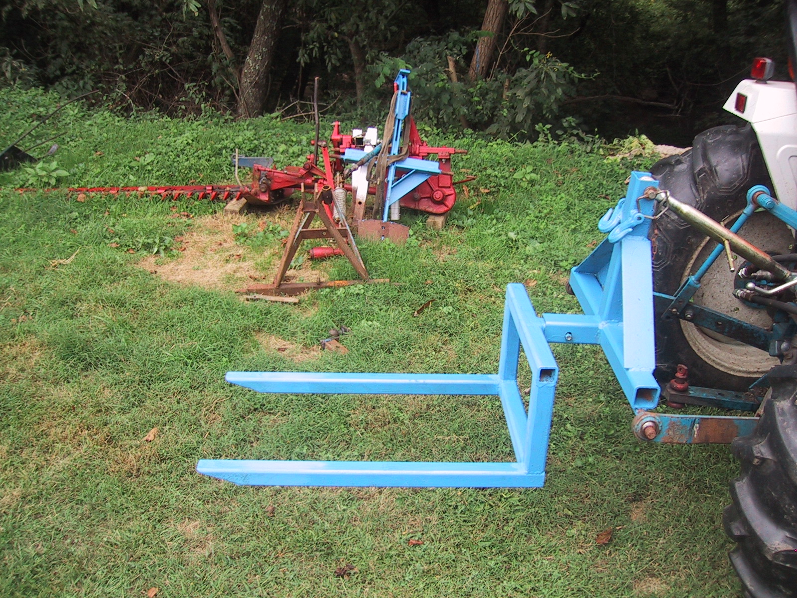

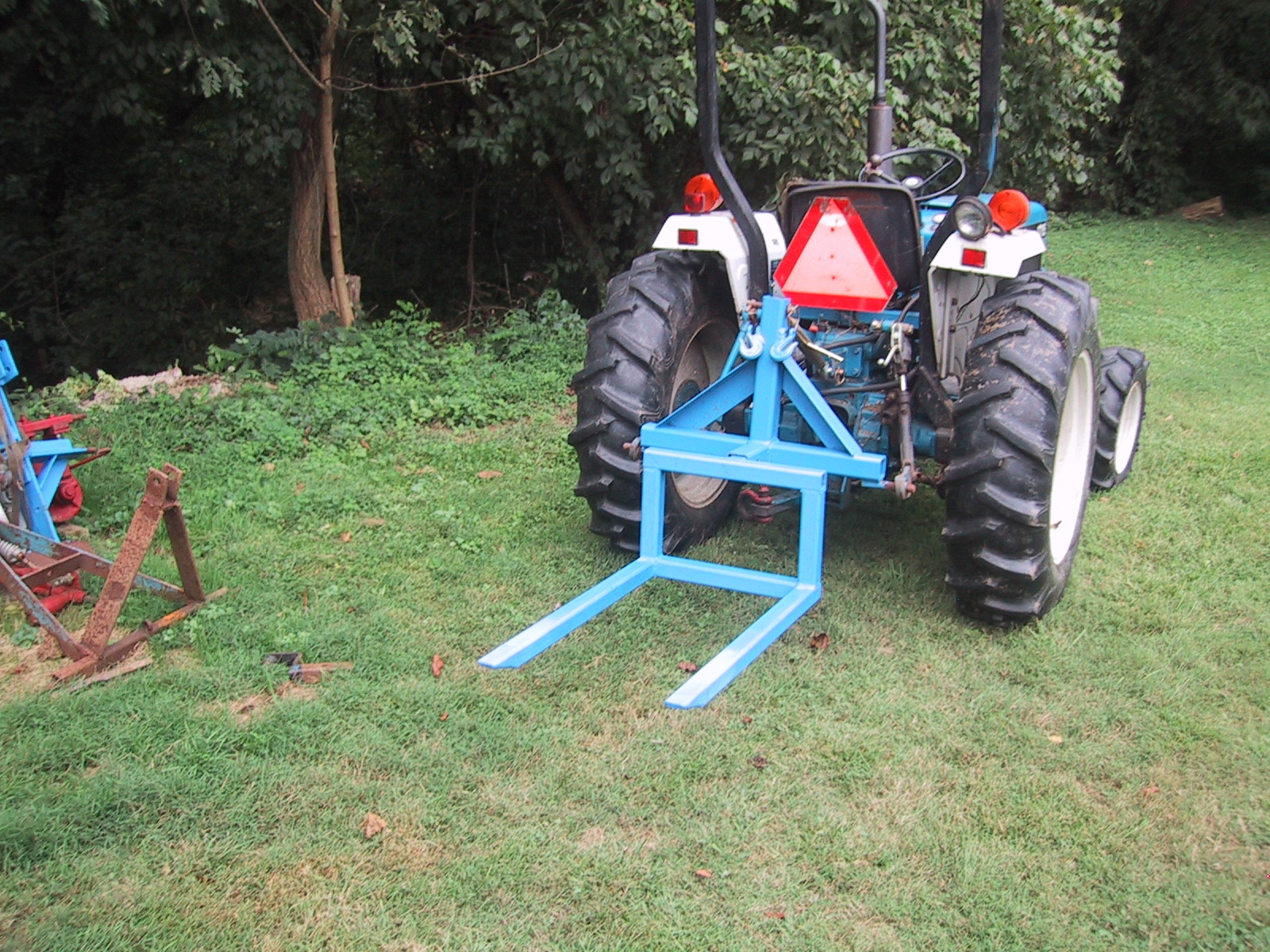

Here is one I made for my use. I use to pull post, pull logs, with forks, and to move trailers around.

Thanks for the compliment. When younger, I welded a lot - self taught on the farm, learned actual technique in HS Farm Shop. The Vo Ag instructure was a master welding teacher. Then did some non-certified structural welding as a laborer during college years - who knew there was a union scale for that???
This is my first welding effort in, oh, 35 years maybe? I did a lot of prep work on the joints before the weld, beveled, clean, square, did the alignment with magnetic clamps, tacked, removed the clamps and did the primary welds.
The width of the horizontal member is 26" - standard class 1 TPH width. The pins of course could go either way, I just faced them inwards to keep them out of the way so I don't catch a toe on one of them and add yet another lump bump and scar to this ole' bod.
I noticed the forks you have, are they made from 2 x 2 stock?

Ken, your hitch looks good. I think every tractor owner needs one if dealing with trailers on his property. I have about 6, one for about every need and find it much easier to move them around with the tractor, especially if doing work around my 5 acres. Cutting grass is easier when moving trailers with tractor.
I did not put safety chain hooks/rings on mine. Didn't see the need just working off road. The restraining chain sounds good if you are going to use it with dumping but most trailers have enough tongue weight not to need that either. I try to keep it simple.
I built my first one from scratch like you did, used 3" x 1/4" tubing. I have even moved small (12X 40) mobile homes with a 70 HP tractor and a 2 5/16 ball. I later built one that is lighter using a piece of 2 1/2" x 1/4" angle iron for the main spread then putting a 2" tubing upright and a mobile home spring hanger bracket (drilled out bigger) for the top link reciever bracket. Butt weld the reciever tube and weld on the lift arm pins, light weight but strong enough to move a loaded 5' x 10' trailer.
A friend owns a welding shop and gets reciever style hitches from a car dealer that takes them off prior to sending cars/trucks to auction. He sells them to me for 5 bucks each, cheaper than the factory reciever tube, add pins, upright and bracket for top link and in 30 min I can have a new hitch. It sure beats the 150.00 or so they sell for.
After using it for just trailers, I built 3 rakes, (root rake using teeth from a box blade, hay rake from old mule drawn rake and section harrow, bought teeth for 59 cents each) that attatch to tractor using my "reese hitch". I already bought the teeth to build a leaf/pinestraw rake using hay rake teeth and I will use the reciever hitch for that as well. No need to build the 3ph on the rake, just slide it in the reciever. Another simple build. I made an upright boom pole leaning about 30 degrees out, 2' long, to drag trees with, shorter so it will pick up more weight, a fence wire bracket to hold a roll of wire, use it with a pickup "carry all", and even slid a hitch in it , backed up to my yanmar that had been sitting and pulled it in the shop like a wrecker using my Ferguson as the towing tractor. The front weight bracket served perfect as my front hitch to pick up with a trailer ball. I have a rig built to carry my acetylene torch with a boom truck (no wheels) and plan on adding a piece of tubing to it to carry my torch from same hitch with tractor. No forks yet but thay are coming.
The little reciever hitch you have built will work for all kinds of applications. Just slide in a piece of tubing and build it from there.
The only thing I did to my heavy one that you haven't added to yours was a piece of 2" flat bar about a foot long standing straight up from the reciever tube to the top link upright. I thought it would brace the two against each other. Must have worked, mobile homes did not bend it. That brace was brought out about 3 inches and leaned into upright.

They are 1 1/2 Outside square stock, Is about 3/8 wall. Only use to move small pallets around, as my tractor won't pickup large pallets. lifting weight at end of drawbars is about 1600 LBS so will pick up about 1000 LBS. Is still handy to move things around like small buildings on skids just stick under one end wrap chain around and go.

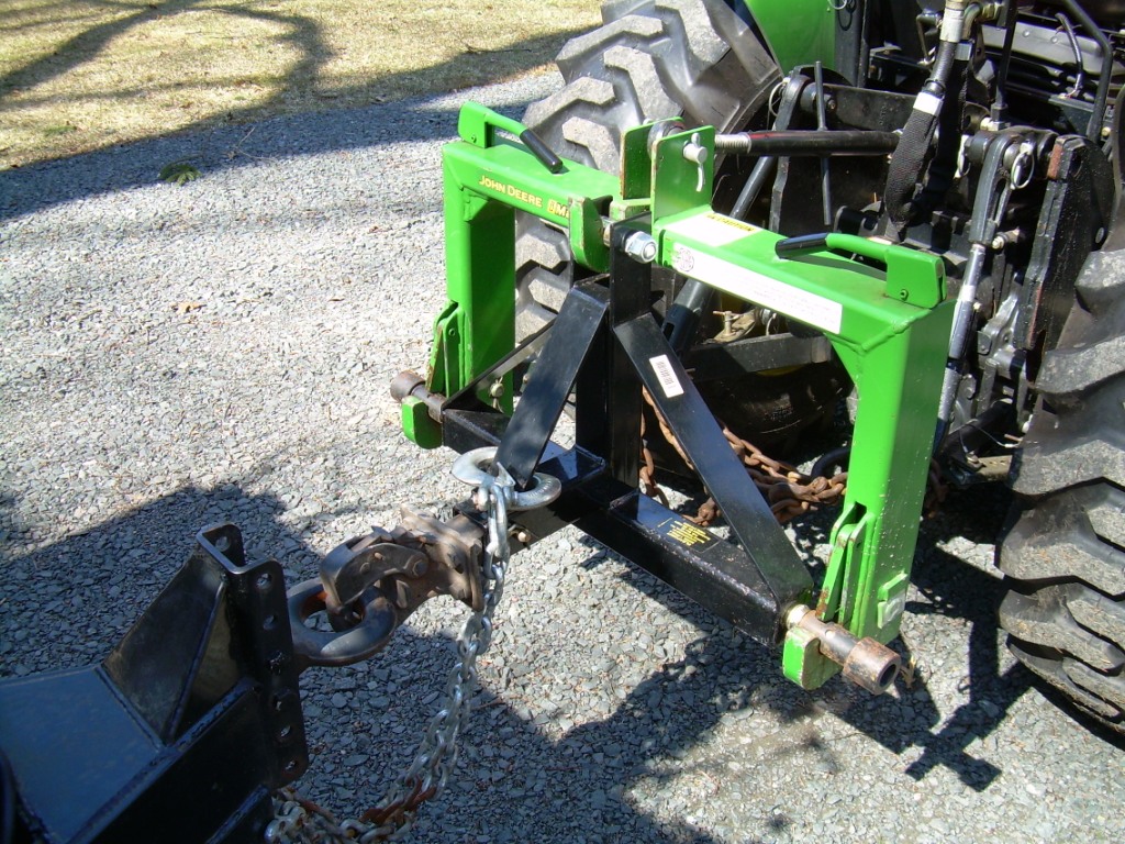

Check out my receiver hitch. Just click the link below.

Nicely done! Looks like you've built a couple of different versions of the front hitch?
How much vertical travel do you get with the front hitch?

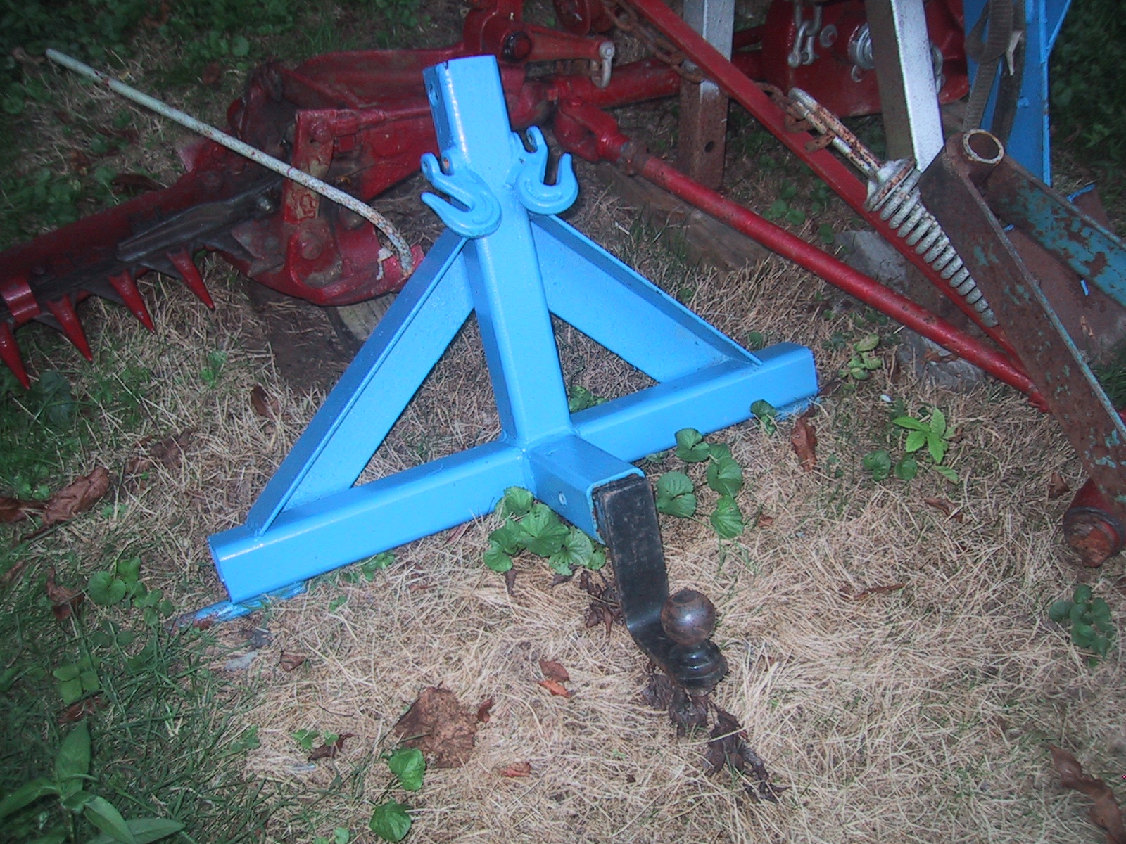

Waking this thread back up to post pics of the finished product.
Following feedback from forum members, I added a D-ring for a hold down chain-to-the-drawbar to keep the thing from rising unexpectedly. I decided not to include rings for safety chains as I'll just be using this to move my boat and landscape trailer in and out of parking places, no road travel.
I had to wait a while for the temps to warm up enough to paint. Soooo, after 2 primer coats and some number of color coats (Kubota Bright Orange), here's the final deal, bright and shiny to match the tractor (BX24).

I like the pins facing inward. On my brush hog I changed them to face that was as brush would unsnap the lynch pins and let the drawbar loose. With them inward and the sway links tightened even without lynch pins it won't get free.
