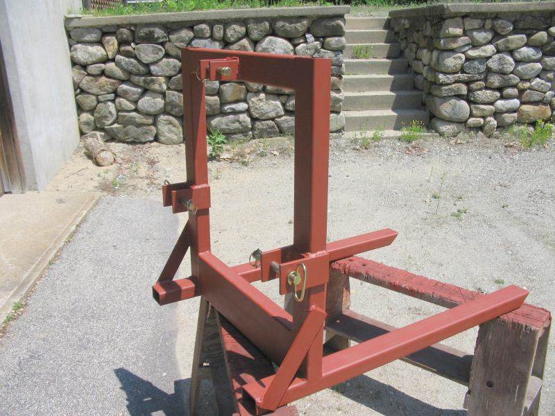

Here is a picture of a 3pt carry-all that I built for a friend. It was designed to carry 1500-2000 lbs. The basic design was taken from the standard light duty carry-alls but the steel used is quite a bit heavier. There is a post somewhere in the Build-it Yourself forum with more pictures.
The frame and forks are 3" x 2" x 3/16" rectangle steel. The bottom frame piece is 6" x 2" x 1/8" rectangle. The tabs for the lift pins are 3" x 3/8" flat bar and the diagonals and top link tabs are 2" x 3/8" flat bar.
