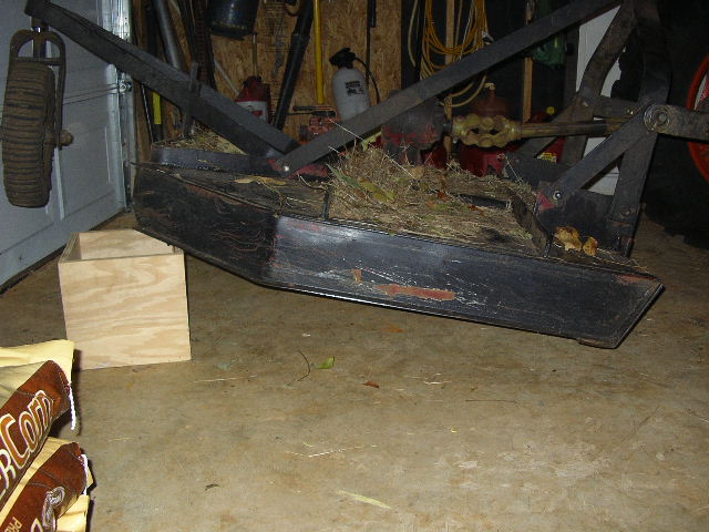

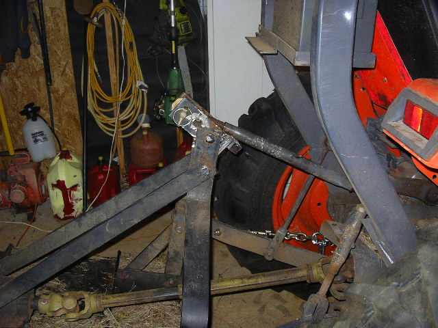

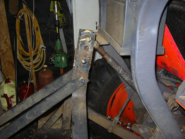

It seems most of the newer BH's have or have an option for a movable top link. The previous owner had welded mine together, I fixed it...

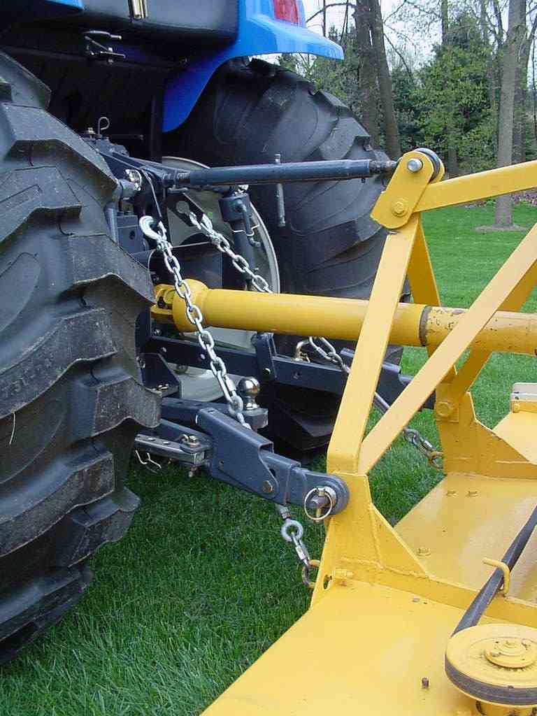

If you want some improved following of the terrain, you may want to try "check chains". See the pic attached.

I've read several posts about using check chains and I still don't get it.:confused:
Correct me if I'm wrong, but don't check chains keep the front of the mower at a constant position relative to the tractor rear end? Same as the 3pt lower lift arms with the top link hooked up? Unless you have 3pt leak down, I see it as being a redundant feature. The front of the mower can't go down any further in relation to the tractor with or without check chains if the 3pt doesn't leak down and stays where you put it. The 3 connecting points of the 3pt form a triangle which if set, and can't leak down, it does not allow a change in geometry or position of the front of the mower in relation to the tractor rear.
I can see them letting the front of the mower raise up, but the 3pt can do that too since it floats up, but not down. So even if you use the check chains and then lower the 3pt all the way, you get no addition benefit as if you set the 3pt at that position.
I don't get it, but I'm probably missing something. Can somebody explain the added feature? Is it so you don't have to set the bottom position to the same place every time? So that you hit the same level when lowering the 3pt then? What if you come to a spot where you actually want the front to be lower than where you set the check chain length?
I can see a floating top link or swivel bar or even a chain there to allow the rear wheel to remain in contact with the ground, but I don't get what extra feature the check chains have over the 3pt unless it's just the convenience of set height.
Bingo!
Rob, I use check chains for my BH because I don't have position control for my 3pt. It allows me to raise the 3pt and lower it back to right where I want it without having to fiddle around with the 1/4" handle.
If I come to an area where I want the front to be lower I usually try and mow that area in a differant direction... like say running across a small ditch..... then running parallel up the ditch.
If I had position control then I don't see the need for check chains.
Same here. The last time this came up I was scratching my head, too. The only time I've seen "check chains" used is with implements that can put high torsional loads on the 3pt., ex. my boom flail mower uses them.

the smaller Kubotas have what they call a 1/4" Valve, it looks like this, in my opinion it is better than no 3pt but not much. I always snag it on my FIL's B7500 when I am driving.

Ahhh,
I didn't know that.
Mine does have it so I was thinking the same as bjcsc noted. I just assumed all tractors had position control ... shows how much I know.:)
Anyway, that's why I asked the question.
Thanks.
