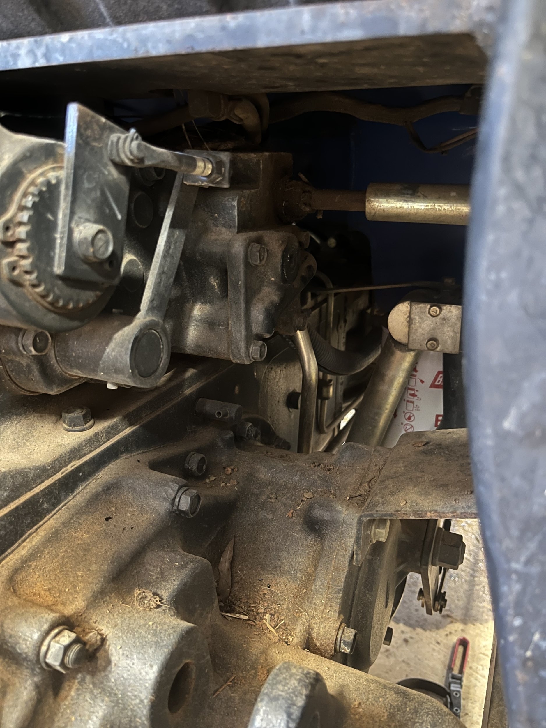

2003 new holland tc 33
Have a tc33 and the 3pt lever is seized. Any insight, have had the tractor for 20 years and never has happened?

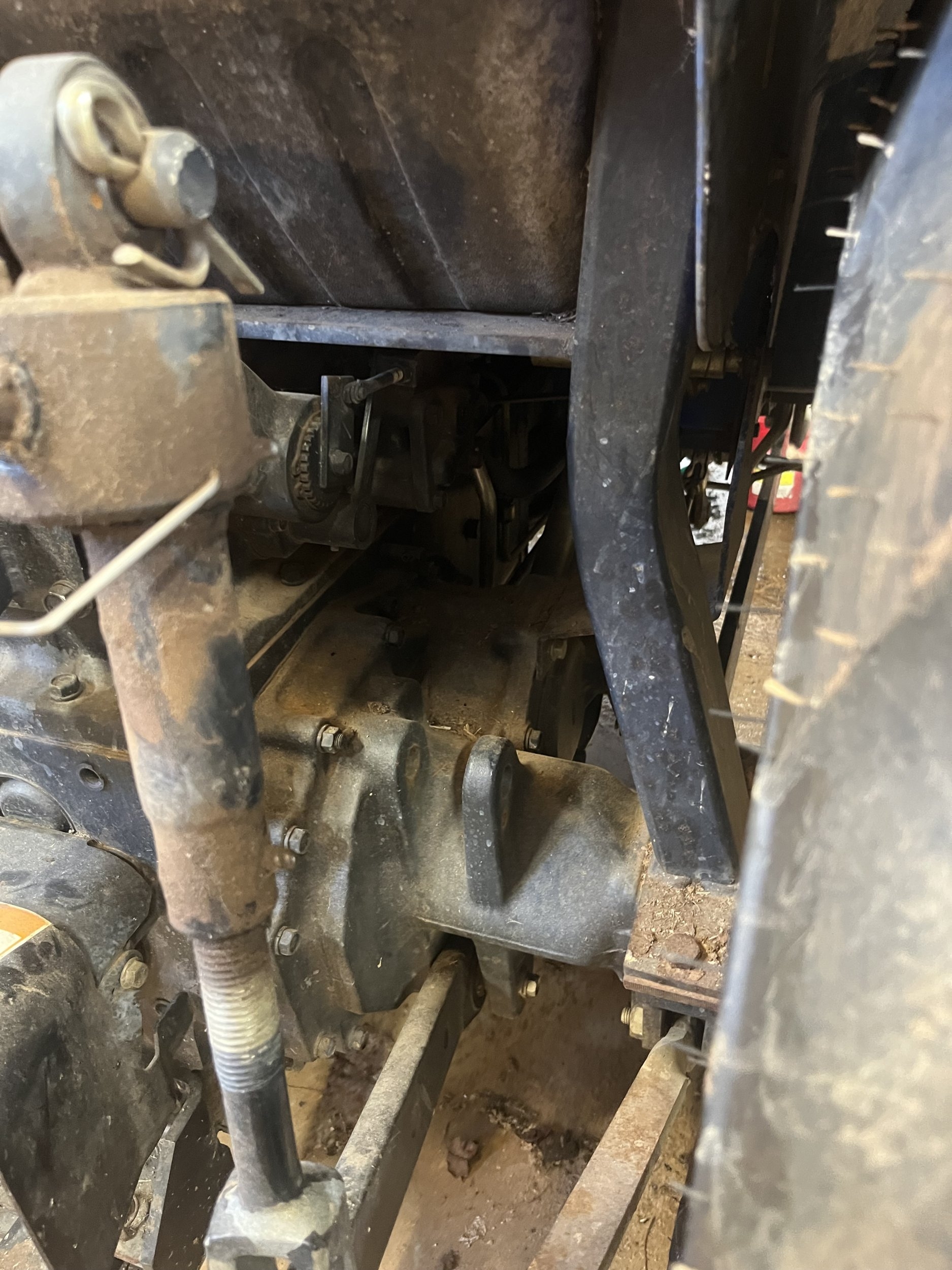

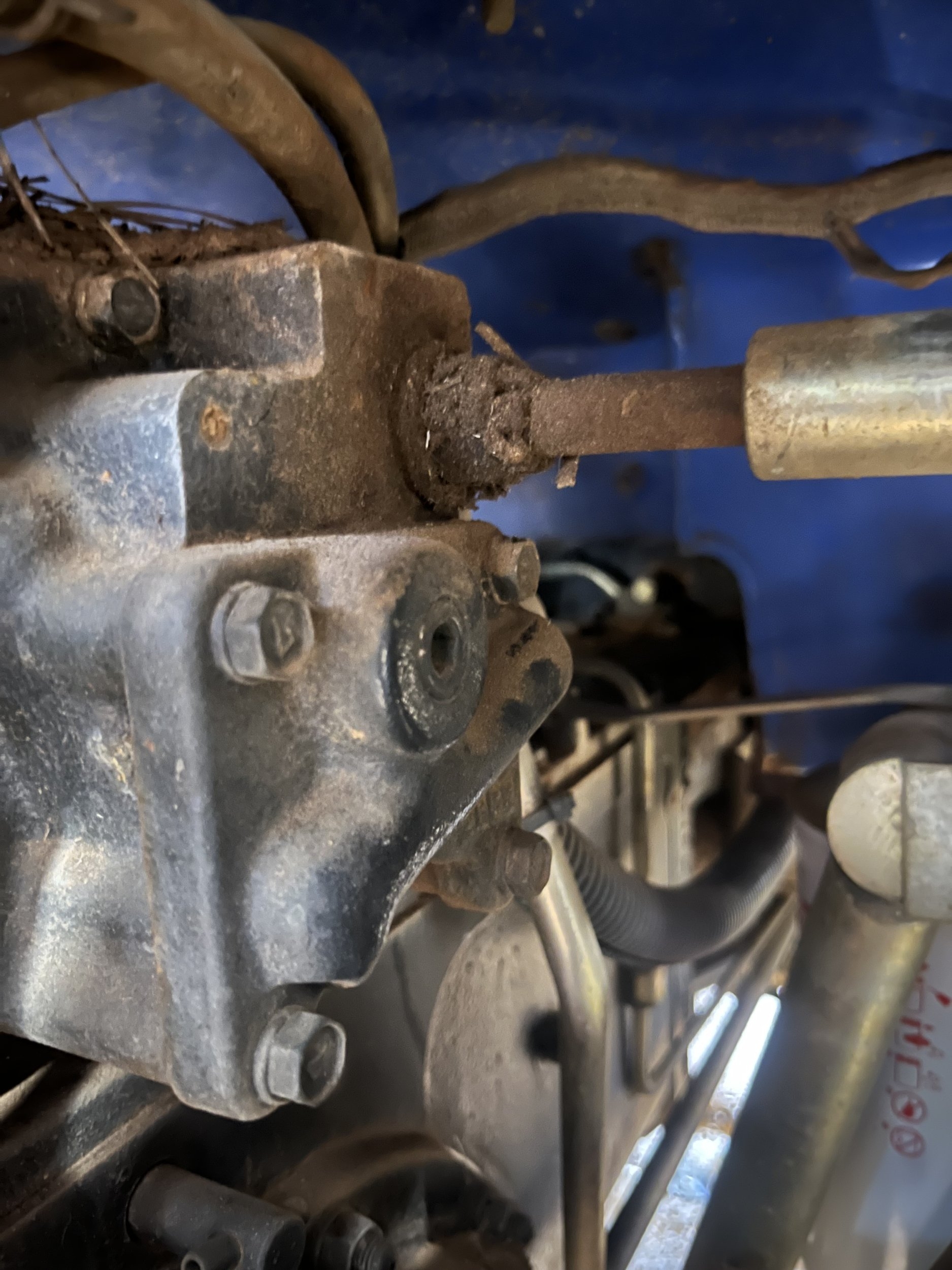

I don’t know if this is your problem or not, but the castle nut for the 3 point position control lever can be loosen to make it easier to move.
I can try to get a picture of the castle nut later.
/ 3 PT lever seized #3
Castle nut
I pulled the cotter pin from the rear and loosened the castle nut a bit maybe one or two slots and now mine moved freely.
With yours being stuck you might have to pull the linkage apart and lube it and loosen the castle nut.
