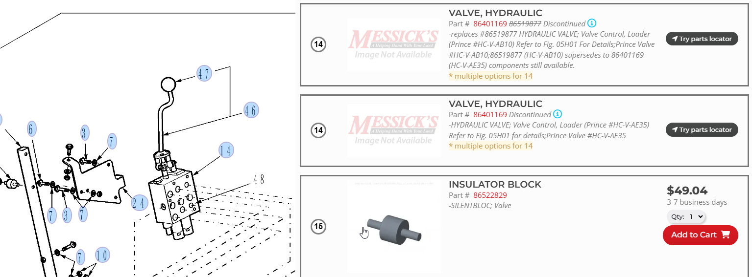

Like others have said I would disconnect, clean, and reconnect the lines. If it persists, I would swap the lines to determine if it is the valve or some other issue such as a bad hydraulic line or cylinder. It looks like the valve is not serviceable and NH has discontinued the valve, but maybe Messick's has another source if it is the valve. That valve fits 19 models so you might also find one in a tractor salvage yard.

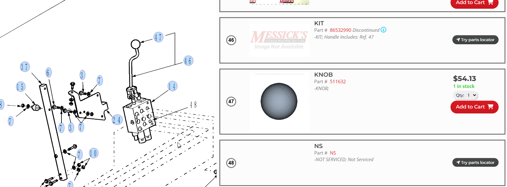

Good news is the valve for the TC45DA is still available, Messick's has 1 in stock. Bad news is it is $1201.96. The valve can be rebuilt according to the parts diagram, there was a complete kit available at one time. Some of the individual parts are still available.
/ 7308 Loader Problem #14
Yes the TC45DA is available I just bought one this year.
When I replaced it I asked about the repair kit but it is the detent parts. If the valve spool(s) or body is worn it’s replacement valve time.
