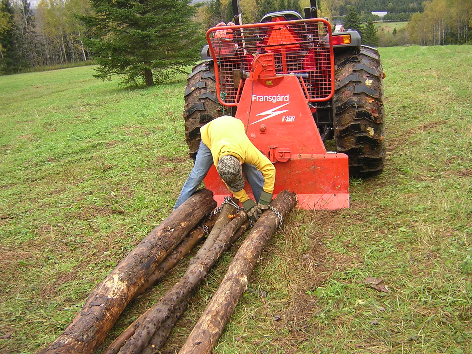

I had a 30 hp kubota and bought a Fransgard V-3507. I now use it on a 40 hp Mahindra. I love it. DSCN8279.JPG
Dan.

Boy, that is a beautiful scene, but reminds me of what's to come... wet boots, cold nose, frozen fuel lines, and jumper cables :cool: ....But on the plus side, I'm looking forward to no bugs :thumbsup:
You said it. I've noticed that Gordon has a knack for taking picturesque photos that look like they belong on a woodsman's calender. Really makes me want a winch, too!
-Jim
