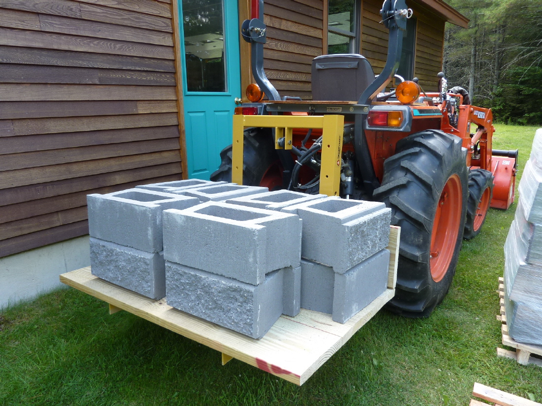

I recommend a set of 3PH pallet forks. They would be way more versatile. You can stack the wood on pallets and move it easily. You can build a custom skid to haul your chain saw and tools. I have a old tool box off a truck I throw on my forks to haul the saw and mauls in sometimes.

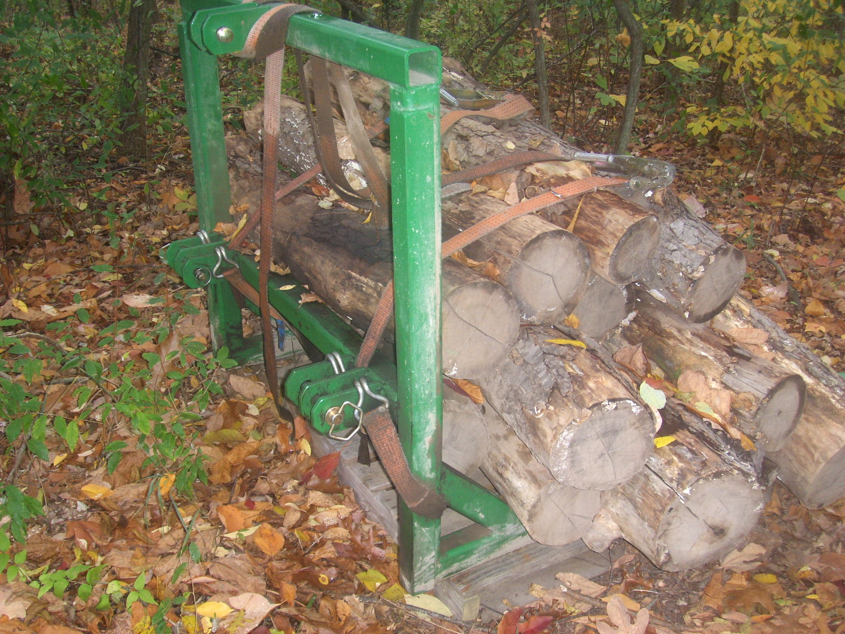

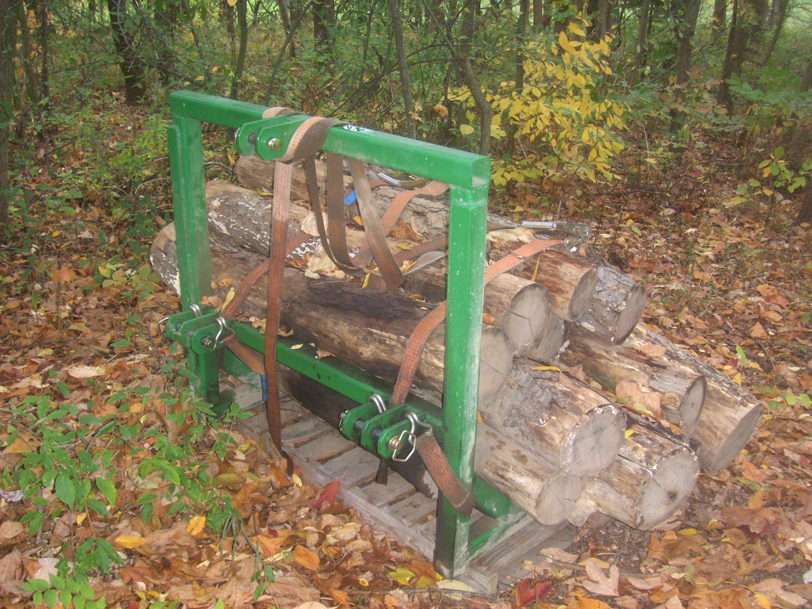

I built this one, mostly to haul wood. Use a QH so it's easy to sit down in the shop full of wood.
Survived my shop fire and still in use.

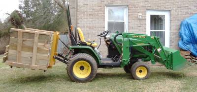

   / 3 pt hitch carrier pictures #6
Just buy a Carryall at TSC or on line and put a pallet on the bottom of it. Thanks what I did, but I also affixed sides to mine. For what you're doing, you probably don't need sides.
Ralph

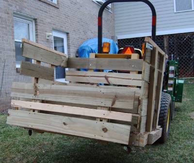

I bought at auction. Home made (not by me). Made out 2 1/2 x 2 1/2 x 1/4" wall tubing. The bottom fork tubes were heavily rusted fro setting on the ground. I welded 1/4" flat stock to them. The uprights were bowed from carrying something too heavy. I had some 2 x2 x 3/8 angle iron that I clamped on with C clamps and got most of the bow out then welded them on. The pin holes were all 1/2". I drilled them bigger and got some hitch pins from TSC. The lower ones I had add bushing to get to CAT2 (I did not have a big enough drill). Then finally painted with a rattle can of JD green.

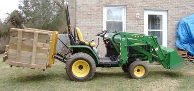

I built one out of 1.5x4 steel tube and used extruded metal on the bottom and sides. Originally was going to use it to carry a salt/sand spreader, but never ended up using it.

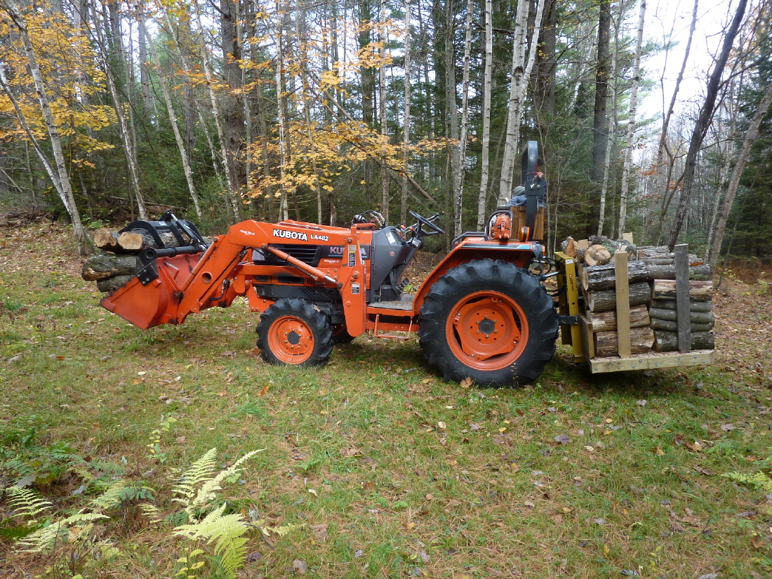

I made a big one that could carry two face cord of dry wood, and over one face cord of green hard maple/beech. Limited by if I am going to be going up/down hills, on side hills, and how much contact I want my front wheels to have with the ground. It is on the big side, but comes in handy for hauling brush/branches/ladders, wood cutting tools,etc.
http://www.tractorbynet.com/forums/attachments/156334-firewood-carrier.html
