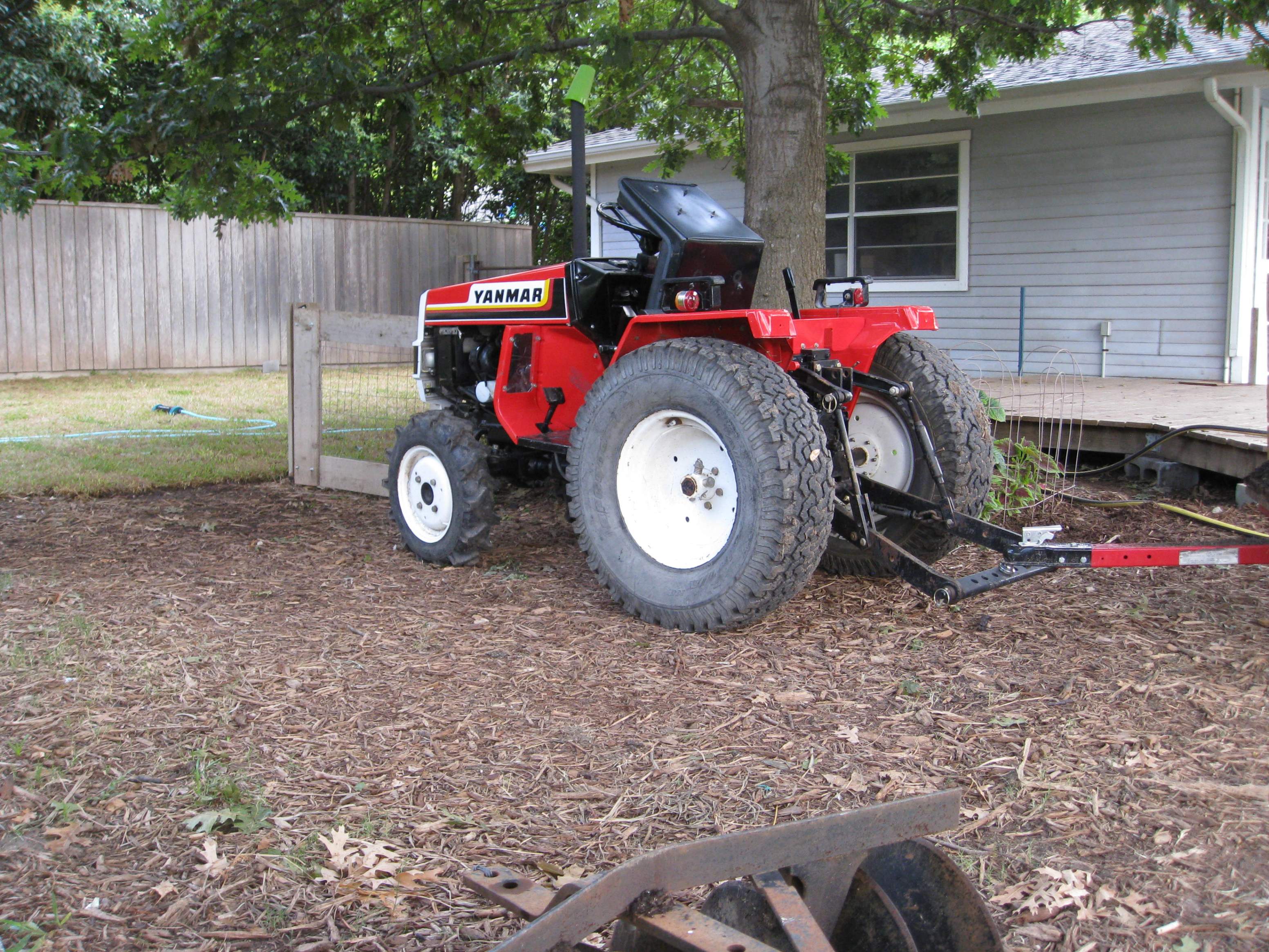

Hey Bob, hopefully if I do this right, here are some pics of the truck/SUV tires on my F13D. You can see they give it a little wider stance than the ag tires that came on it.

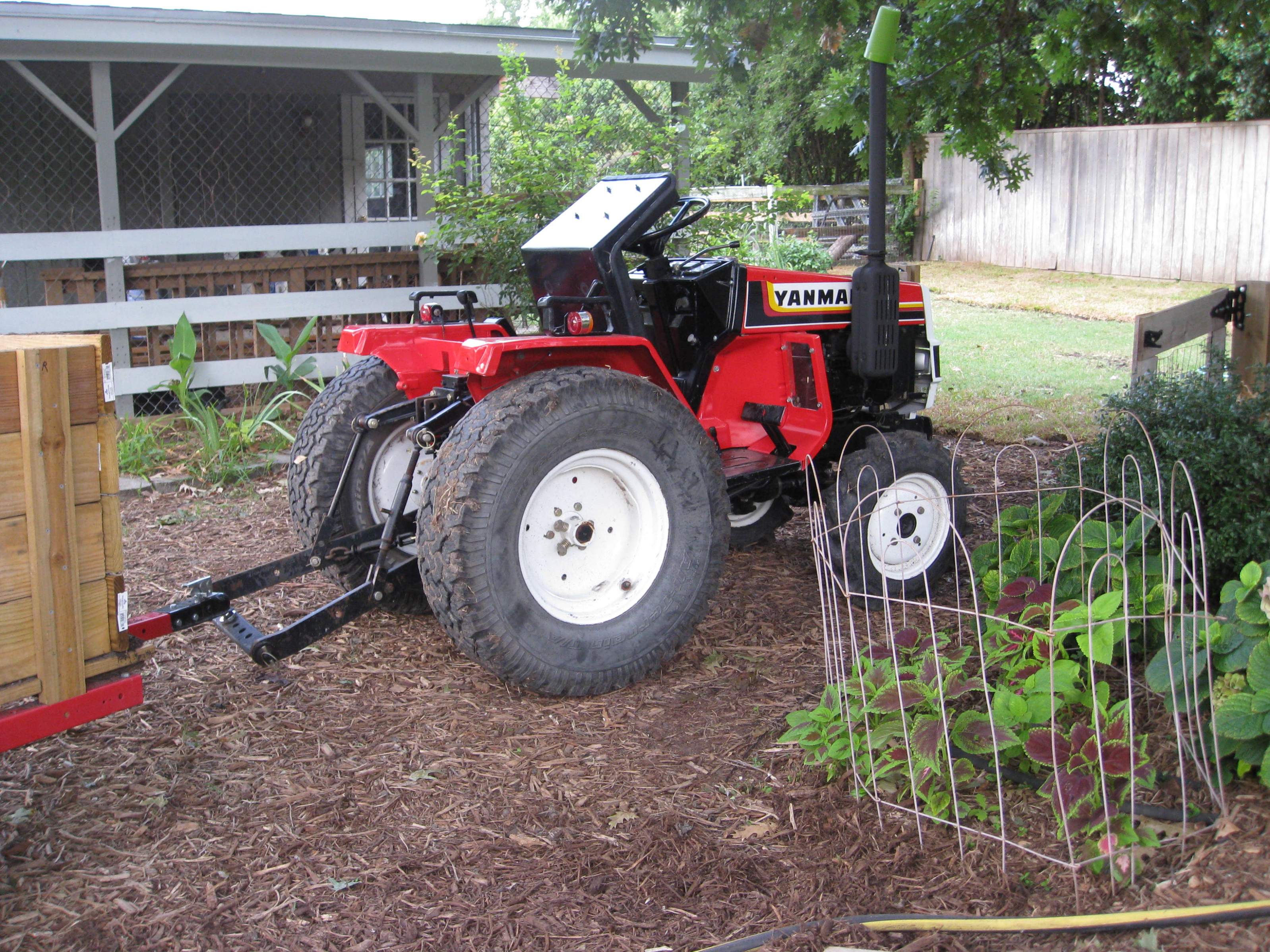

Another idea with respect to keeping weight down on the carryall, if you decide not to use the mesh wire, would be 5/4ths treated wood. I used this on my deck and it made a really sturdy structure. It is also what I used for my little trailer you see with the Yanmar.

My tires are the same size as yours, and I think our tractors are pretty close to the same overall size with respect to hp and weight. I got my truck/SUV tires before I knew anything about relative size front to rear to mesh with 4wd. I put mine on about 4 yrs ago, and I didn't know anything about sizing for 4wd until I got to this site, about 6 mos ago. My original rear ag tires are gone and I don't know what the roll-out or overall height of the rears are suppose to be. However, I have never had any issues with fronts seeming like they were not in sync with the rears. My rear tire height, groung to top is about 31 3/4 inches. If you get the opportunity, I would be interested in what the ground to top height of yours are. The tires I have are BF Goodrich all terrian T/A radials. LT 285/75 R16, 3 ply sidewall tubeless.

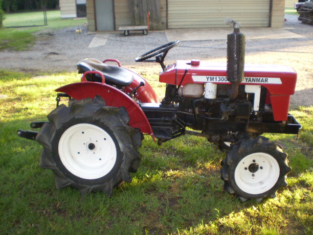

Once again thankyou Ron . The rears on this are more like rice tires I think, not sure if thats what You had or not. But the lugs are much taller then my other tractors .
Anyway I ran out & measured , Its sitting on gravel so hard to get an exact measurment but looks like right at 31 " & could be a tad taller if sitting on concrete . So i,d say you hit it close enough . I will see what i can find used in the size You gave me.
Just to let you know how much i pay attention. I thought yours was bigger because I noticed You had 6 lug bolts on the rear & this only has 3 . when measuring I just noticed its missing 3 on each side :eek: . Luckily the holes are there & threads look good , They just forgot to put them in. :D

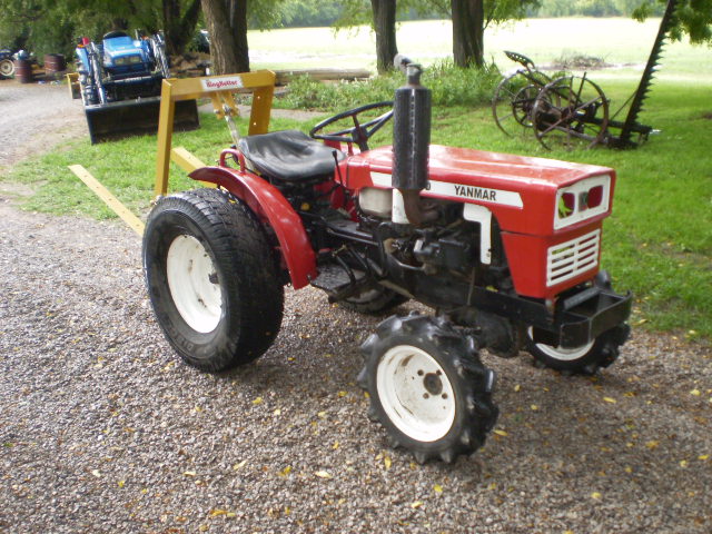

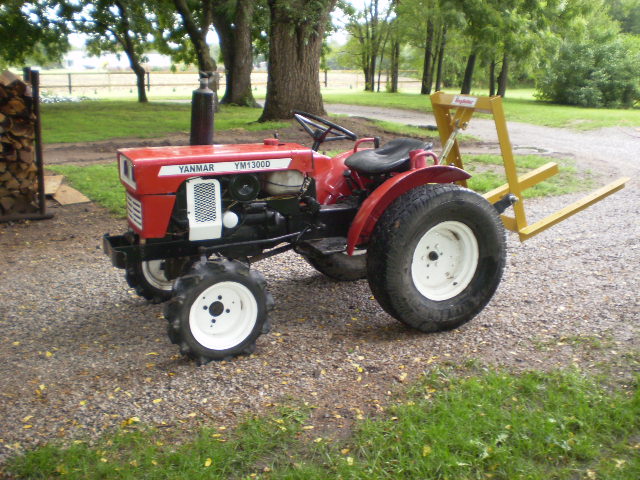

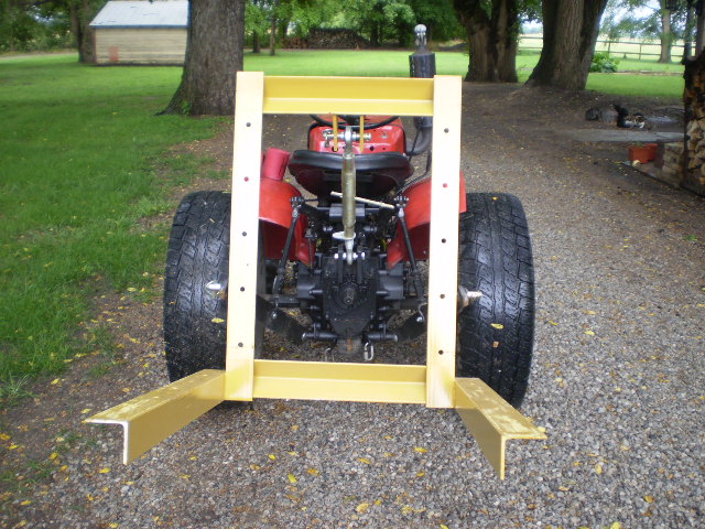

Still No carryall Built yet , But I got the tires on ,( Thanks Ron ), :D , Rearend leak fixed & the brakes adjusted , fuel tank & rearend vents fixed . Tires Made a Huge difference , No digging or Throwing water or mud up on Me I just took it for a test drive around the property after a nice rain. Hopefully I,ll get the Box built tommorow . The last pic is before . Bob
