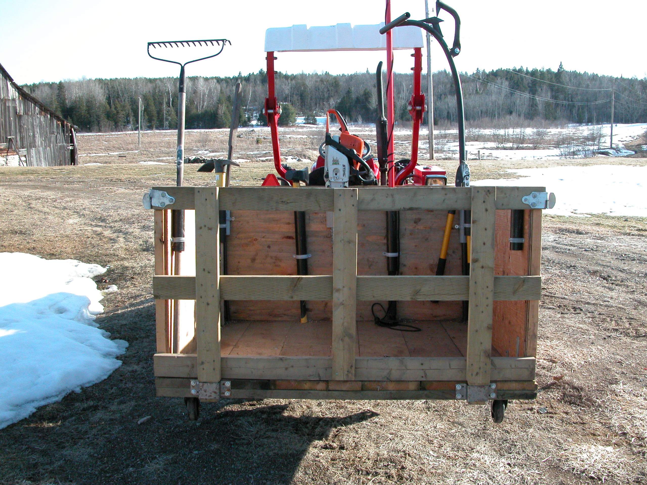

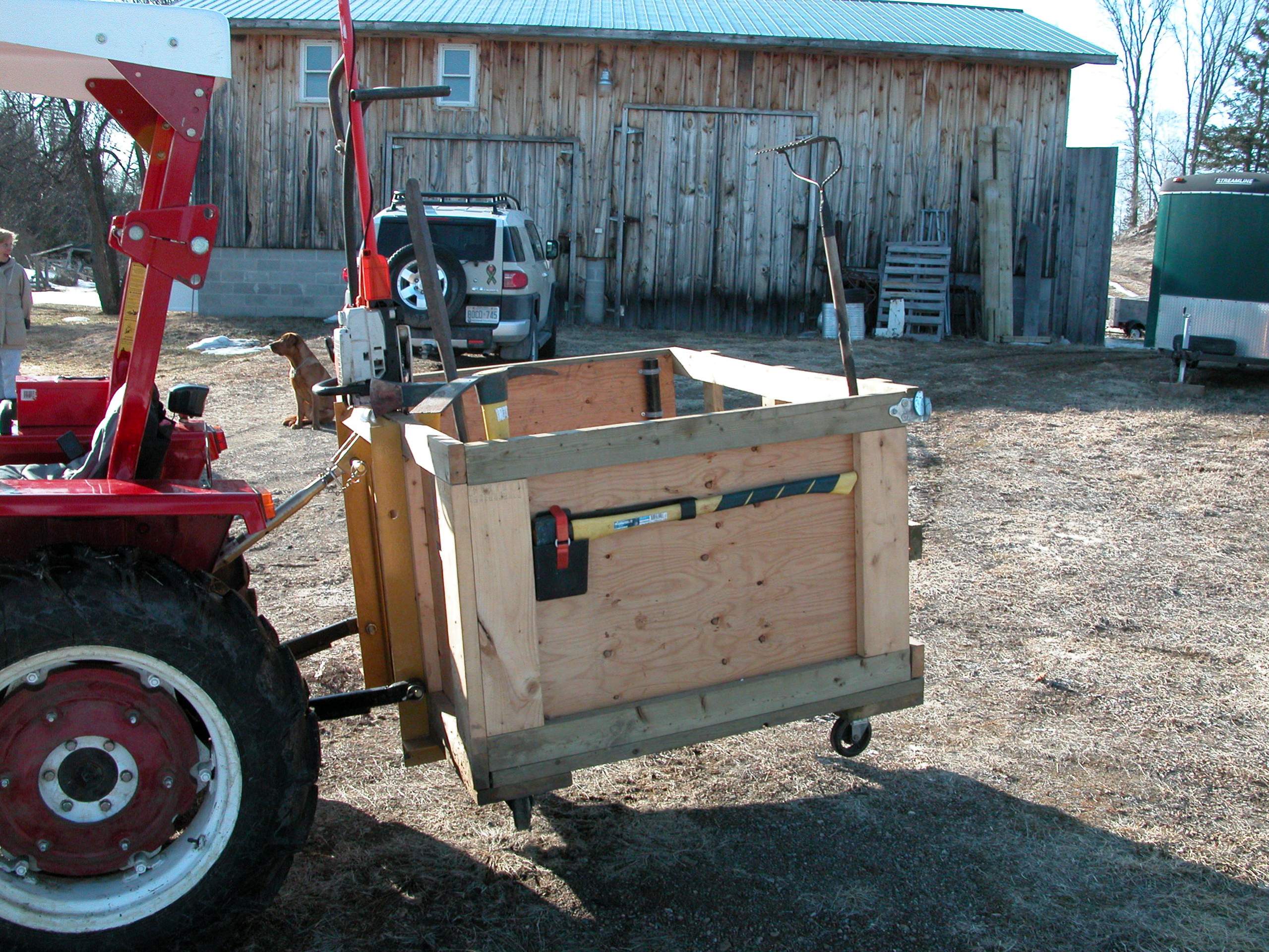

I bought one at TSC at the end of June and just put a platform on it. I waffled about how to build sides (swinging in like in the videos vs. fixed), and decided to make the sides drop-in stake-side style. The back will likely be a 2X10 or two that I drop into slots in each side. I'll likely add various tool carriers, too (like the chainsaw scabbard), so I can load up with wood and still carry my tools. It'll probably be winter before I get this done, though!
The numerous postings here have helped me a lot with design ideas and construction techniques.

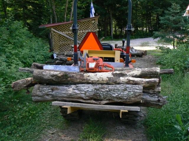

The carryall alone is fairly heavy, then add a couple of hundred pounds of boards (or steel box!), then fill it with firewood or compost or somesuch and you might, indeed need some weight in the front...especially if the front pops up now without any weight in the rear.
I have an FEL on my Kioti DK45 and it is likely to be loaded with wood or gravel or something whenever the carryall is loaded, so I don't think I'll have to add more weight beyond that.
Not counting the planning time, it took me about 4 hours to put together just the bottom and back for the platform (measuring [twice], cutting, drilling, bolting, screwing, and lots of trips to the basement shop for tools I forgot on the last trip). I still need to build sides, some sort of back gate and various tool holders before I'm done. It will be pretty heavy by then and I'll probably have $400 (Canadian) in materials into it! For all that effort, I hope I get a lot of use out of it.

Here are pics of one I built using scrap PT pieces from the clearance bin at home despot, scrap conduit and pvc, a piece of vinyl decking for the chainsaw holder and four casters from HF to roll it around the shop floor.The back "gate" uses stake pockets and rack corners to attach. The frame is a TSC one with the top link hole annoyingly drilled for a cat 2 pin:(
It rarely comes off the tractor in spring summer fall
