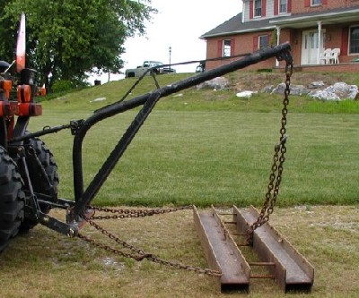

Here's my home made boom pole. The boom is a piece of 2" schedule 40 steel pipe. The bracing is of angle that was lying about, and the bottom bolts to a drawbar. The reinforcement on top is 1'2" square stock, and the attachment for the chain is a pair of Unsitrut "L" braces welded to the pipe. I can lift the front of the tractor if I'm lifting something too heavy.
The rig chained to the pole is a thing I made up to fix my stone driveway before it was blacktopped. Simple matter of bolting two pieces of 6" beam together. The two chains connecting to the 3PH get lengthened/shortened to cast material to the left, right or straight. They are off-center, and flipping the rig allows it to be more or less aggressive.................chim
