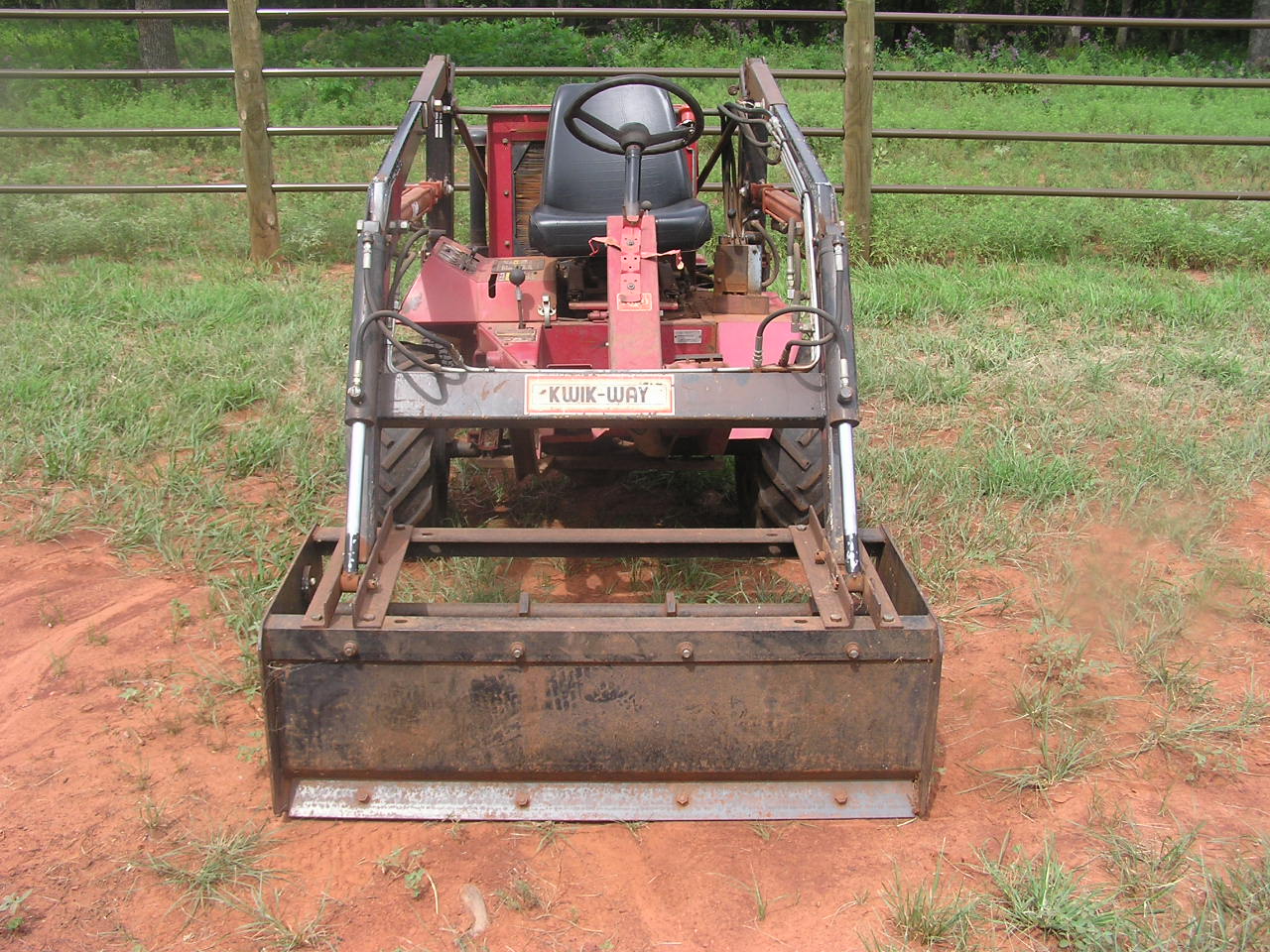

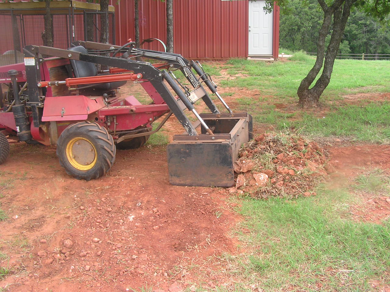

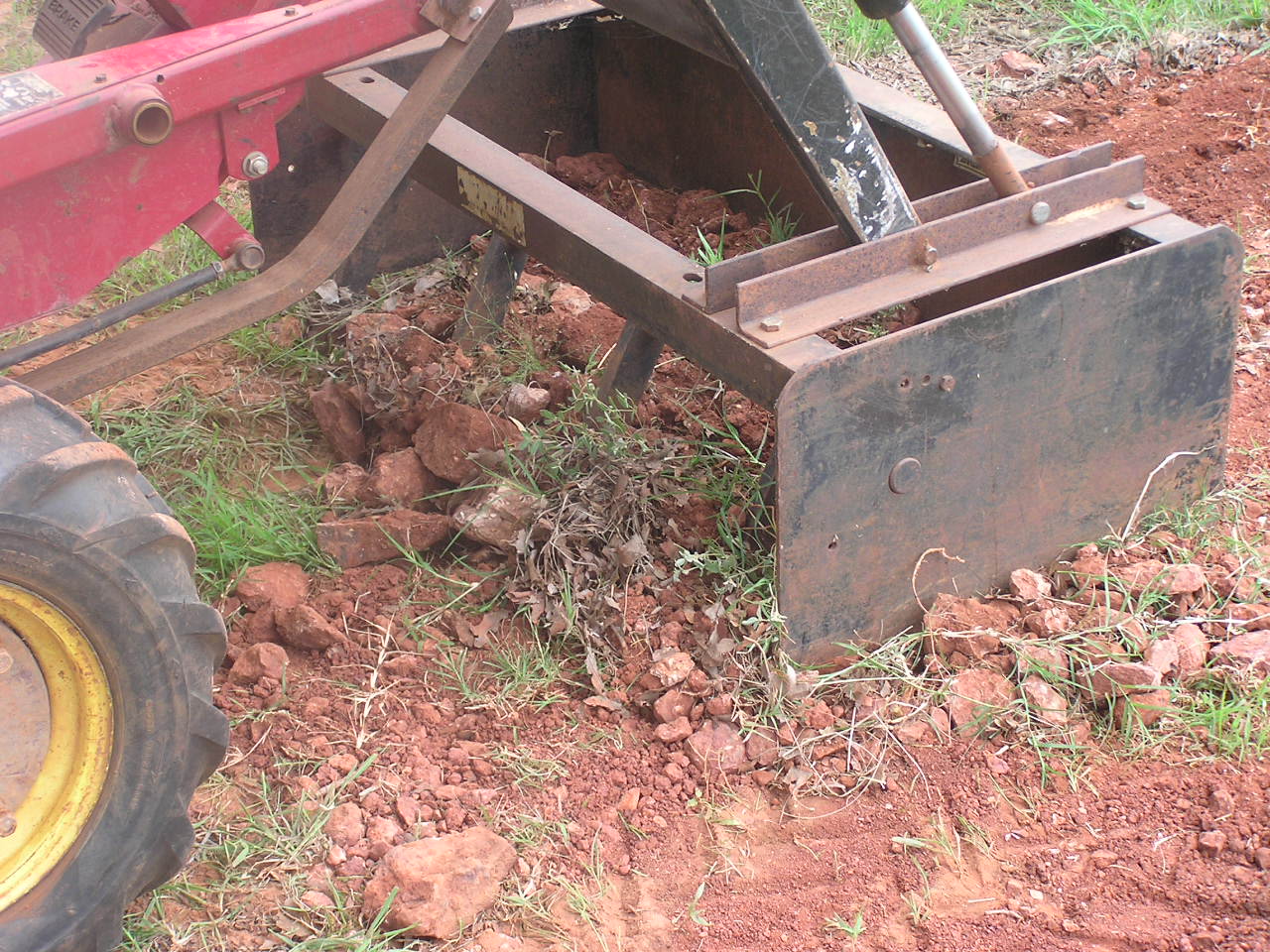

Works with my pin-on boxblade, but haven't tried it on the driveway:
I use float to fill it:

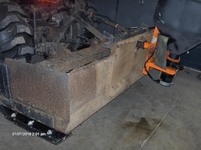

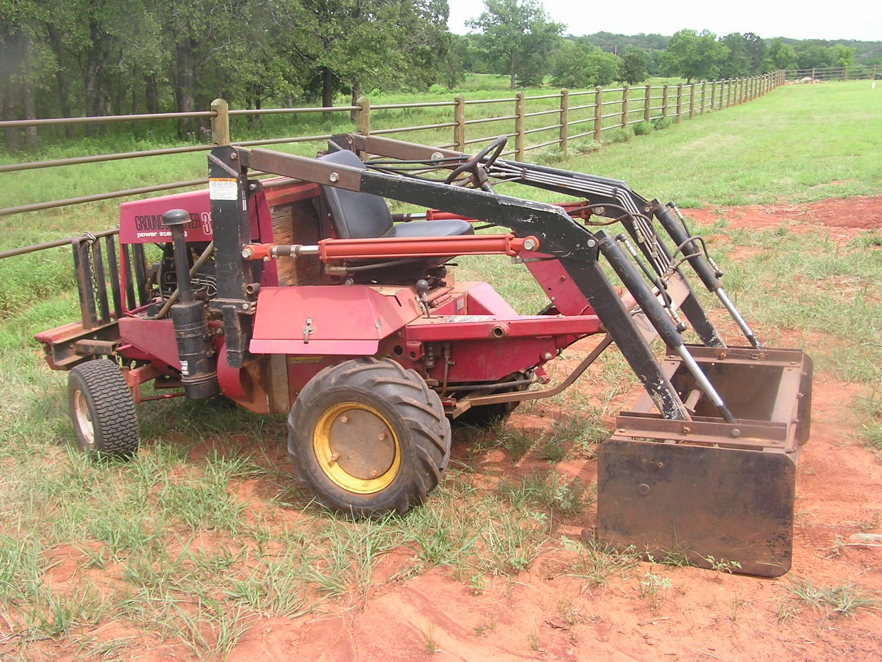

I put a 3-pt hitch on my FEL fork frame, as I never remove my backhoe. I do NOT use an SSQA, however.
I do use the FEL mount to support my hyd mixer, a boom pole, and even a landscape rake, pushing it
forward only.
A landplane it pretty heavy. I do use a 4-in-one bkt on my FEL for grading, and that would be similar, I
suppose. I also skid logs in reverse using my loader so I can lift one end. Going in reverse and not
turning sharply is important.
If you go that route, let us see what you come up with.

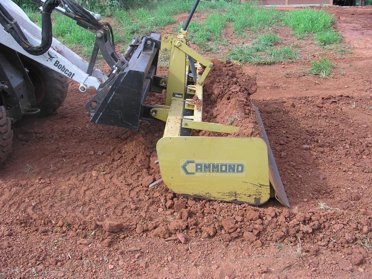

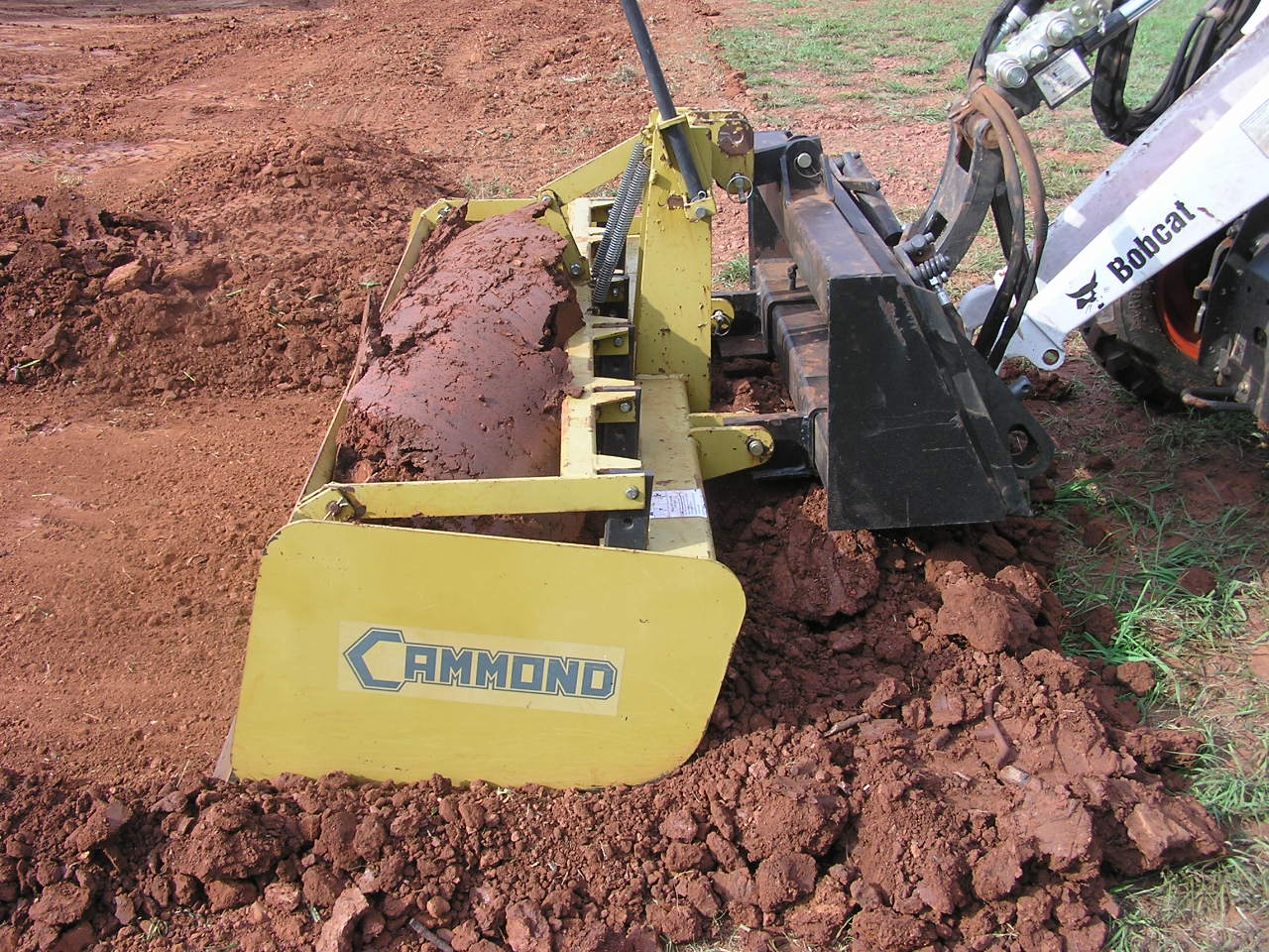

Just wondering - has anyone with SSQA style loader used 3 pt. attachents on their loader? I was thinking of buying a SSQA mount plate that is already welded to 3 pt. quick hitch. Would then mount my 72" Land Pride land plane to my loader and use on my 600 ft gravel driveway by driving in reverse. ----------------------------------- Any thoughts? Thanks.

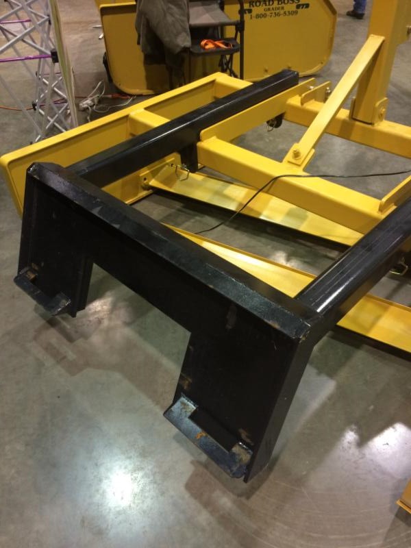

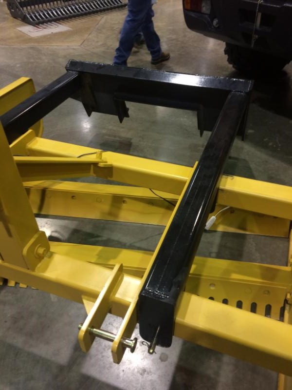

Here is another option that would let you drive forward: Skid-Steer Attachment :: Road Boss Grader

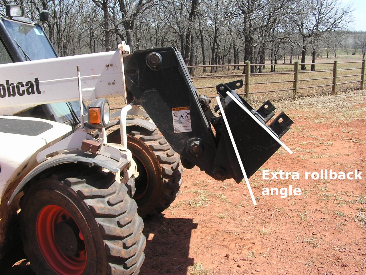

If you do get or build a 3 point adapter with SSQA, be sure to have plenty of rollback angle:
View attachment 540391 View attachment 540390
View attachment 540392 View attachment 540395 View attachment 540394

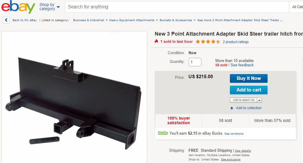

I'm still confused about adding additional rollback angle on the 3 point adapter with SSQA. I can buy standard ones on Amazon or Ebay and as of now I only anticipate using it with the land grader. Would this work - or am I looking for trouble?? Thanks for your help.
I first read about extra rollback angle in reference to DIY pallet fork builders that wished they had more rollback:
I got lucky with the adapter that I bought: Skid steer Bobcat 3 point implement hitch adapter Heavy Duty
I needed a heavy duty 3 point adapter and it has extra rollback built in:
The Road Boss adapter has extra rollback built in:
Here is a SSQA to 3 point adapter with no extra rollback:
I guess it depends on how much curl angle your loader has. You may not need much with the land grader. I have no experience there.
