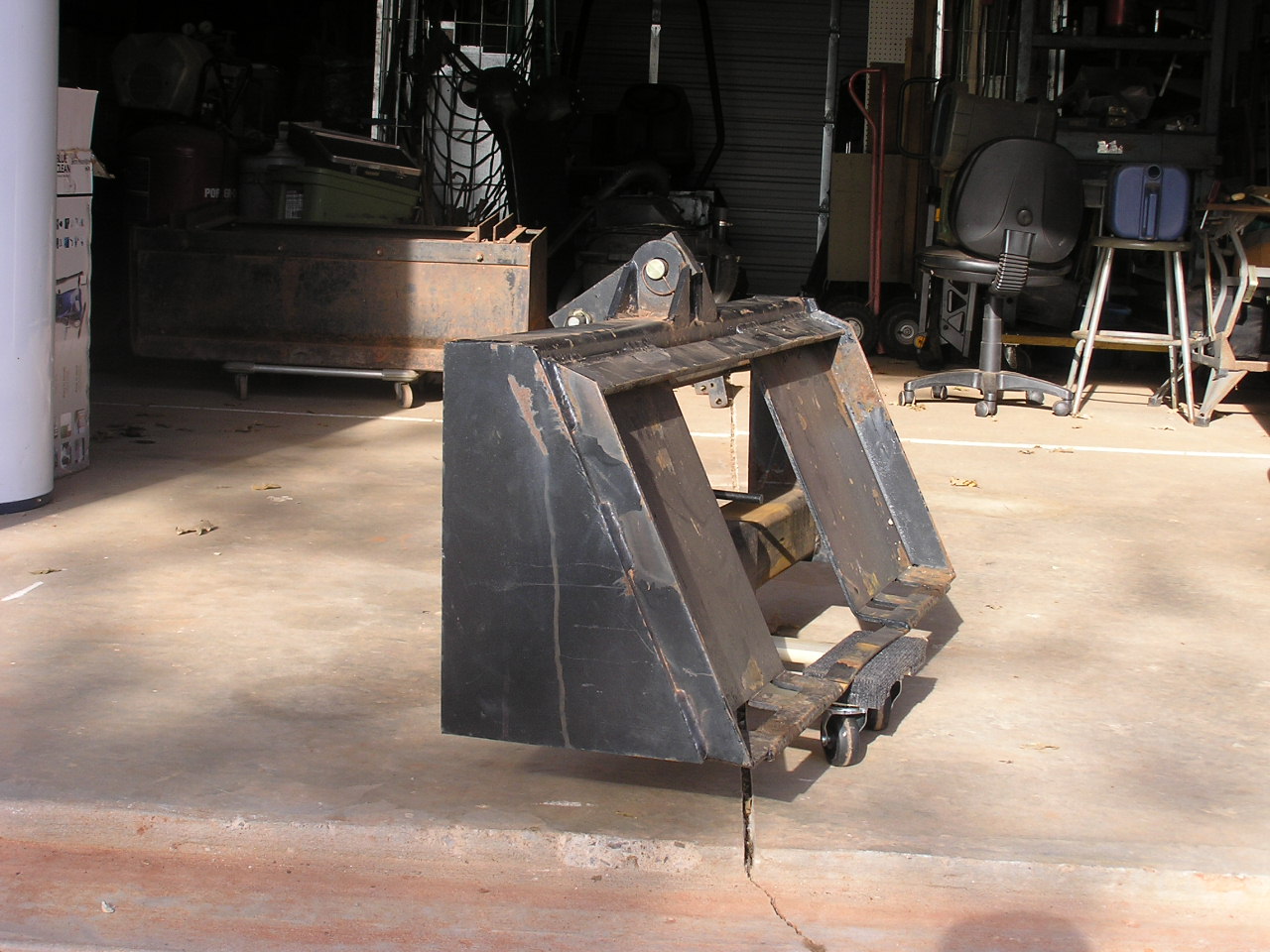

Front-End Loader 3 pt. attachents mounted to loader
   / 3 pt. attachents mounted to loader

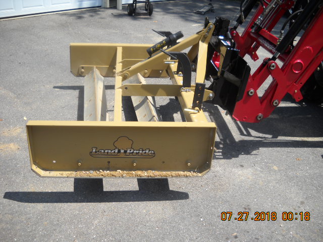

Hi Xfaxman - Thanks for the suggestion of the Road Boss skid steer attachment. I have contacted them for pricing and asked if it is adaptable for my Land Pride land plane. Will keep all posted.

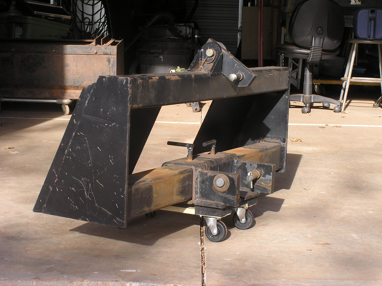

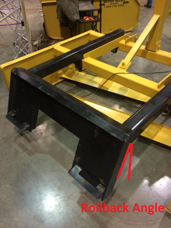

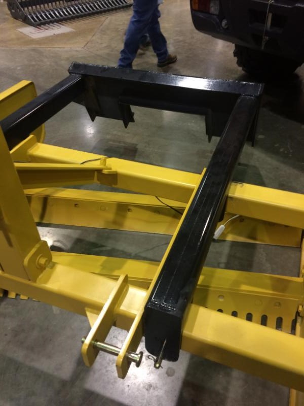

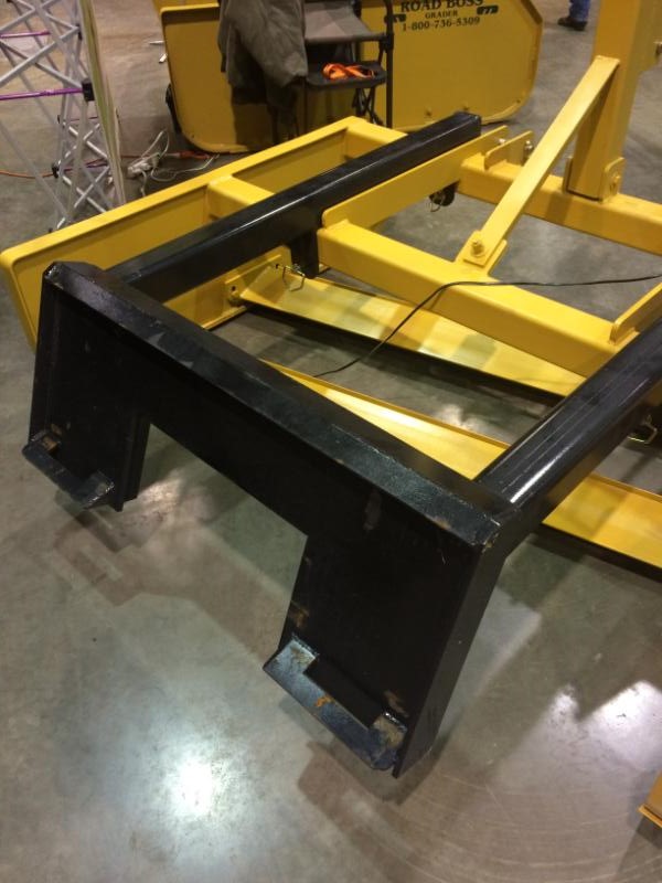

Here is another option that would let you drive forward: Skid-Steer Attachment :: Road Boss Grader
View attachment 540391 View attachment 540390

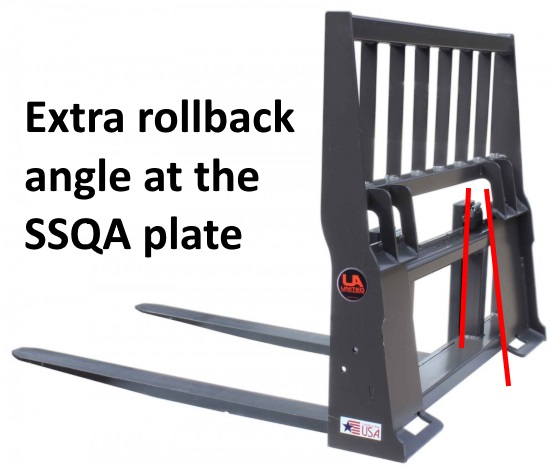

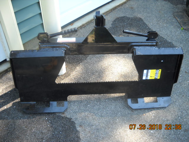

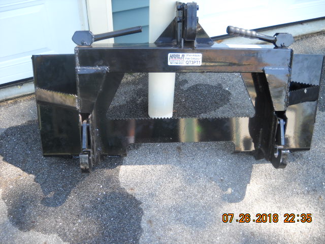

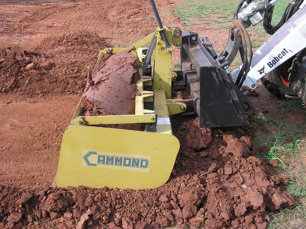

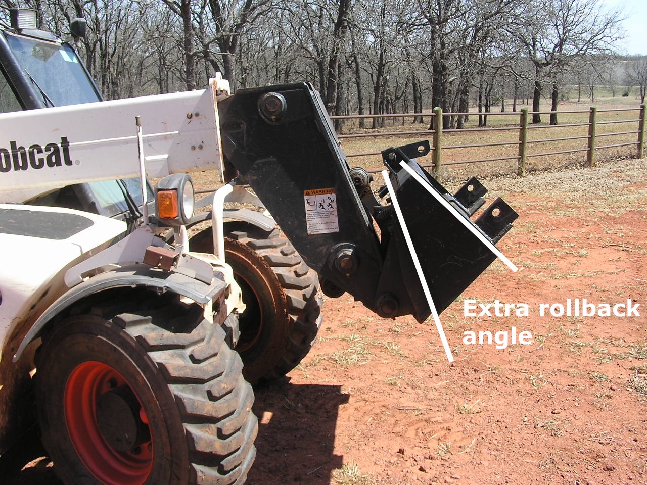

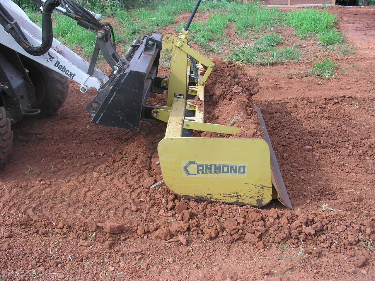

If you do get or build a 3 point adapter with SSQA, be sure to have plenty of rollback angle:
View attachment 540392 View attachment 540395 View attachment 540394
Hello everyone. I think I have addressed some of your concerns. I have ordered 2 of the rear cutting blades from Land Pride - who advised that they are the same as front cutting blades. Holes are already pre-drilled and they will just bolt up to the back of the tube that carries the front cutting blades. Land Pride indicated that with these additional blades- the grader will work either driving forward or reverse. Now I can drive forward and push the grader instead of having to drag it with the loader. I'm still confused about adding additional rollback angle on the 3 point adapter with SSQA. I can buy standard ones on Amazon or Ebay and as of now I only anticipate using it with the land grader. Would this work - or am I looking for trouble?? Thanks for your help.

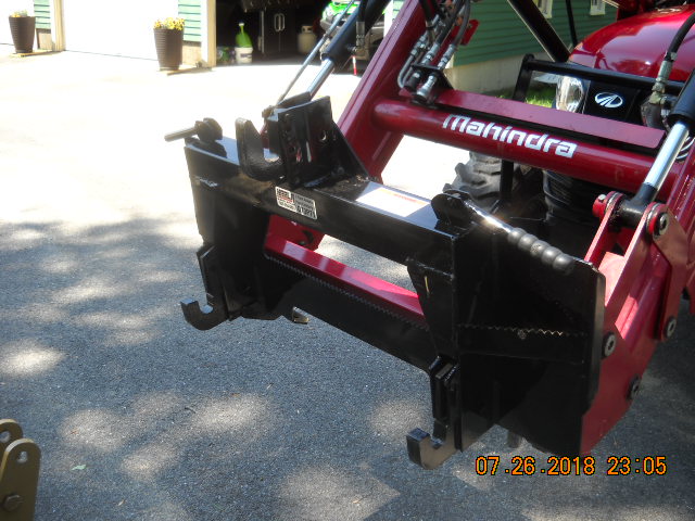

I first read about extra rollback angle in reference to DIY pallet fork builders that wished they had more rollback:

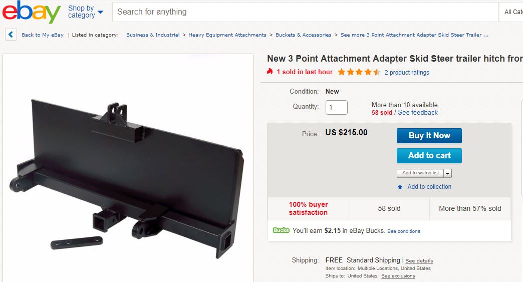

I got lucky with the adapter that I bought: Skid steer Bobcat 3 point implement hitch adapter Heavy Duty
I needed a heavy duty 3 point adapter and it has extra rollback built in:
The Road Boss adapter has extra rollback built in:

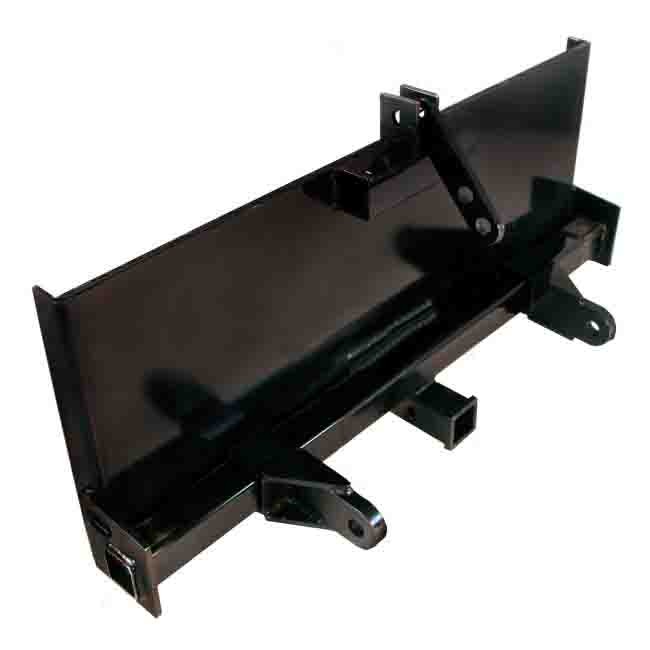

Here is a SSQA to 3 point adapter with no extra rollback:
I guess it depends on how much curl angle your loader has. You may not need much with the land grader. I have no experience there.
