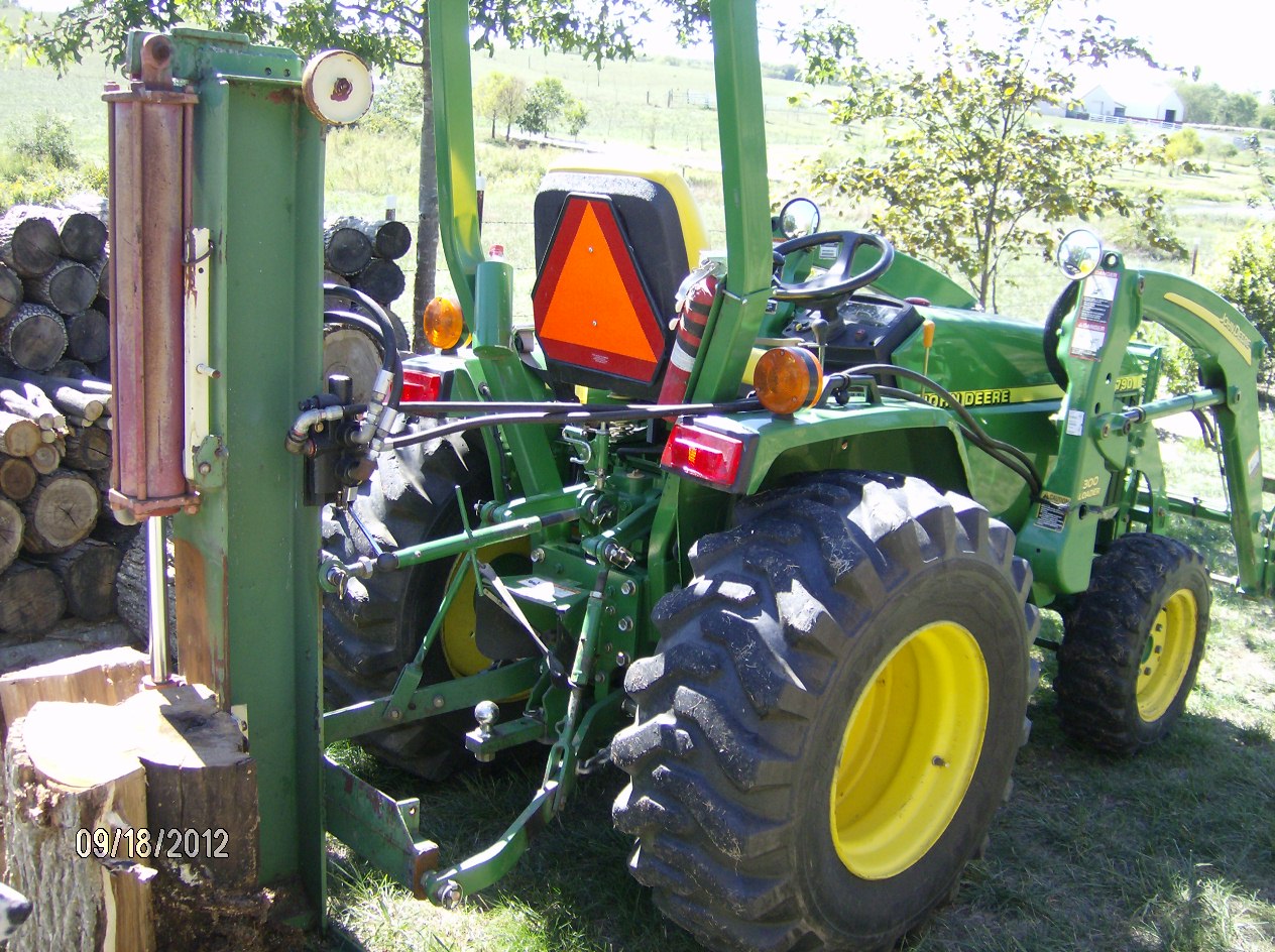

I use the hydraulics on my JD 790 for my 3-pt splitter at a fast idle. No, it's not fast, but I work alone & i'm not fast either & it works fine for me. HPIM3914.JPG I just added long hoses to hook to the loader bucket connections & tie the joy stick off to the opposite fender.

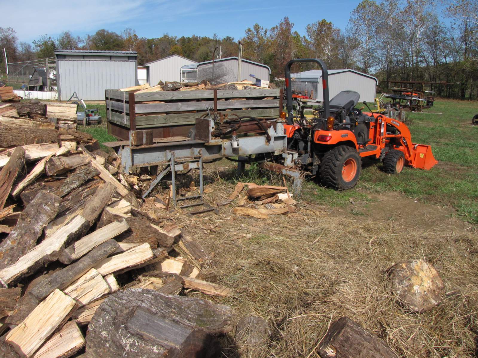

Here is my BX2660 running my pto driven splitter. I run around 1800rpm.
