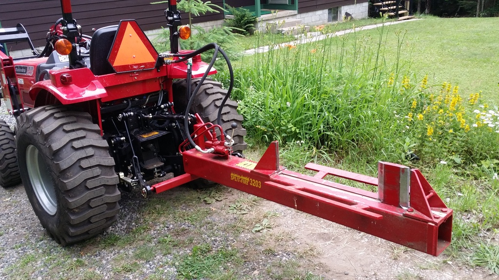

I have a 3016 with backhoe if I remove backhoe I can use the backhoe lines for the splitter right

the tractor hydraulics don't put out enough flow to run the splitter efficiently. the splitters typically have an 11gpm pump while the 3016 has an output of 7.8.
it would run very slowly.

that's what i meant when i said it would run slowly. it would be much slower going in both directions. it will still generate the same splitting force but it will take longer to split and withdraw the wedge.

No the 3016 bh runs off the tractor hydro.
/ 3 point log splitter #11
It WILL work, but you will fall asleep waiting on the ram! lol

When I remove the backhoe to put on the splitter, I use the rear remotes. The next time I split I will try the backhoe connections. As far as speed goes....I never have to wait with the Split Fire as it splits both ways. (Don't have to wait for the blade to return)

I love my split fire also. I agree I'm never waiting on the spliter. how long have you had yours?
It takes 3 people to ensure little to no downtime. One to supply wood to the lift or table, one operate / manipulate the wood and splitter, one to clear and stack or bag the wood. With 2 people the splitter is idle probably 30% - 40% of the time especially splitting ash as it only takes about 4" of stroke most of the time. I found it takes ~ 10 minutes additional time to split and stack per 1/3 cord simultaneously as opposed to splitting into a pile. to stack from a pile to 1/3 cord takes me about 20-30 minutes depending on how far I have to move the wood.
I run my tractor at 1800-2000 rpm when spliting with 2 people it's plenty fast. although I believe my tractors max flow is 17.1 GPM at ~2700 rpm

get the 4 way, and log lift it's an awesome table. you can easily fit 16" pieces next to one another on the table. if you cut to longer that 16" consider one of the larger lengths. the 24" is like 32.5-33" between the uprights so you can just barely fit 2 16" pieces on the splitter at the same time. If I could do it again I would go with a 28" model.
