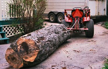

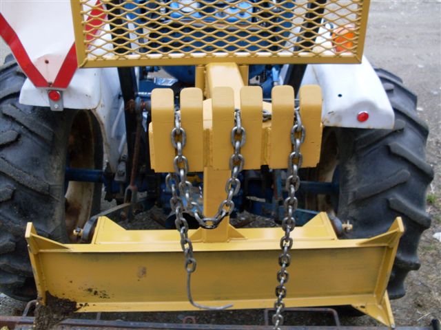

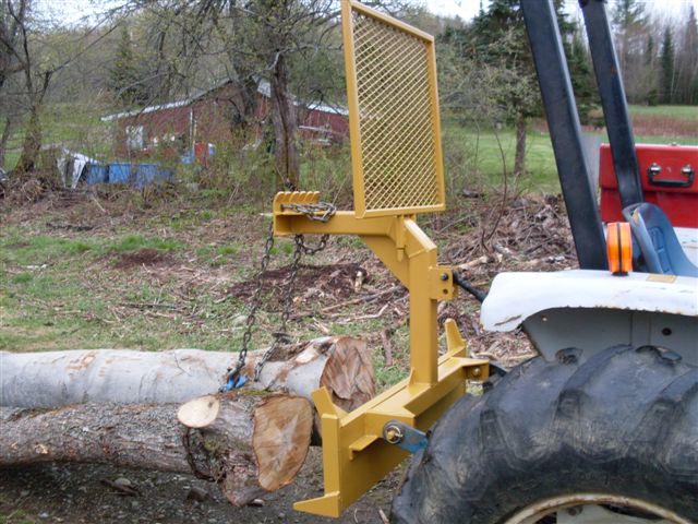

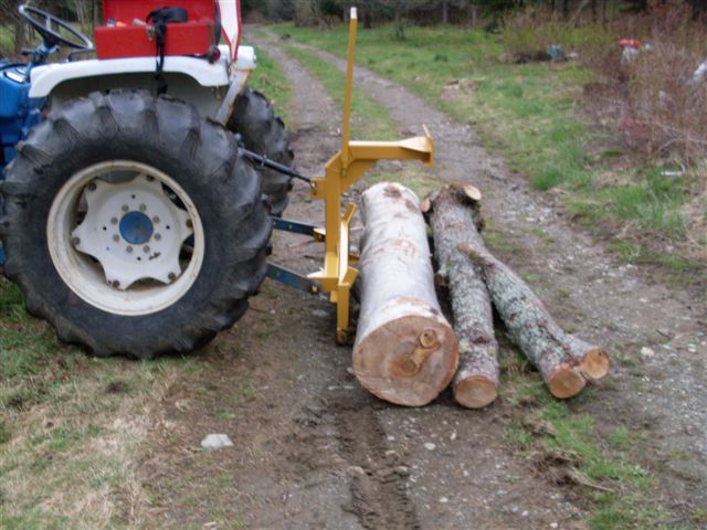

heres mine
This is the best set up I have seen for what I am going to be doing. Was this a home made unit or did you buy it? I'll have to keep that one in the data banks to build one later. If you bought it what brand and where?
I drug two more logs today (20" x 16') and ran them over stumps on purpose and no problems. I'll use the second chain to the drawbar when needed.
/ 3 point log skidder/multi purpose #26
I built mine my boss saw it and immediately began selling them for 750.00
I wont use tbn to sell anything so I say build it , material cost is low design is simple the bunch blade is great. good luck dont let any test dummies drive your tractor:)

After looking at mine again I think I'll just make a "bunch blade"(thats the thing for the chains. RIGHT?) to fit into my reciever. I don't really need to push with it, have a FEL.
