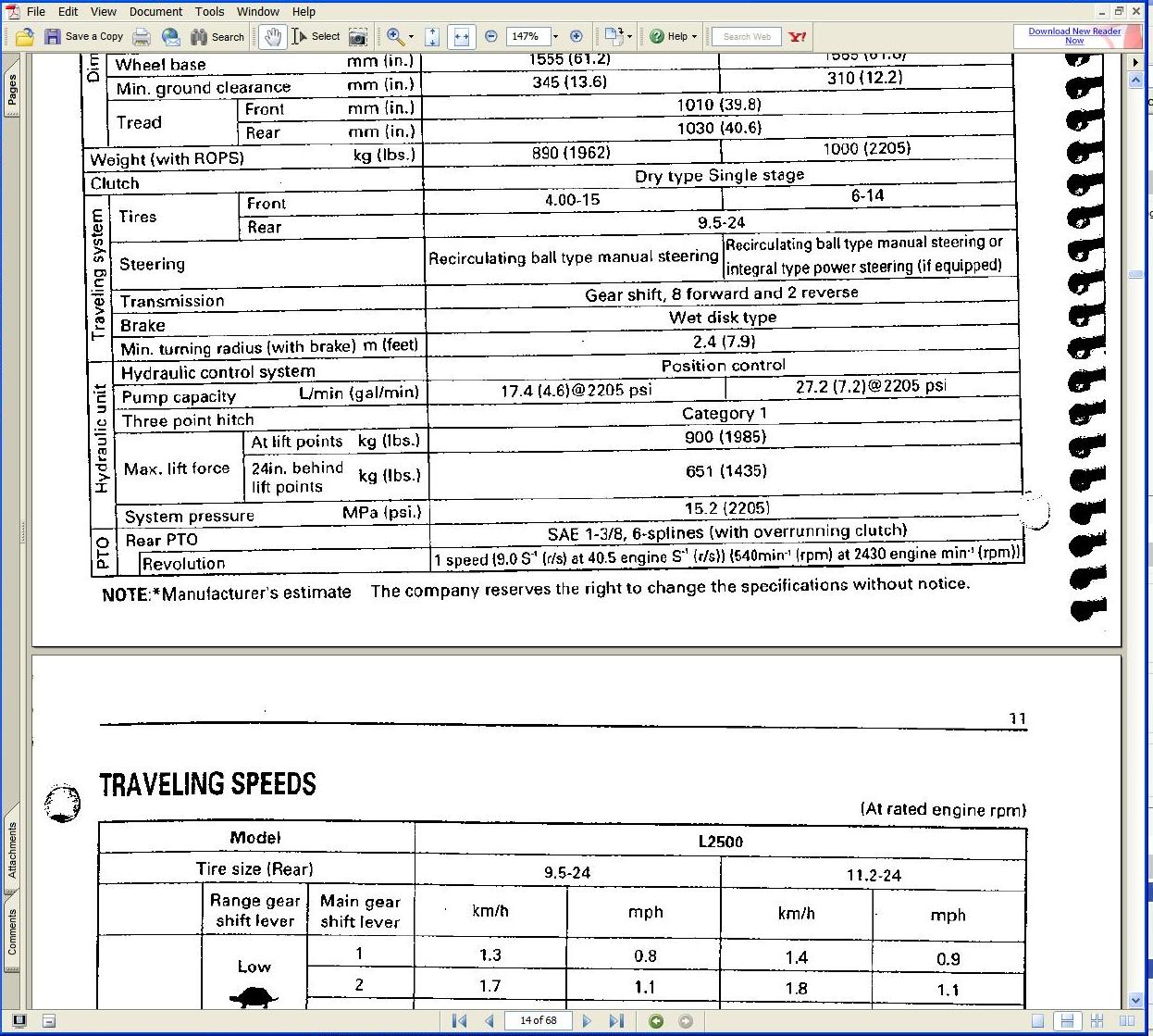

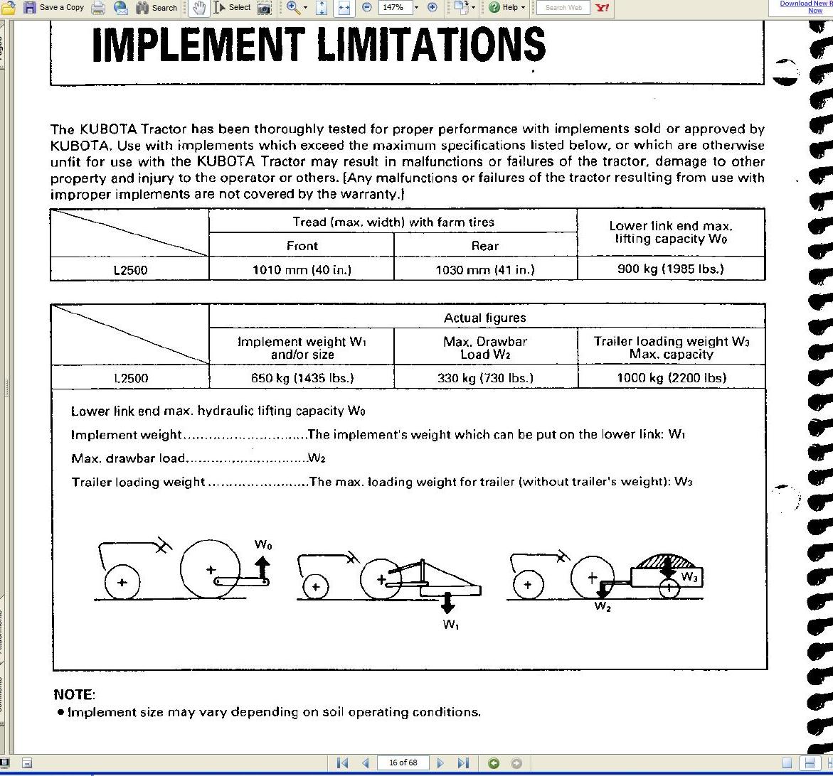

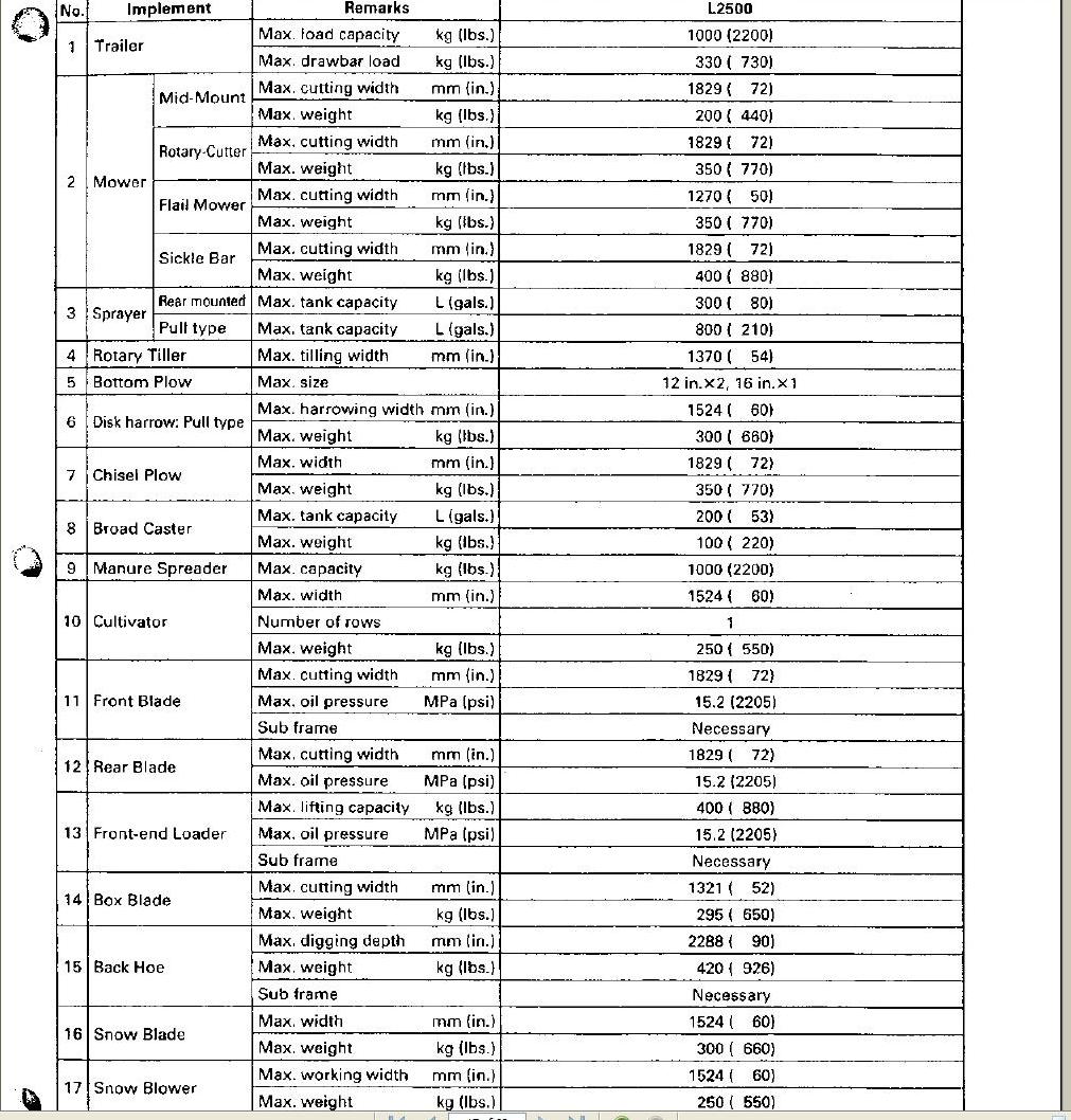

It should be in you rmanual...here is mine... L2500

Rob, I think the point was he doesn't have the manual because he doesn't own the tractor (yet?). 'Cause as we all know Kubota is 100% STINGY about publishing their manuals online. Maybe a BX2230 owner out there could post this information from theirs?

Oops, I think you are right. My Bad!
Right about Kubota, there should be a free download spot for past and present Kubotas. ALL!! A little CYA in this sue happy world.
But on the numbers and my L, I can't imagine lifting 1925# at the end of the lift arms...I think my tractor weighs 2000#!!
