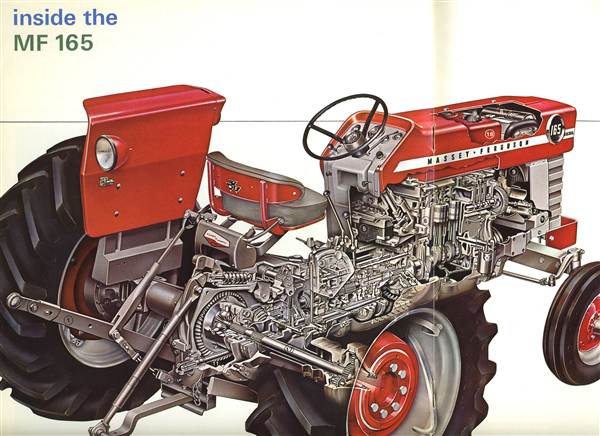

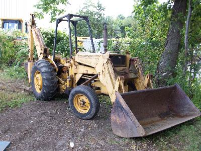

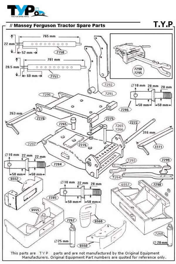

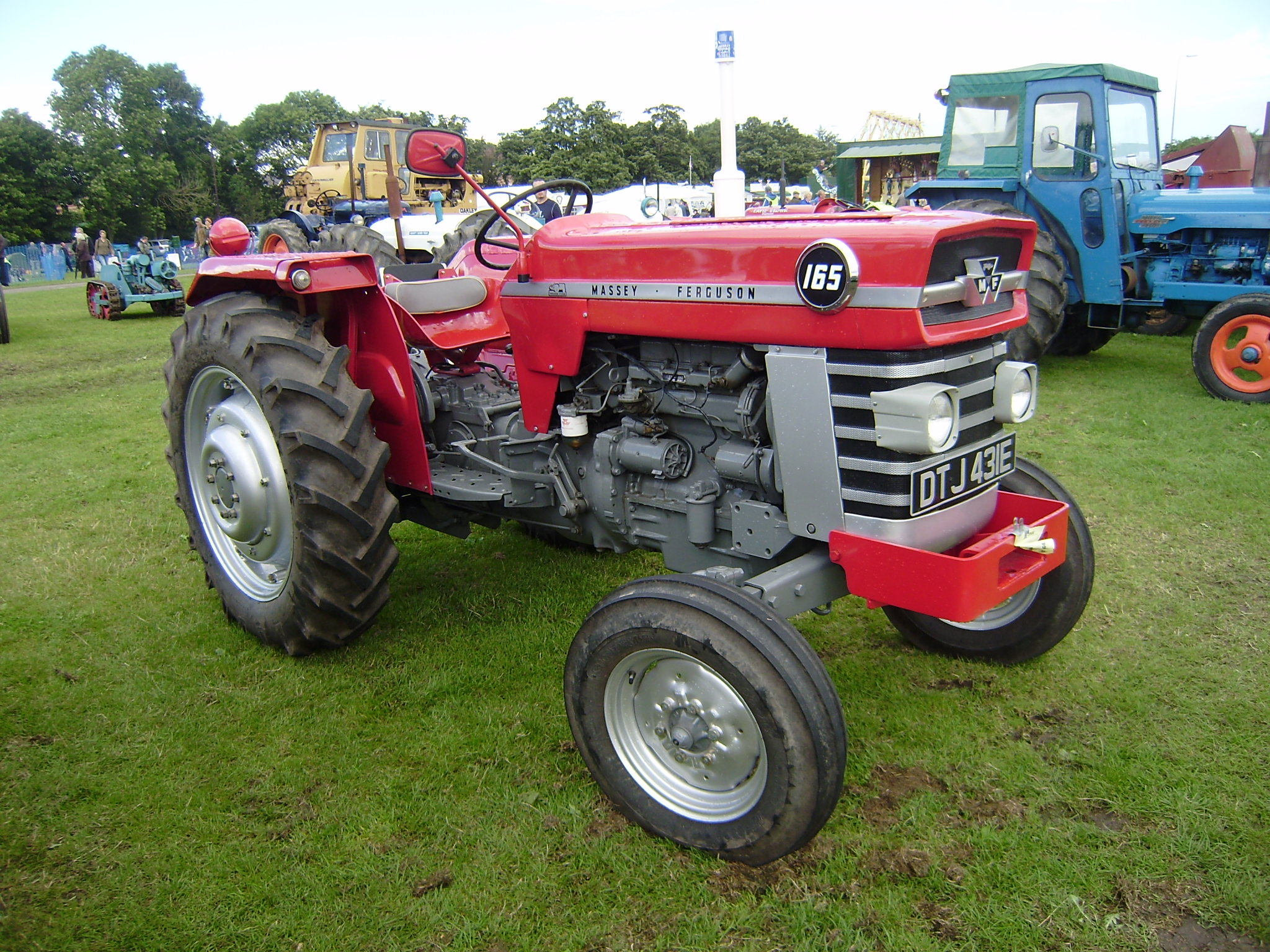

It looks like it is the industrial version of the MF 165, Should be cat 2.
Some pictures from google images, MF 165.
MASSEY IND PIC 004 (1).jpg mf-165-b.jpg MF_165_tractor_DTJ_431E_at_Driffield-P8100534.JPG

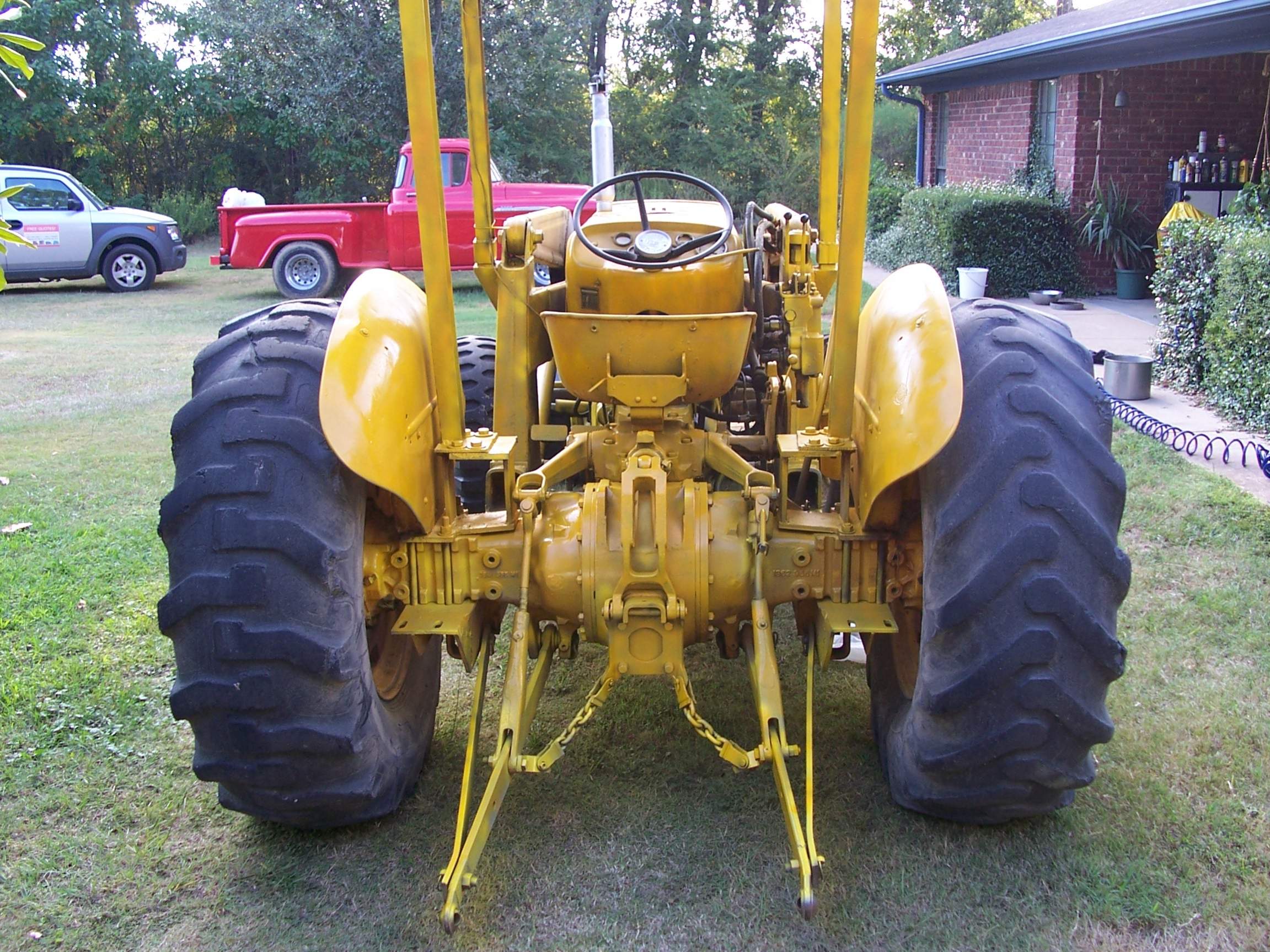

MF 3165.
Massey Ferguson 3165 Industrial tractor parts
/ 3 point hitch set up?
Sorry guys have not been able to reply. But thanks for the information. The first picture on xfaxman reply looks like my trator form the rear.

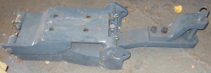

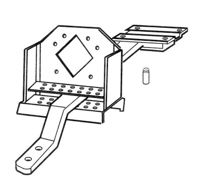

Another thing to consider is a swinging drawbar, if you ever want to get a pull type brush hog, and it has other uses, like the safest way to use a chain to pull something.
Could not find pictures for a 3165/165, but this is is the idea, they bolt on to the bottom, check your's for threaded holes.

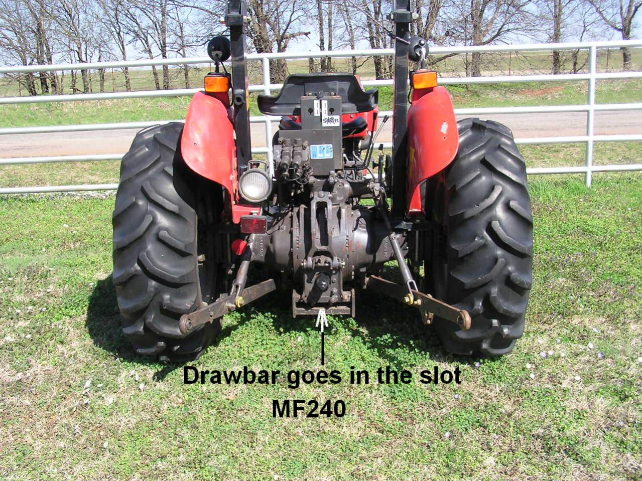

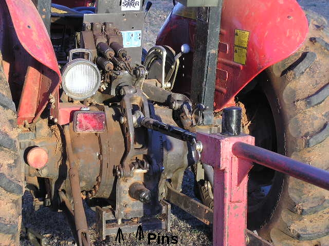

I forgot to mention that the drawbar is easily removed by pulling a pin.
This is what the bracket looks like, without the drawbar in it, on a MF 240.
The bracket may look different for a MF 3165, but will have the same function.
