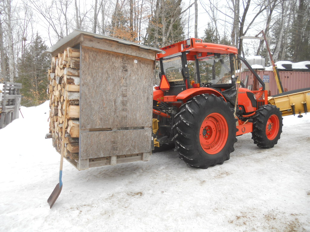

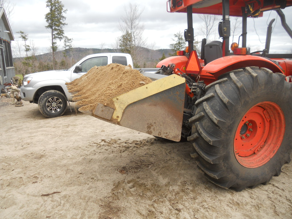

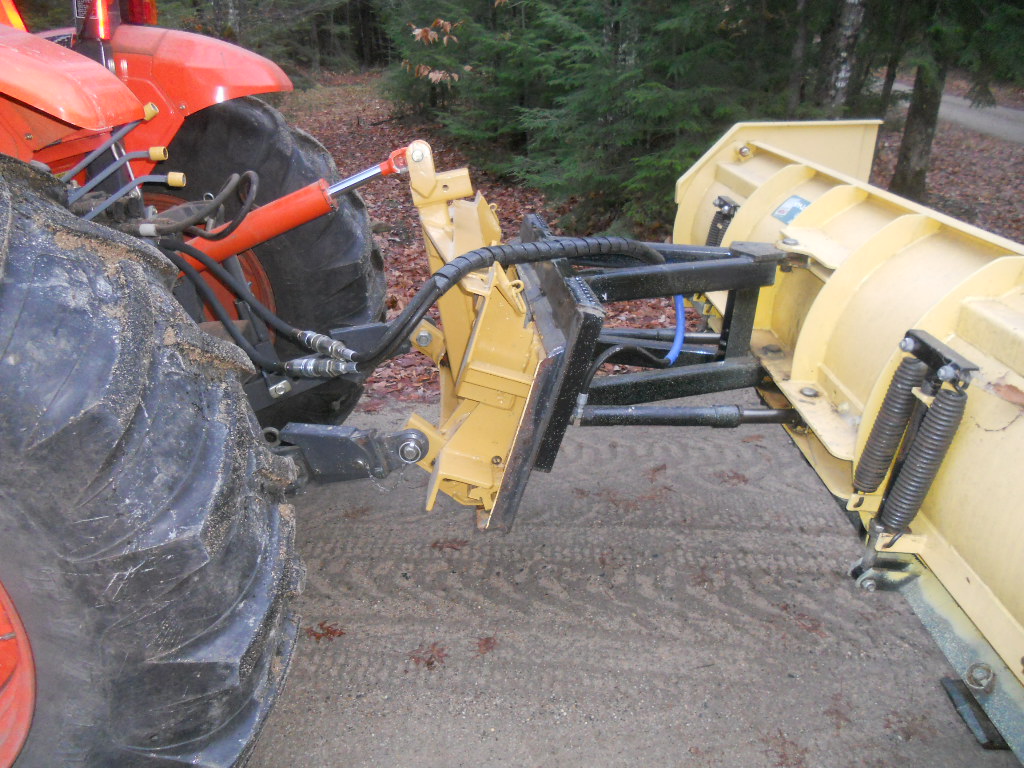

I had the front assy (QA) from a bobcat hanging around and made one (a few months ago). I've used it with the pallet forks and been contemplating using it with a snow plow (got a few of them hanging around also) to plow in each direction. I did put a SS bucket on it just to see if I had enough motion with the HYD. top link to fill & dump, no not enough. It's handy and $300 seems like a fair price. I thought that it would be really nice to have a bucket on it just to carry tools around.
   / 3 Point Hitch QA Adapter
View attachment 498559View attachment 498560View attachment 498561
Thanks for your reply.
I didn't think there would be enough reach on the hyd. top link to make the bucket usefull for moving material. I thought I could back into a gravel pile, pick up enough to add some weight and tip it up a bit to hold. To dump, I figured I'd have to remove a top link pin. In any case, as you say, it would make a handy storage bin for tools and such.
