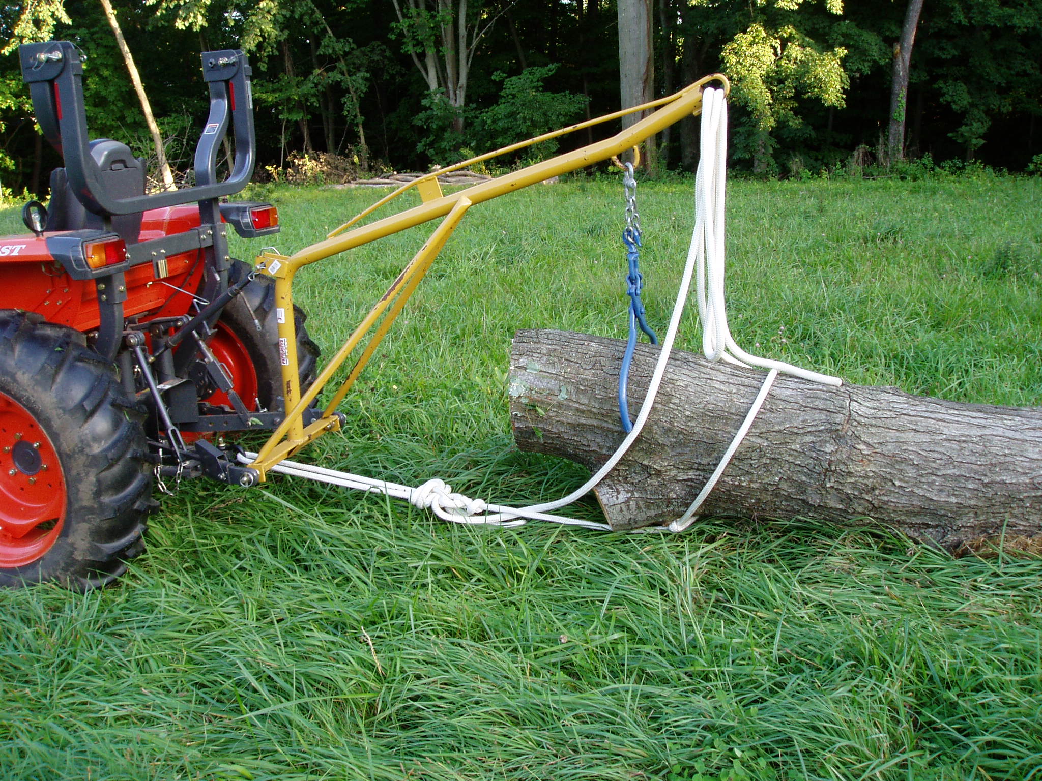

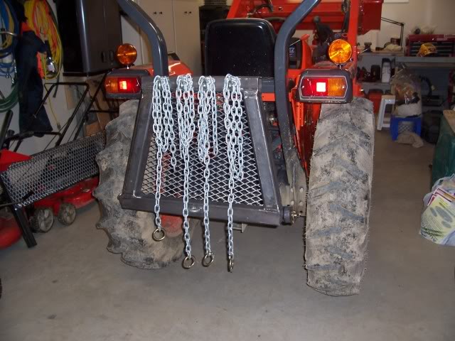

I've used mine for one season so far, works pretty well. There are four grab hooks mounted at the top to hang chokers from.

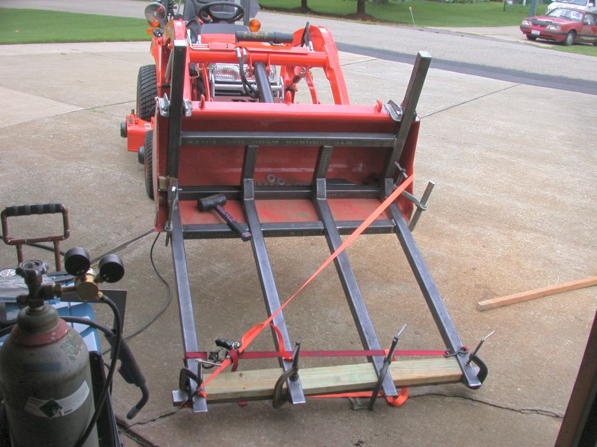

Hey, HarleyScooter that looks like a great setup. What are the wider clevis attactment points on the bucket for. Thanks, Dan
They are for a set of brush forks.

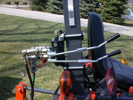

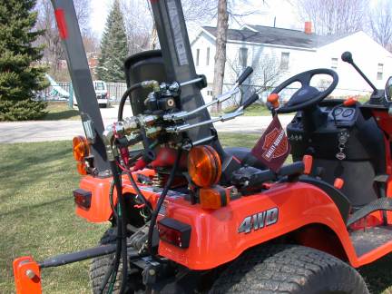

HarleyScooter, what type/model valves did you by and where did you mount them? Some pix of that set up would sure be appreciated. why not tap into the loader valve fro the grapple valve? Thanks a million.
   / 3-point hitch log skidder #25
Rusty, I used Kubota valves and hooked into where the backhoe hyd lines are. I already had the rear remotes so eight extra feet of hose was a lot cheaper than the extra valve set up, it took a little getting use to but now it is no problem.

Rusty4242, Many of the responses to your original question are reasonable. The concern about stumps preventing backing to the log seems puzzling. Why waste the wood left in a tall stump. We cut all stumps at ground level to eliminate later problems. The other recommendations about jerry rigging: Be certain to PULL the load below your axle, not on the 3 point. If not, flip over is very possible. Any of the chain choker suggestions will work, after lifting the log and setting the choker, then climbing off and releasing the chain/chokers. As it was suggested, if there are numerous logs to be moved, you will find the convenience of never leaving your tractor to hook up, pull out and drop off any log that is within the 22" diameter and that your tractor will handle safely, is well worth the price of the Small Wood Lot Tools equipment.
   / 3-point hitch log skidder #28
To restate SWLT's comment, this is my basic rule:
Lift with the 3pt; pull with the drawbar.
And by drawbar, I mean the one that's permanently under your rear axle.
It's a little more work to make both hitches, but there's never a hint of the front end go skyward.
I usually use a choker chain and and a grab link on the drawbar instead of the 1" rope.
That particular log was to big to get the choker chain around with enough left to reach the drawbar, hence the rope.
This is especially imortant if you try to climb a substantial grade with a similar load.
I have a HF quick hitch that I plan to modify with a blade on the bottom and a beam on the top for holding the tongs. A separate draught chain will be hitched to the drawbar.
