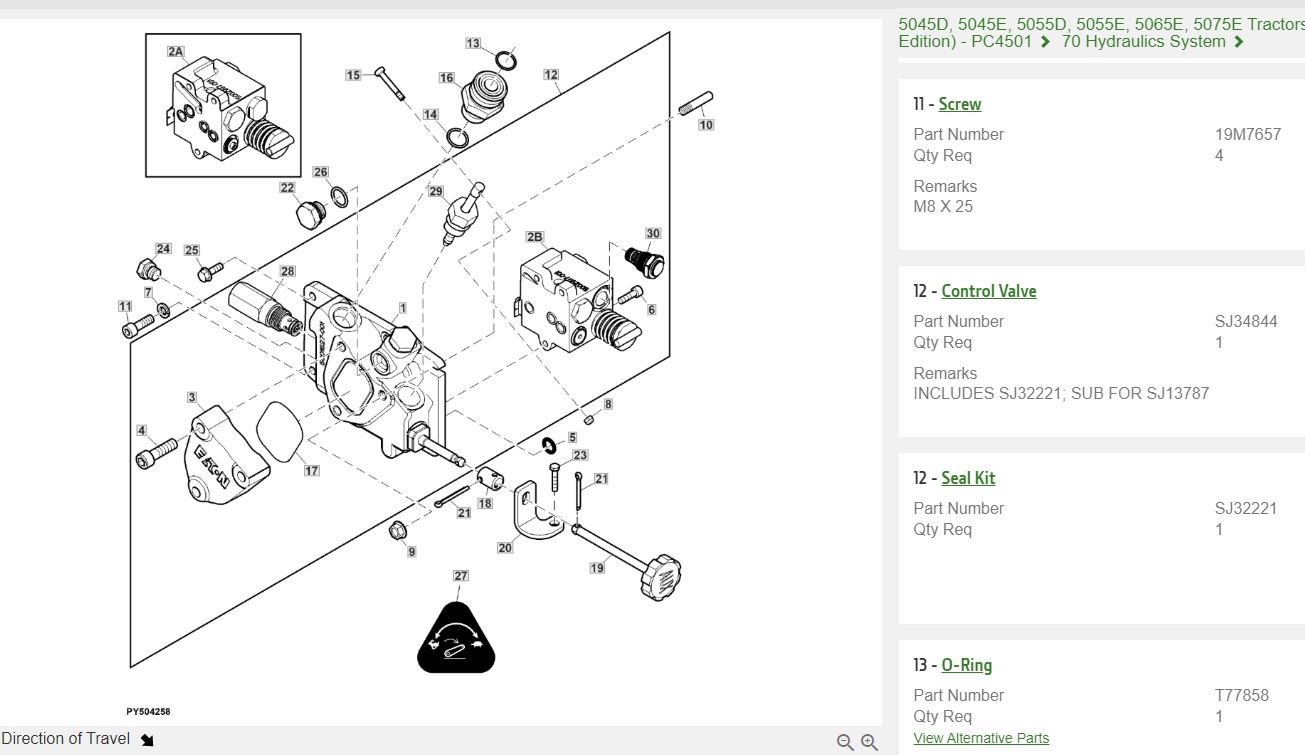

Update: the new screen is in and it still does not lift the bush hog. Someone has mentioned a valve that is on the right hand side of the tractor that could be clogged. They said it is about as big as the end of your finger.. i cannot find such a valve. Any JD folks familiar with this ?
