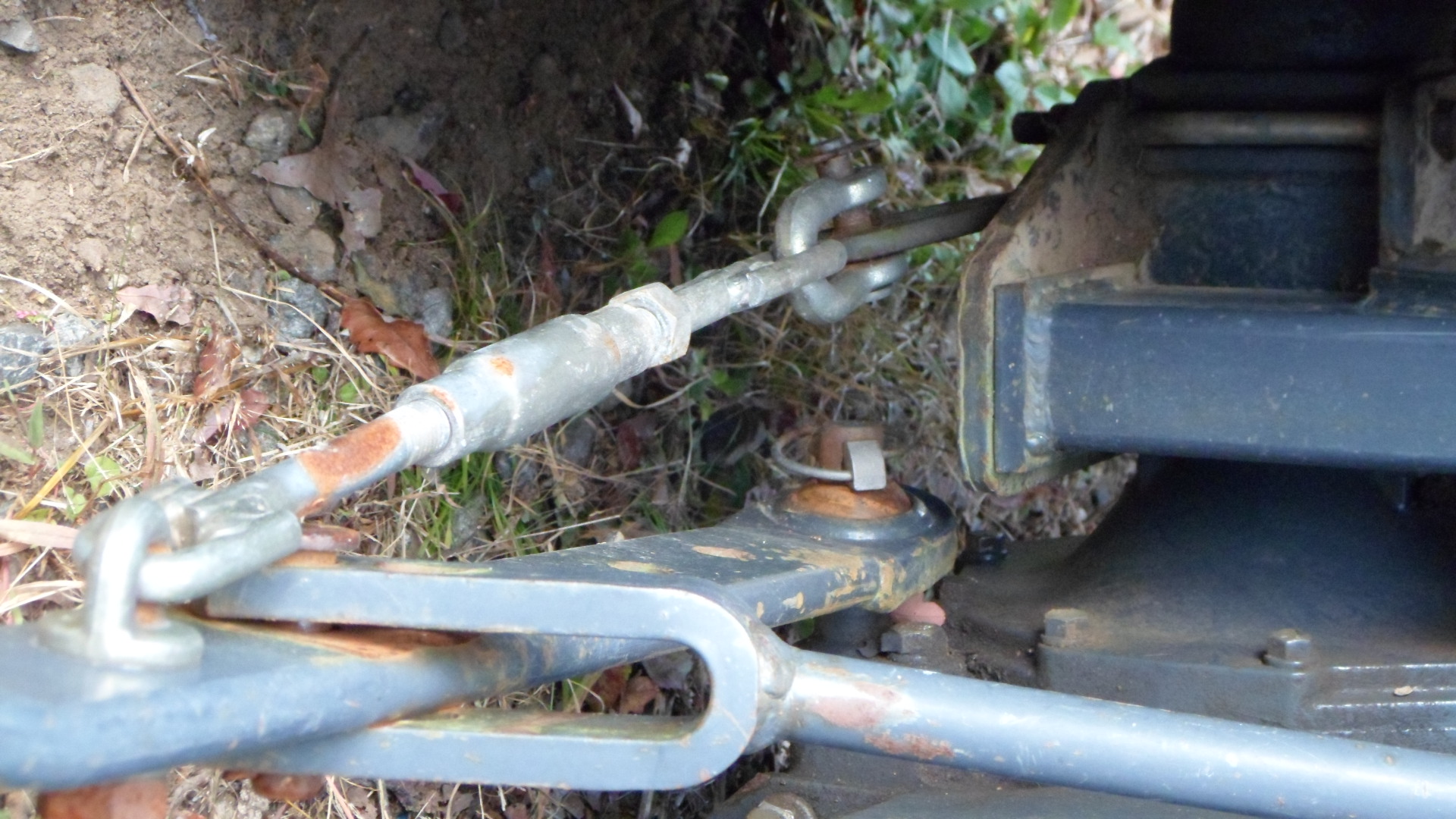

Hi - I have a T273 that's 12 or 13 years old now with some hundreds of hours on it. Somehow while running the tractor a few yards with a BB48 brush hog attached in the DOWN position in error (i.e. dragging along the ground) a bracket that is part of the tractor chassis and that receives the lower chain link sheared right off. The attached photo of the undamaged right side top left shows the bracket. Question is what's the best approach. The closest I can think of is to get it into a welding shop who could fabricate a metal piece like it and attach.??

Sorry, that was a bad description. What is shown in the picture is the 'good' side - the (left) side that isn't broken. That has a clevis pin connecting the chain to the bracket on the tractor (shown on the left of the picture)
On the broken (right hand side) which is not shown, the clevis and the bracket itself are missing and as yet can't be found - the bracket has sheared off from the tractor and taken the clevis with it for the ride, leaving just the undamaged chain hanging down.

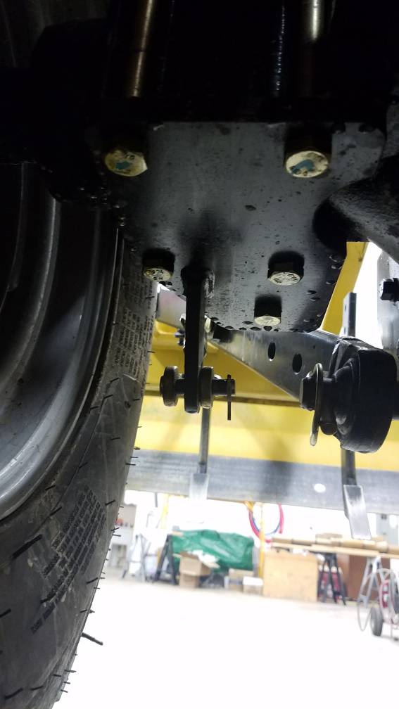

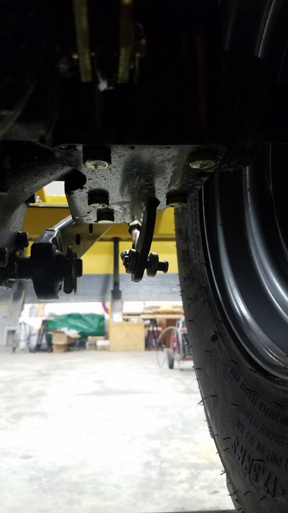

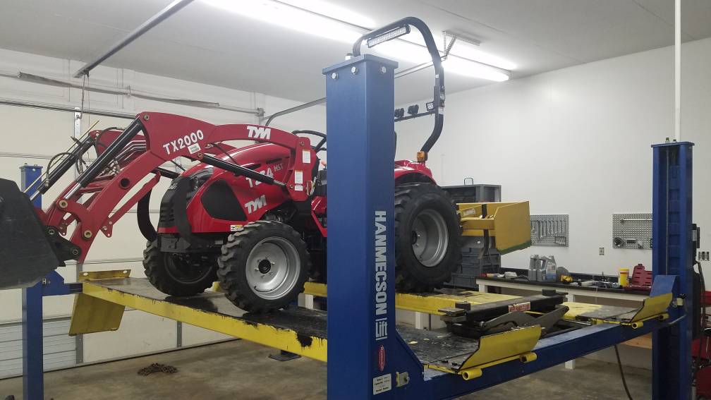

Awesome chrise. I didnt even notice until you said so. While doing some maintenance, I had the tractor up on the lift and I found that it is the lower part of the ROPS mount. I also noticed my back bolts were loose. That explains the excess vibration. Here is my bent one...I will probably let it go for now.20181023_191039.jpeg20181023_191050.jpeg20180705_163957.jpeg
