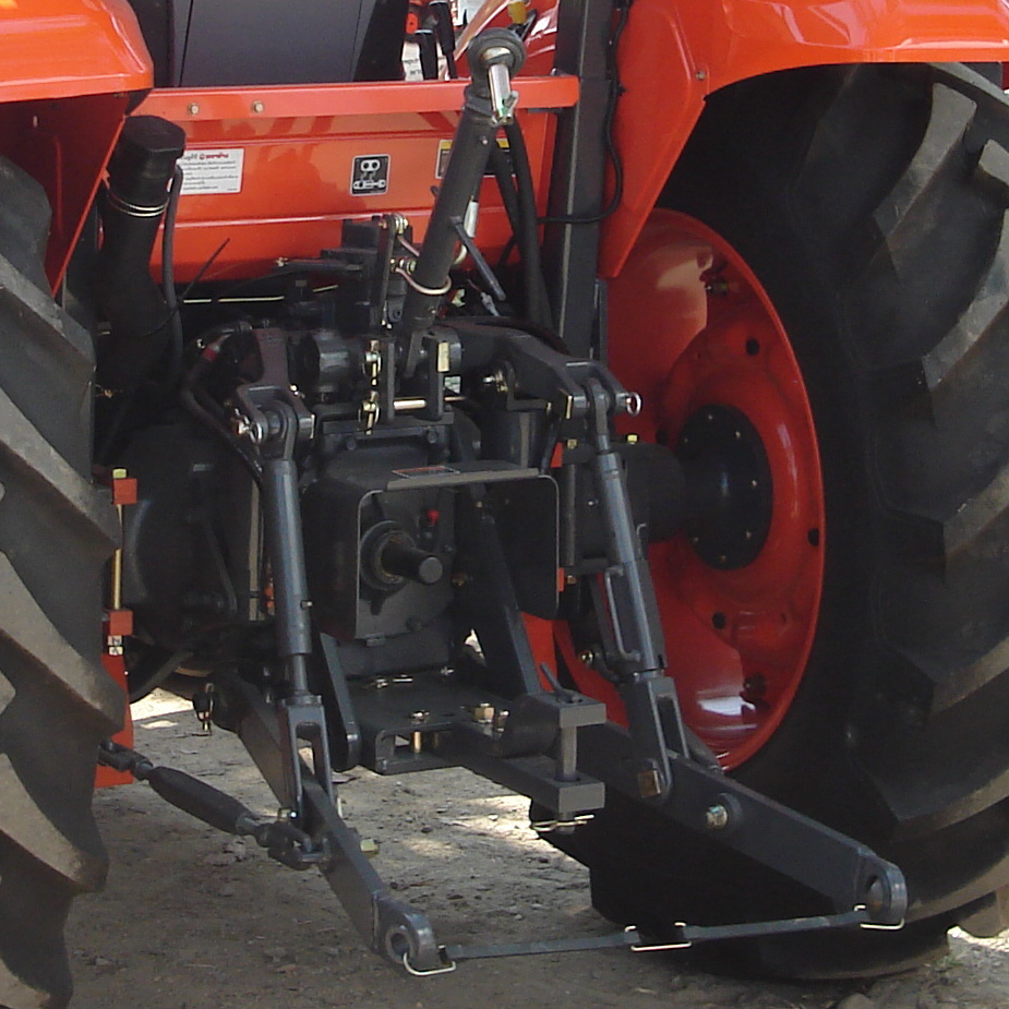

Most tractors have the connection point for the lower arms under the rear axle and the top link is at the rear of the transaxle housing which makes the top link shorter.

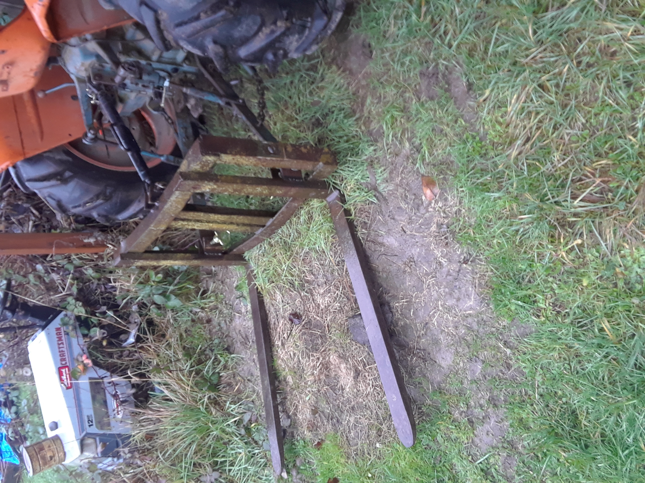

Here's some pictures, looking at it now it's obvious the geometry is bad but I didn't build it on the tractor so I could see the top link angle... I'm pretty sure a short chain in place of the top link into the lower hole should at least lift level. I've used chain for a top link on my brothers pallet forks and it worked well, lets the tips of the forks float into the pallet, and with a chain hook on the end is very adjustable but that was more usable with the long links on a Ford 4000 tractor that lift like 2' instead of 1'
And other notes, I know there's some bad practices involved on that thing... I welded the lower link brackets right to the forks with no preheating... with the compressive force of lifting and the lifting force I figured the safety factor should be fine on this little tractor, plus it's only lifting like a foot...
On this tractor the top link point is about 3" back from the front pins for the bottom links
View attachment 633544View attachment 633548
Thank you, I didn't know that. Thanks for correcting my over simplified statement . As you can see on my Kubota both connections hinge just behind the rear axle. They are both like that. It makes setting the 3 pt up easy. Just think parallelogram if you want level travel.

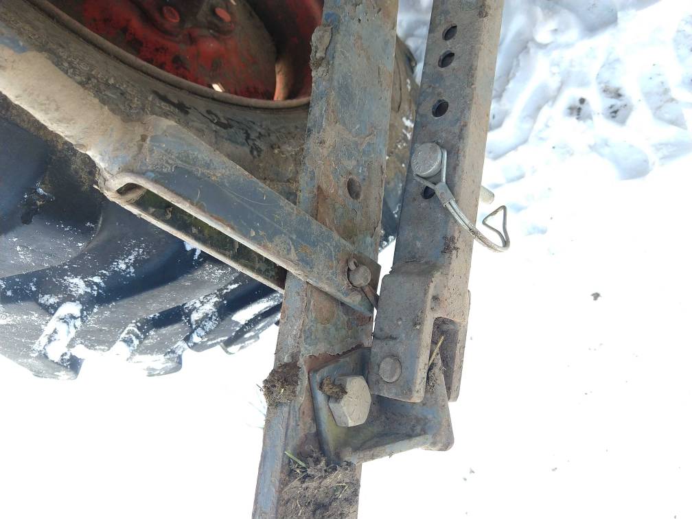

One other option, if your three-point arms have the ability you can move the attachment point from the lift rods in to the hole that is closer to the tractor. That will get you more lift height, but you will lose some lifting capacity..
In the picture above, the lifting rods are in the hole that is farther away from the tractor to get a little more power, while sacrificing lifting height.

I'm already in the inner holes, the 3 point just doesn't have much lift, although drilling another set of holes 2" in wouldn't be a horrible idea...
