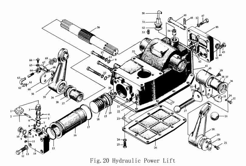

I have 23 HP Rhino, and the 3 point contol valve did not work, it had a broken shaft, so I ordered a new one from Homier at parts.farmprotractors.com. I installed it and with lever in rear position I hear the hydraulic pump cavitating, and in the forward position it lifts the bucket.
I am not sure what to check now? The hydraulic power lift is like the farmpro, and I have a drawing of it, but I do not understand how it functions?

I will check and see if there is a hex head/diverter valve on the Power lift. I attached a picture of the power lift. I did turn/tried to adjust #3, it stated somewhere that it was the lowering speed adjustment for the 3 point, but nothing happened, it just leaked hyd fluid. I will also check the hydraulic lines coming from the pump to see how they are connected, and I will report back.
The hydraulic power lift is a mystery to me, as to how it works, how does the hydraulic pressure control the piston movement... did anyone out there dissasemble one of these units?

1. Replaced new 3 point control valve (located on right side of hydraulic lift, attaches with the three bolds #57 in the picture)

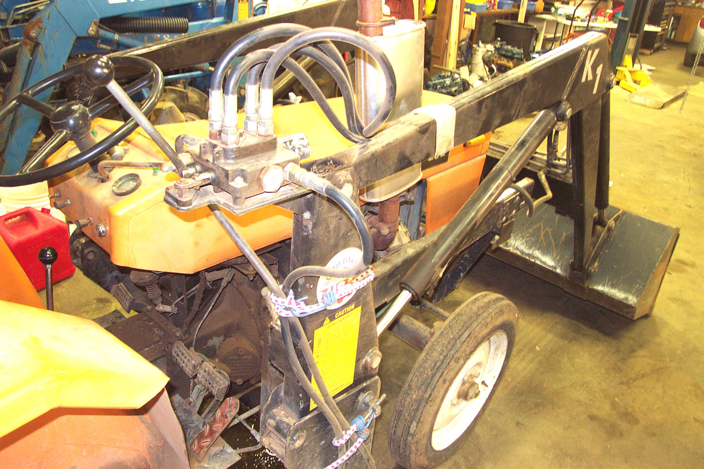

I followed the hydraulic lines and from the rear of the hydraulic pump, line goes to the IN of the Loader Valve (Cross Valve Made in USA). From the OUT of loader valve line goes to the bottom of the 3Pt Control valve. From Top Front area of the Hydraulic Power LIft a larger line goes back to the side of the hydraulic Pump.
In the picture of the power lift I noticed that item #3 has a knob on it #1, mine does not have a know, but wahat is that adjustment for? and how do you know where to adjust it to?

I can't quite picture your loader circuit in my head, as it sounds like the loader was plumbed in series with the TPH. I'd have expected a parallel circuit. Any chance you can post photos?

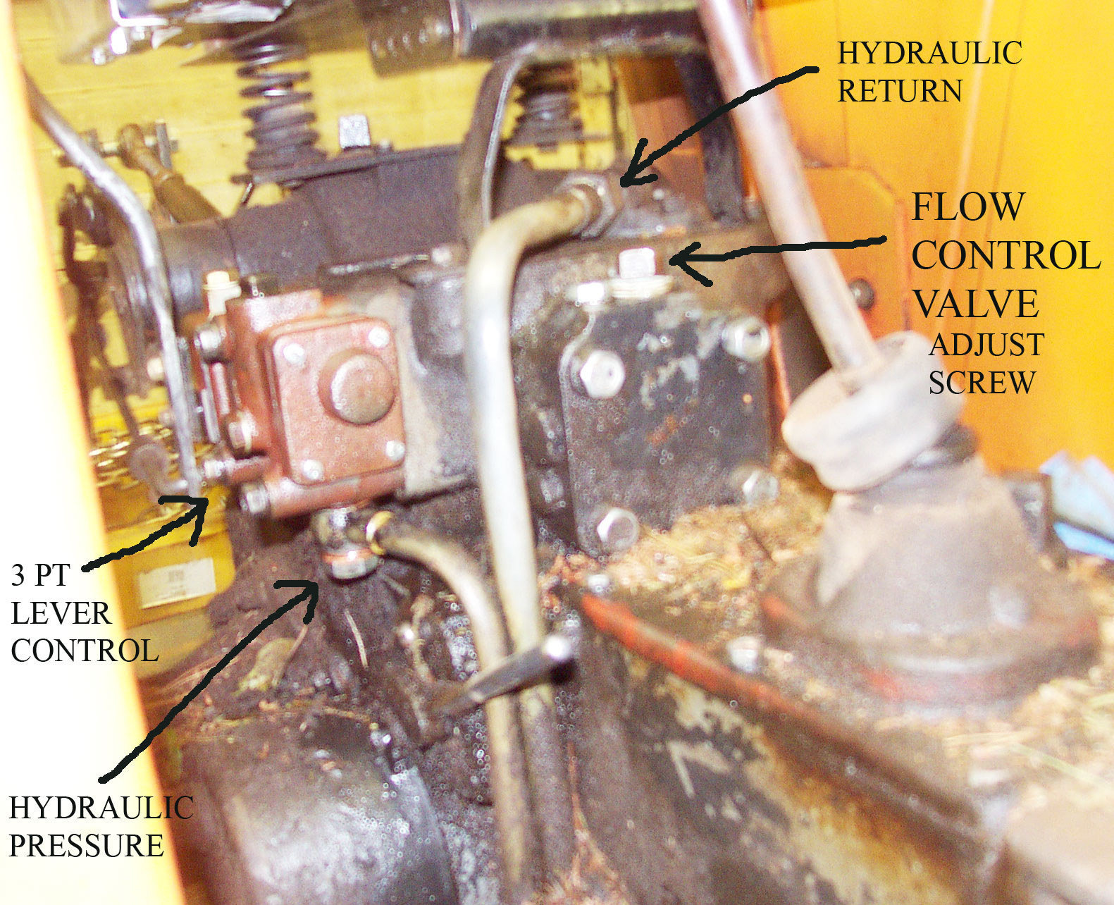

The thing without a knob is your flow control valve. It's typically used in conjunction with the three point hitch, to regulate how fast the hydraulic fluid returns to the sump. When you have no load on the lift arms, you want it wide open so the arms go down under their own weight. When an implement is mounted, you then regulate the speed at which the arms drop (it doesn't affect lift speed). In most cases - the heavier the implement, the slower you want the return flow adjusted.
If you've never used it, it may be stuck. But the valve body itself can be removed for cleaning, just be careful to first remove the set screw that's recessed into the face of the valve housing. And those - are often painted over.

OK, problem solved!!! It was the valve #3 (without knob) that was screwed all the way down, because that is when it did not leak hydraulic fluid around it, but it stopped all action to the 3 point. I turnded it all the way counterclockwise but it did not come out, so I could inspect it. So I screwed it back in about half way down, and 3 point works good, up and down by using the lever. It still leaked hydraulic fluid so I wrapped the threads with teflon tape to stop the leak. Thanks for all the suggestions, now I can get to work boxscraping and brushhoging.

I was able to take some photos of the hydraulic system, so here they are. Again that flow control valve adjusting screw was screwed in down all the way clockwise, which kept the 3 point from working, now it is at about mid way up between fully closed, and fully open.
