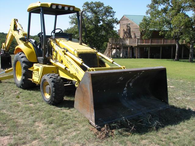

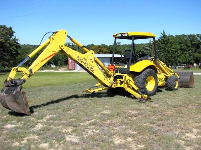

My LB75.B New Holland is over 17k lb and has 4WD. I run up and down gullies, in loose sand, dig with the 1.3 yd FEL bucket, and back up inclines with a full FEL bucket. If I don't have 4WD engaged, I know it instantly. I absolutely LOVE my 4WD backhoe.:D
I have a three position switch for 2WD-4WD-4 wheel braking. When in the 4 wheel braking position only 2WD is engaged, but if I'm driving down the road and hit the brakes, 4WD is automatically engaged to aid braking. Otherwise, the tractor is roaded in 2WD to reduce wear and heat buildup.
My LB75.B is a 2005 model that I bought with almost 3700 hours. I paid $21.5k for it, but for that price everything was fixed that needed work. To me, it is worth the money to own a machine that starts instantly and works perfectly everytime I use it: no leaks, no downtime, no worries. It's an awesome workhorse.:thumbsup:
